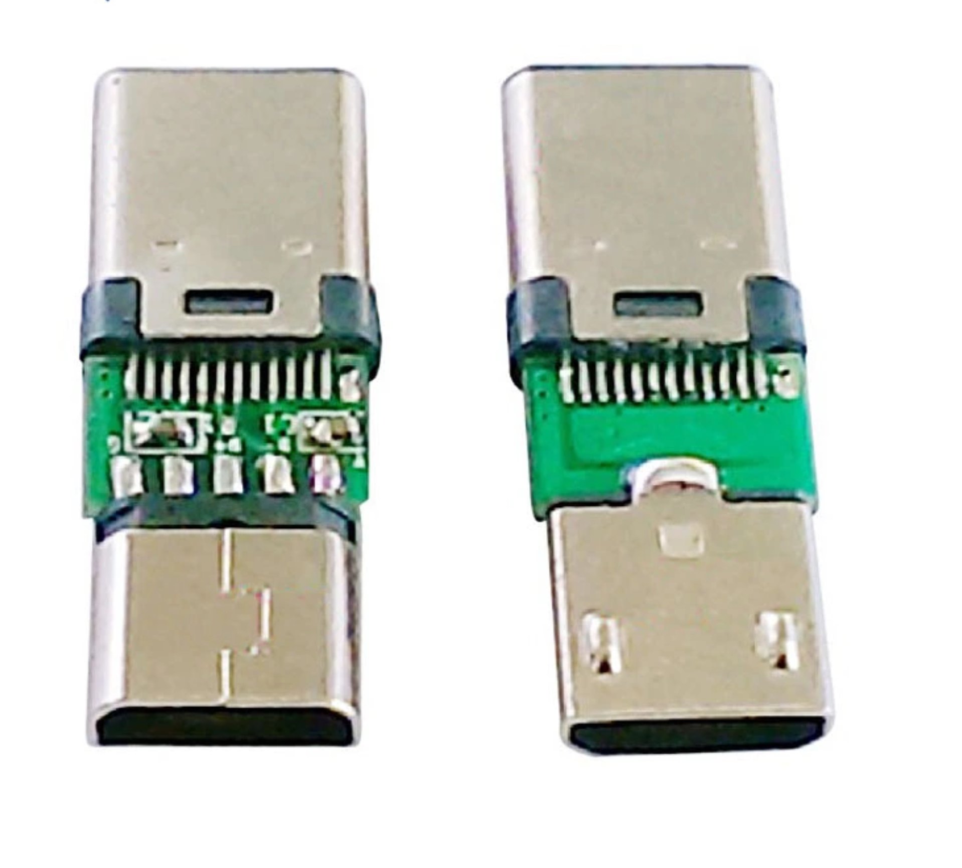

just gets these and make your own to the length you wish, you can get the type c male with a shell also just like the micro usb one.
10pcs-lot-Micro-USB-5-Pin-Male-Plug-Welded-Type-USB-Tail-Charging-Socket-for-Android.jpg_640x640.jpg
l made my own micro usb male to type-c male adapter for the trinket dongle.
Reactions: wicksand420
I don't see the resistor so I take it the cable I got will be good to go. Can't remeber but I think the resistor is for charging and the trinket won't be charging anything.
