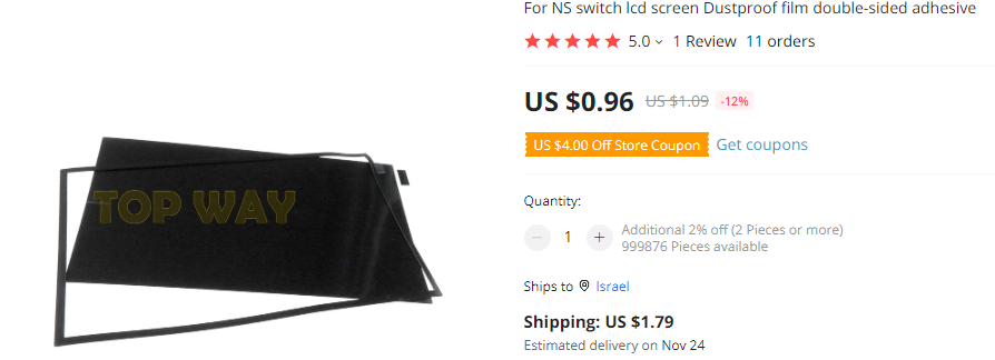

Im not exactly sure what it is that needs the adhesive, is it the lcd to the actual base(plastic) of the switch?
is this what im looking for?: it says LCD screen so im not sure.

Yes, that’s it. You just need a thin strip of adhesive around the edge of the Switch’s frame/shell where it touches the back of the screen. If you’ll be waiting on the screen to ship anyway, I guess buying a $1.00 piece of tape won’t hurt anything in the overall scheme of things. :-)

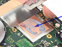

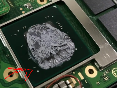

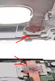

In regards to the thermal paste, I see that you also replaced that and after doing a lot of research, I decided I'd change the paste at the SOC as well, many guides dont even show that but ive found some videos that show how to do it, Ifixit for instance dont show that part, here is a picture of what I mean, btw, im planing on using MX4 on all 3 places.
Here:
Here:
And here:
Any recommendations/tips for this?
Here:
Here:
And here:

There was a lot of tongue-in-cheek in my write up. The process is not that bad. The good thing is you will be practicing removal on a screen you don’t want to keep and putting a new screen in is hardly that scary. I used MX3 on all the 2 chip spots. A little dab goes a long way. Seriously. I finally used a .5mm thermal pad for the shield/heat-pipe connection because once you remove your heat shield…you’ll do it again and again and again. Replacing paste gets old.. Also that copper colored square is THIN! Go easy when wiping the old stuff off or you’ll poke a hole in it.

I won't be using pads as I'm not expecting to open the switch anytime soon after this project, and if i by any chance I do, I'll just repaste, not a big deal In the full picture.
