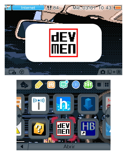

hello, after having installed the developer firmware it only came with a dev men app, my question is, did I do something wrong?

hello, after having installed the developer firmware it only came with a dev men app, my question is, did I do something wrong?View attachment 392249
Dev firmwares only come with DevMenu and Config. Just to be sure you should check in FBI if Config exists, I don't see why it wouldn't.
The TID is 000400000FF40102 (it'll be in the NAND section of the title list assuming you used SysUpdater)
If you don't have it, just install specifically that CIA from the "updates" folder.
Also if you're looking for more than just DevMenu and Config, go to my userpage from that archive and there should be another archive there for dev apps.

Don't worry, my guide is pretty safe and the worst that can happen is a softbrick. Just install some retail update CIAs and you're fixed.
