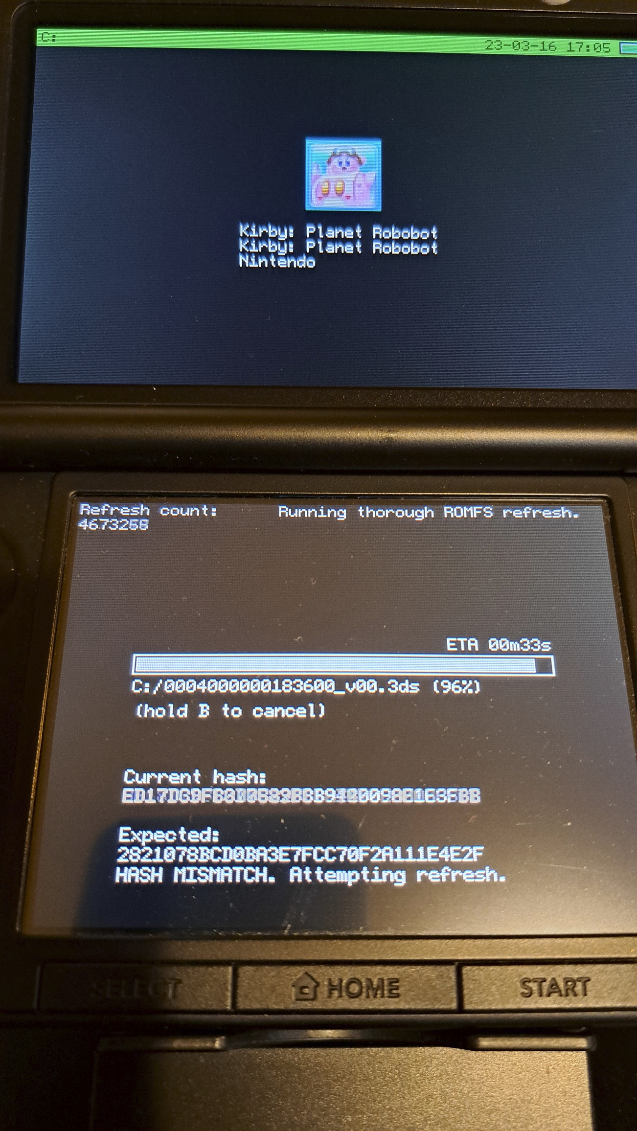

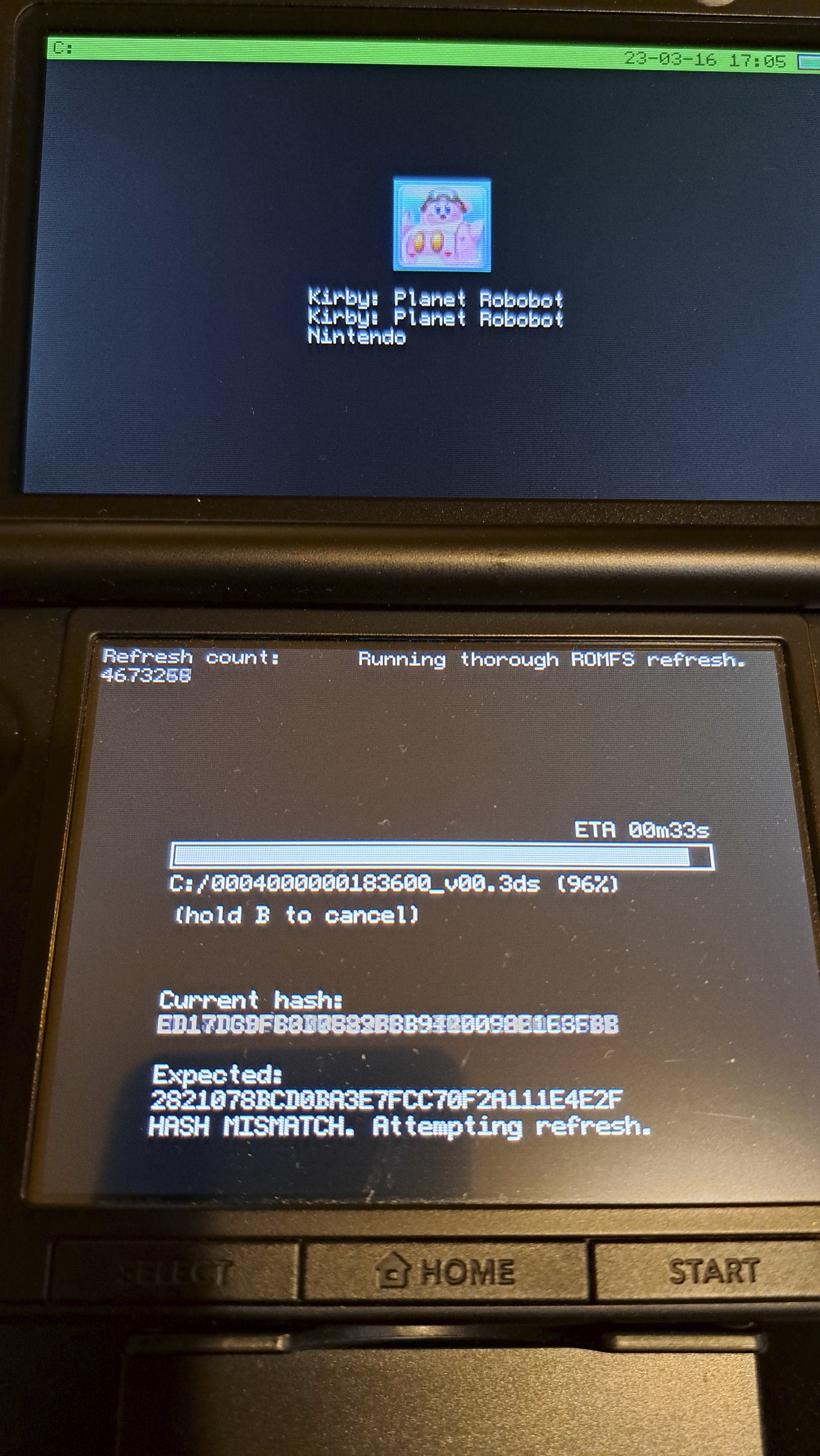

I'm trying to test all my old cartridges that I haven't touched in years and I'm curious what the "Refresh count" counter is, at first I thought it was a count of problems it found but it even goes up during the verify step and that passes fine.
Also I'm not sure I have any with any problems because when using the logging it never logs any issues. Every log is just one line telling that it is a log of the games titleid.
I would actually be interested in someone posting a full video of it running and actually finding and fixing problems so I knew what I was looking for.
Refresh count is just the amount of times it calls the refresh function; this happens normally every 10000 reads - even in regular GodMode9 or when playing the game. I just printed the amount to screen.
If the tool finds a problem it will say "Hash mismatch" at the bottom and start increasing the refresh count more rapidly (with each read):
If the verification passes fine or there are no logs, then your cartridge doesn't have any issues.
Reactions: impeeza
