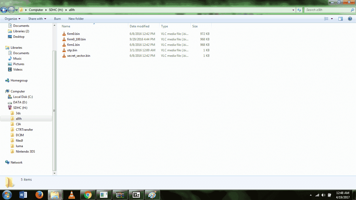

I can't go to Luma3DS configuration menu it keeps redirecting me to home menu instead.
tried booting God Mode still the same. checked arm9loaderhax.bin. HELP PLS
I have 2ds

GodMode9.bin needs to be renamed to start_GodMode9.bin. Also, your operating system might be hiding the .bin extension, so you might want to make sure your arm9loaderhax.bin isn't arm9loaderhax.bin.bin.
I ninja'd you, also, he has file extensions on
Perhaps A9LH didn't install correctly? Try turning it on without the SD card. Does it still boot? Because at this point I'm pretty sure it should just shut off if A9LH isn't installed (later in the guide you setup CTRNAND so you can boot SD-less).
yeah.. it still boot. So I should re-install just a9lh?
Yes, re-do Section II on the Installing arm9loaderhax page.
