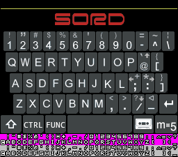

New build coming soon... I finally figured out the last of the Sord M5 gremlins. The whole Z80 CTC timer channel 3 was the problem. This thing sort of accumulates a number of different possible interrupt triggers in a cascade style. The two most important of which are the VDP (interrupting on every frame) and the Keyboard (triggering on key presses). I've got that sorted out finally - and now the last of the Sord M5 holdouts are working fine (mostly SPC games like Jumping Jack and Drops which would refuse to play previously).
To celebrate, I've got a new SORD M5 keyboard graphic ready to roll.
The Sord M5 wasn't the most popular computer - only a couple dozen games and programs created for it... but there are some must-plays if you're a fan of the 8-bit 'Coleco-style' gaming. Namely Apploon and Up Up Balloon which are favorites of mine.

  • Added Sord M5 keyboard graphic and improved Sord M5 keyboard handling.

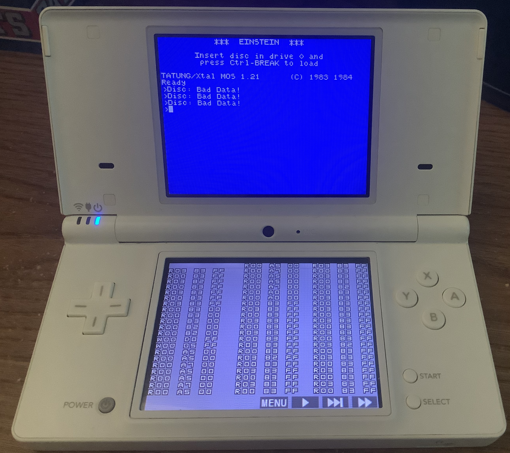

This machine has beaten me.
Three times I've tried to get the WD1770 Floppy Disk controller emulated and hooked in. Three times it's ended in virtual tears.
I hate giving up...
"He never gives up, he'll stay 'til the fight's won! Wavemotion will dare!"
Believe it or not... this is actually progress!
You don't want to know how many hours it took to get here. I'm writing my own WD1770 floppy disk controller interface for the Tatung Einstein.
Edit 8 hours later... and it works! The Tatung Einstein can go f*ck itself :)
This will only be the second emulator to run Tatung Einstein games - MAME was the only one that had support for this odd machine.

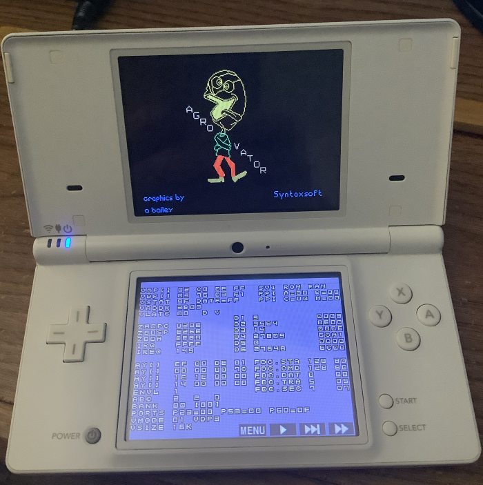

Getting close to a new release. Daily check in adds some nice touches for the Tatung Einstein. New diskette loading sounds which I love. New diskette icon with the ability to swap disks and save a diskette that has been written to.
As an aside, the only other Einstein emulator on the planet (MAME) doesn't handle WD1770 saves properly for this machine so you can't write any data. I got it working :) To my knowledge, this is the only Einstein emulator that handles disk reads and writes.

V8.6: 31-Aug-2023 by wavemotion-dave
  • Added .dsk support for Tatung Einstein games!
  • Improved Tatung Einstein keyboard and joystick handling.
  • Minor graphical tweaks and improvements as time allowed.
This is a big one!
Tatung Einstein Compatibility :​
The base 64K machine is emulated. Both .dsk files and .COM files will play. For both, you would load the file and press the START button to boot them (for .com files, it will load the file at 0x100 and auto-run... for .dsk files the START button will emulate the CTRL-BREAK needed to boot the diskette). Out in the interwebs, you will mostly only find .dsk files and the .COM files can be extracted from them. The easiest way is to use either Charlie Robson's einSDein-vitamins or EDIP to extract .COM files from disk images. Or just stick to .dsk files which are a bit more authentic to the experience of using a Tatung Einstein.
Two Tatung Einstein disk drives are supported. The default drive 0: is a standard single-sided, 40 track, 10 sector-per-track diskette with about 190K disk space available. This is the drive that will hold and load your .dsk file image when you run the emulation.
The second drive 1: is a persistent RAM Disk that can be saved back to the SD card on your DS/DSi. This comes pre-formatted (and you can re-initialize it using the DISK icon menu) with 190K of storage. To the emulator, it looks just like a standard second disk drive. You can copy often used programs and utilities to this disk - I use it to stash away a few flavors of XBAS so I've always got the right one on hand to play games.
Both drives support read/write capabilities however, the writing will NOT auto-back those changes to your SD card. I might change that behavior in the future - but for now, any changes written to the emulated disks are transient until you go into the DISK icon menu and save them back to the SD card. I'm fairly confident that the disk write works fine - but until I get more testing hours from field-use, I don't want to inadvertently screw up an original .dsk image and leave the onus on the user to save out the disk for now.
Speaking of disk images, there are several places to find them... but I would recommend seeking out the 'Tatung Einstein Gamebase' which generally has disk images properly formatted and auto-booting for a more streamlined experience. Seek those out.
Lastly, in addition to the standard 8K einstein.rom BIOS file (required for Einstein emulation), you can optionally provide an einstein2.rom file that will load (up to 8K) into 0x4000. This is the extra ROM slot in a real Einstein and can be used to house diagnostics roms or things like flexi-dos.

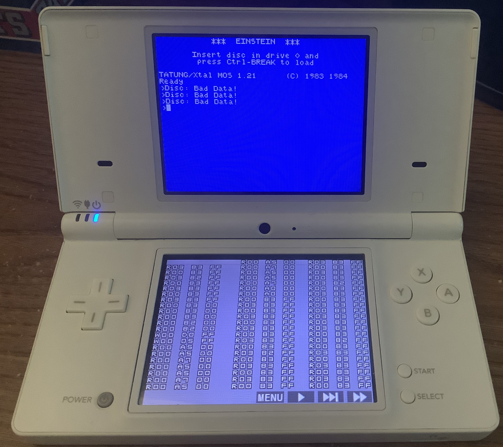

I hate giving up...
