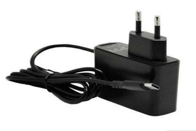

Why not grab a Samsung S8 cable (what I did) and a robust Sony wall charger with 2 usb ports on top. This charges my Switch while I'm out very fast! At home I have a Chinese branch charger that I've been using for months (very fast as well)
Actually I don't need a wall charger. Nintendo's original charger does the thing when home. I just needed a power bank and a cable that provide that insane amount of power Switch consumes (as a mobile device) I got the cable and just need a power bank because -I haven't tried yet- I think my old 5v 2a power bank will charge my Switch for ages.
