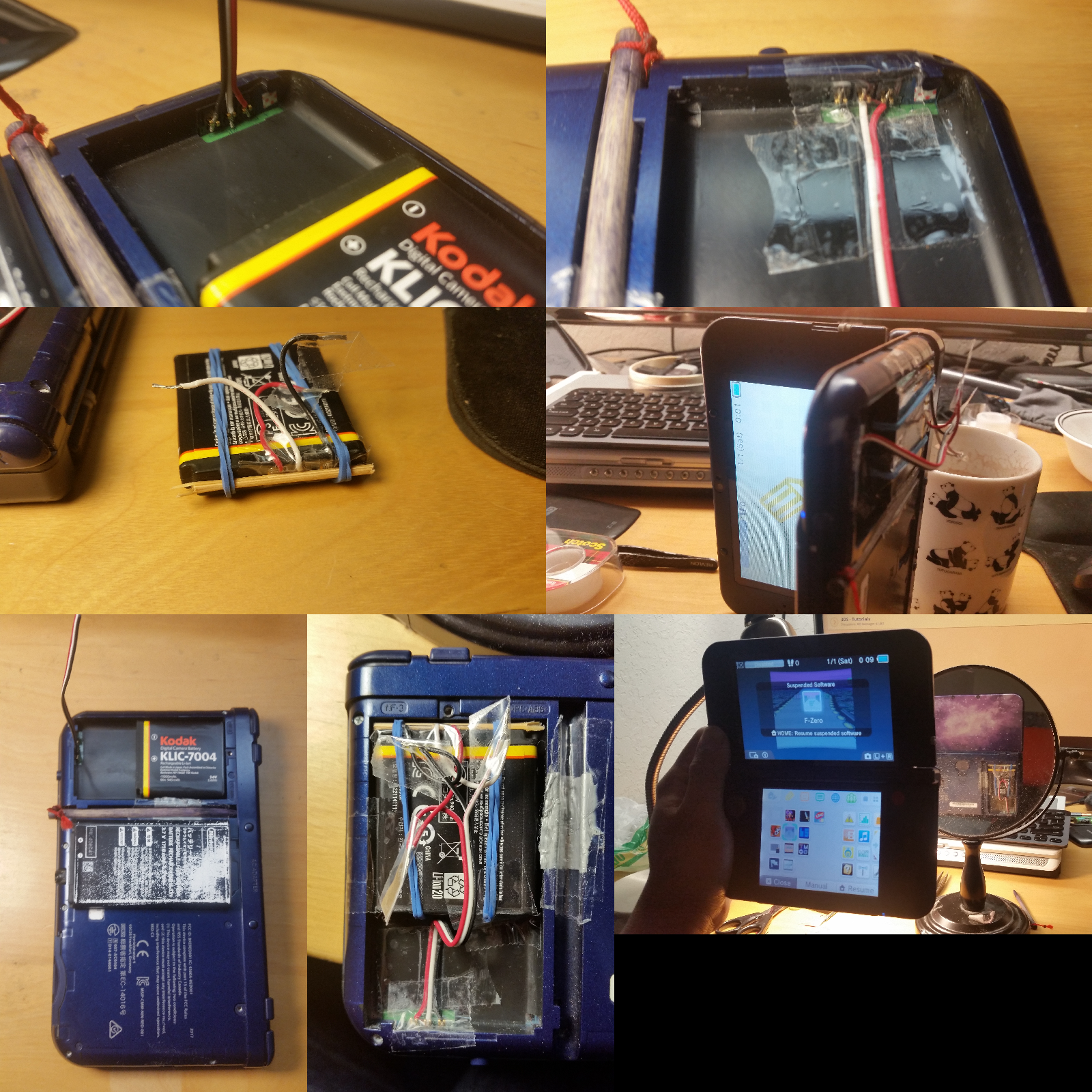

Ghetto battery mod.
  • Any small, square shaped 3.7V Li-ion rechargeable camera battery with 3 contacts [ + / - / neutral ] should work.
  • Tape is to prevent accidental shorting. Not shown is a layer put on the green PCB.
  • The Wires are in two sections. Final assembly has the individual lines twist connected one-by-one.
  • Toothpick + rubberbands to press the balled up wires on the battery contacts.
  • Cover plate doesn't fit due to bulk. This could be done cleaner where it would be possible to house everything.
  • AC charging was not tested. I'm pretty sure it'll work.

Have you tested AC charging for this mod yet? Your pictures show that retrofitting a 3.7V Li-ion battery can power the 3ds, but it's no good if it can't recharge. Does this also work for the New 3DS XL?
