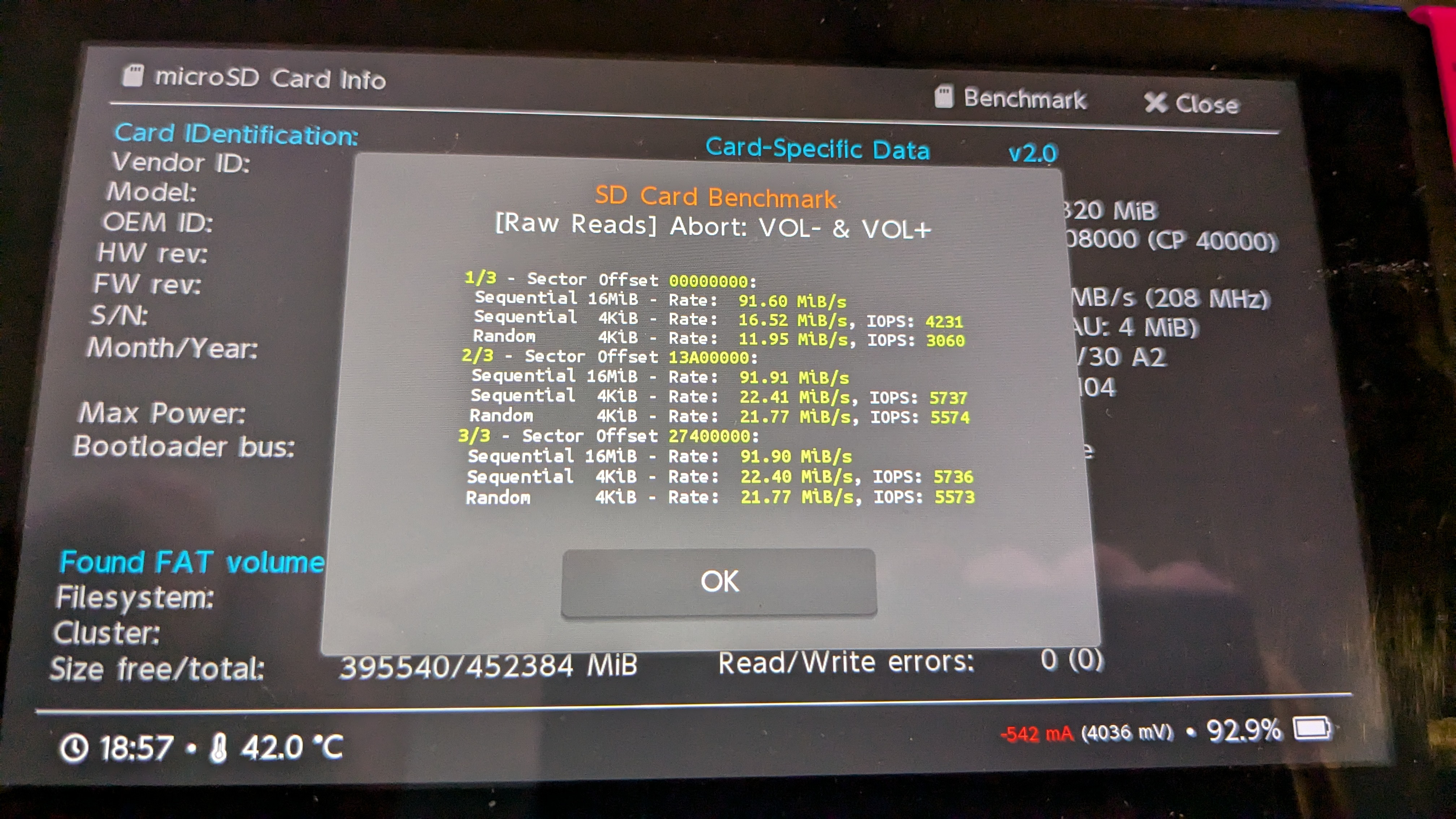

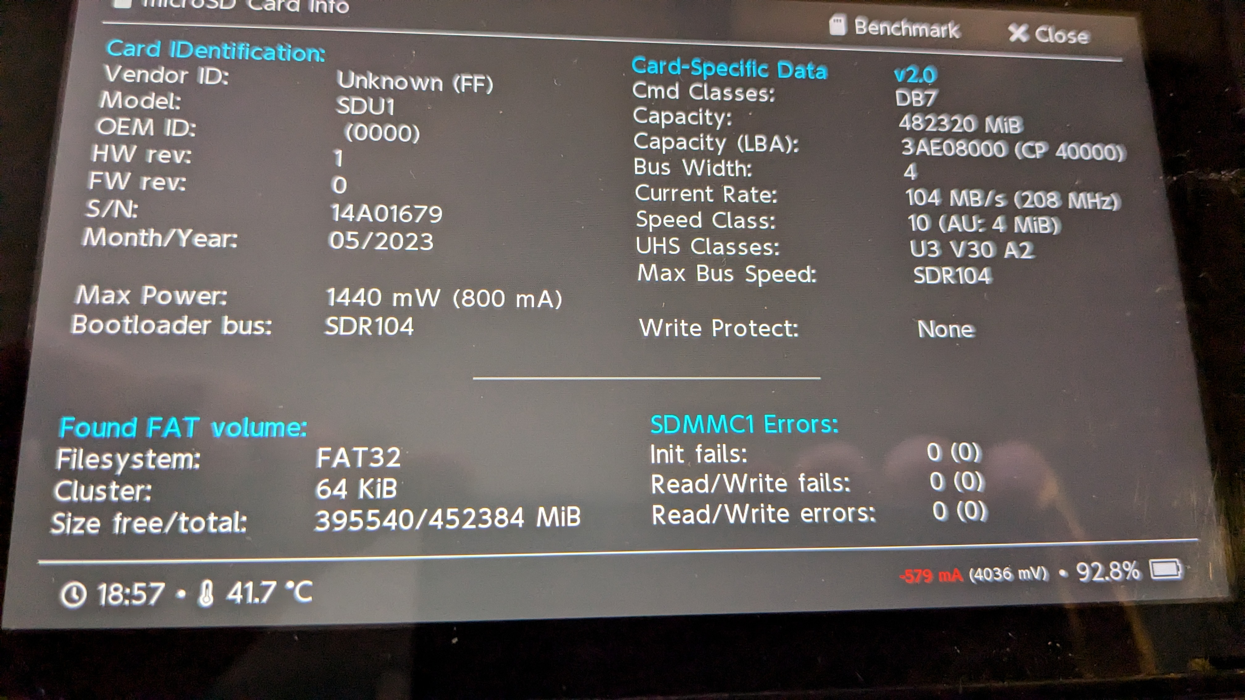

SD Card change - Tried a different card with the same build / fresh build
The SD Card is partitioned for emunand

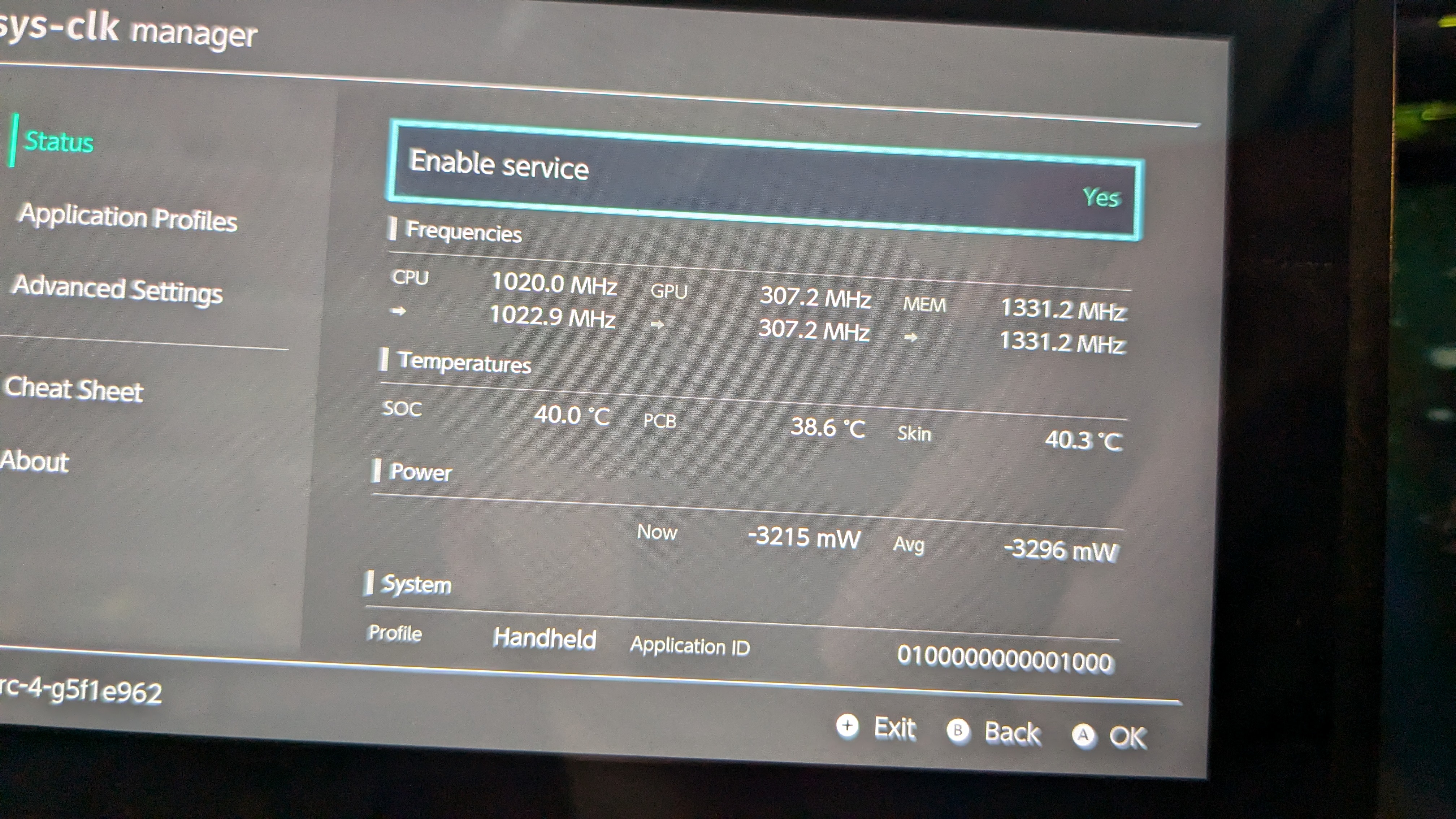

I've included a few screens, only thing i noticed when docked is higher usage on core #3

The partition - I've tried multiple SD cards with different / fresh partitions - All fat 32

It's an old thread but have you noticed your gpu is running almost half its original clock speed? Ram speed is also slower than original, default docked speed is 1020/768/1600mhz cpu/gpu/ram.
It's running handheld mode - being docked. Not sure if it's part of the issue, or op just forced it to run this way.
Installed Tesla lib and got the overlay to show frequencies. When docked Core #3 is stuck at 99% and CPU is massively underclocked at 250Mhz, the target frequency seems to be set right @1020Mhz. Handheld everything is fine and runs @1020Mhz, so the Switch can do it but it won't when docked, strange.
I noticed the power draw stat docked was -2w which should not happen unless you're doing some very high overclocks, it almost looks like the switch is not charging docked for some reason.

3)And last but equally important, go back to the previous menu, enter sys-clk, click "enable," then go to "Edit app profile" and activate the maximum capacity in all options.
It should look something like this --->
CPU 1785Mhz
GPU 921Mhz
Memory 1600Mhz
4)Once configured, close the Ultrahand menu and connect the console to the dock. If you've done everything correctly, voila! It should work at normal speed.
FINALLY: I hope this tutorial helps you It was really hard to figure out everything in this tutorial, but thank you so much for reading, and I hope you have g
reat gaming sessions.
BYEEEEE :3
