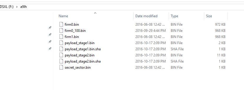

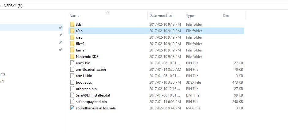

Show us a screenshot of the contents of the root of your SD card, along with the contents of the a9lh folder.
Here you go ....
