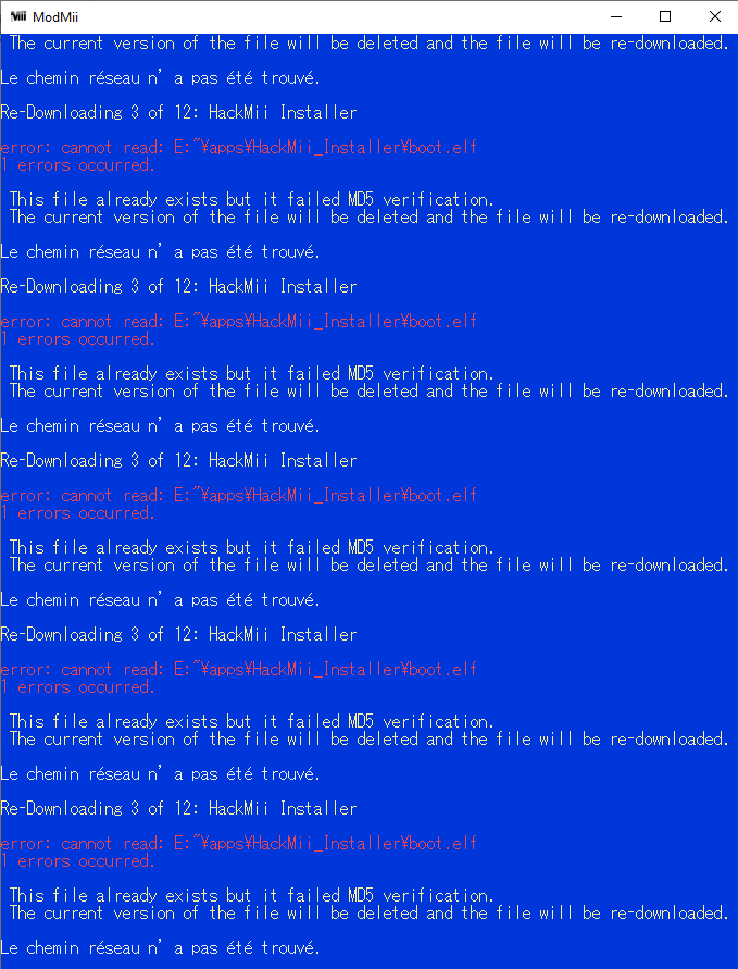

Hello, today is was trying to install homebrew on my Wii ; this is a old Wii that was sold used.
It is in version 4.3E, I have done all the update and I formatted it.
But when I launch the program with letterbomb it write me this error :
I've followed this guide :
After that I tried to change wad and ios without sucess either.
Please what I need to do for make it work ? I have never touched this wii before but It seems that the previous owner did
Ok I was able to find, I just had to install it in a folder on my desktop and not directly on the sd card, but now I have an other problem.
When I launch the program with letterbomb on my Wii my Wiimote instant disconnect and I can't reconnect it, someone have a solution please ?
Help please
Help please

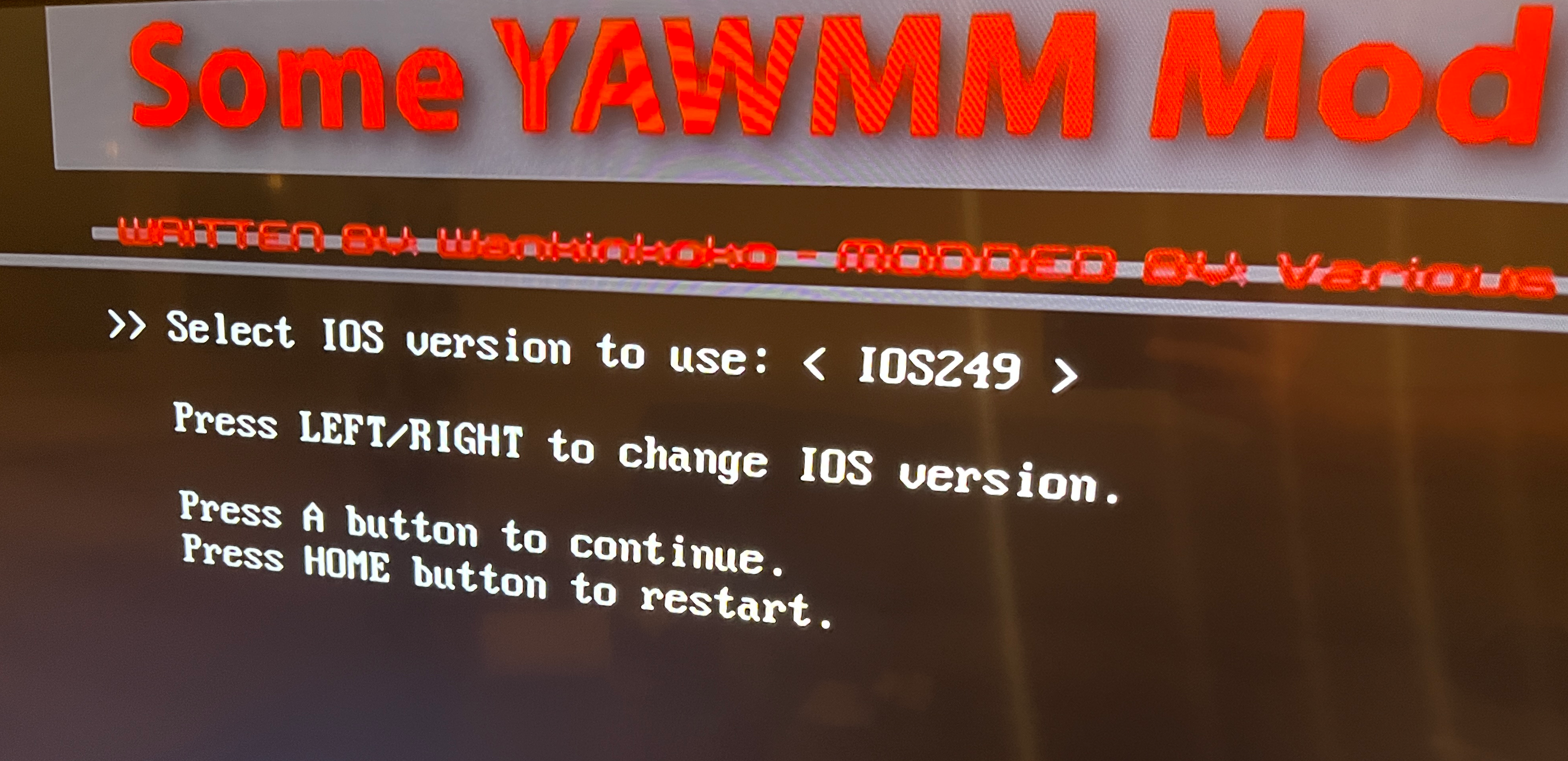

You can replace the Hackmii installer boot.dol with YAWMM's boot.dol and use letterbomb to boot into YAWMM and installed the clean IOSes downloaded from Modmii
Already done with this method, it give me this :
My Wiimote don't have the motion plus
Thanks for all your answer I will try with YAWMM boot.dol
Use Modmii's hackmii solutions wizard. The avoid the known bug depicted above, use modmii classic instead of modmii skin. Or if u really prefer modmii skin, just use the default sd card directory setting instead of the root of a device.
U should be able to select any ios in yawmm to install ios58

I tried today with Modmii's hackmii solutions wizard, and this give me the same first error
I see that you are trying to copy to the SD card when using ModMii. The best thing as others as said is to start new so that it is consistent and others can help.
1. Do the ModMii "H" option to create the files and the guide, choosing to install to "COPY_TO_SD"
2. Format a SD card to FAT32 and then copy everything in the folder "COPY_TO_SD" to SD card. To reduce potential issue with SD compatibility, try to use card size of 2GB, avoid SDHC.
3. Folow the instructions in the "ModMii_HackMii_Solutions_Guide.html" in the "COPY_TO_SD"
Report back what you encounter, then others can help.
Cheers!
