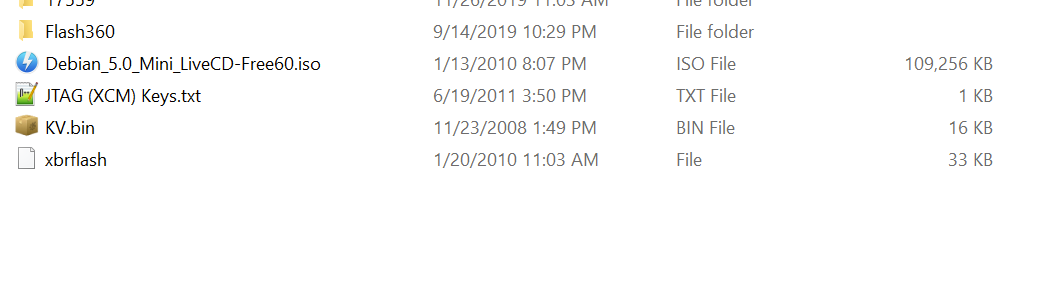

I don't remember the instructions as it's been 10 years or so, but I once had a bad flash somehow, and I was able to fix it with the debian disc. I think it makes a wireless link between the system and the pc. all you need is to be able to boot into xell. can't say it will work, and I can't find a tutorial for it, but I have the live cd on my computer.
well i have a modified version of xell so probably wouldnt work?
nm, I think it's for xbr, which is much earlier firmware, plus I think you still need to open the system. I couldn't remember.

btw, I'm not sure if you'd need the launch.ini, but you can boot into the official dash with dashlaunch (sfc:dash.xex) by hold the right bumper when booting up or when selecting "guide home." if it still doesn't work, the debian disc may be your last hope outside of sending it to someone to fix.

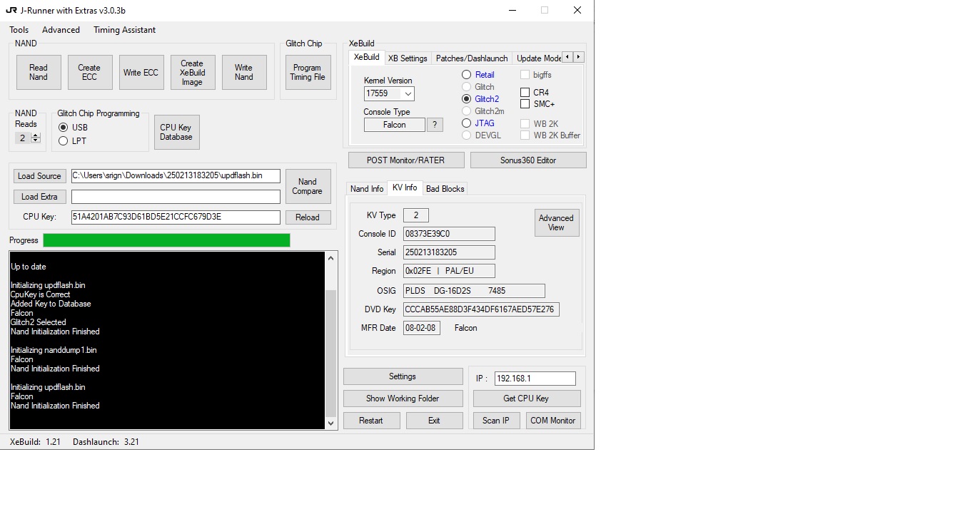

So i fixed my Xbox by sending a updxell.bin file via a tftp. I wired my Xbox to my computer directly and use a static ip and it sent it to the modified XeLL version and got me the "normal" XeLL reloaded menu. After that i used a xenon.elf of a nand flashing program that i cannot remember the name of and used a nand dump that i modified using J-Runner to get my Dashboard back. Hope this help anyone who gets the same problem in the future!
( auto-dumper ) <---- Added this so hopefully someone looking to get rid of the modified XeLL version can find this post and maybe contact me.

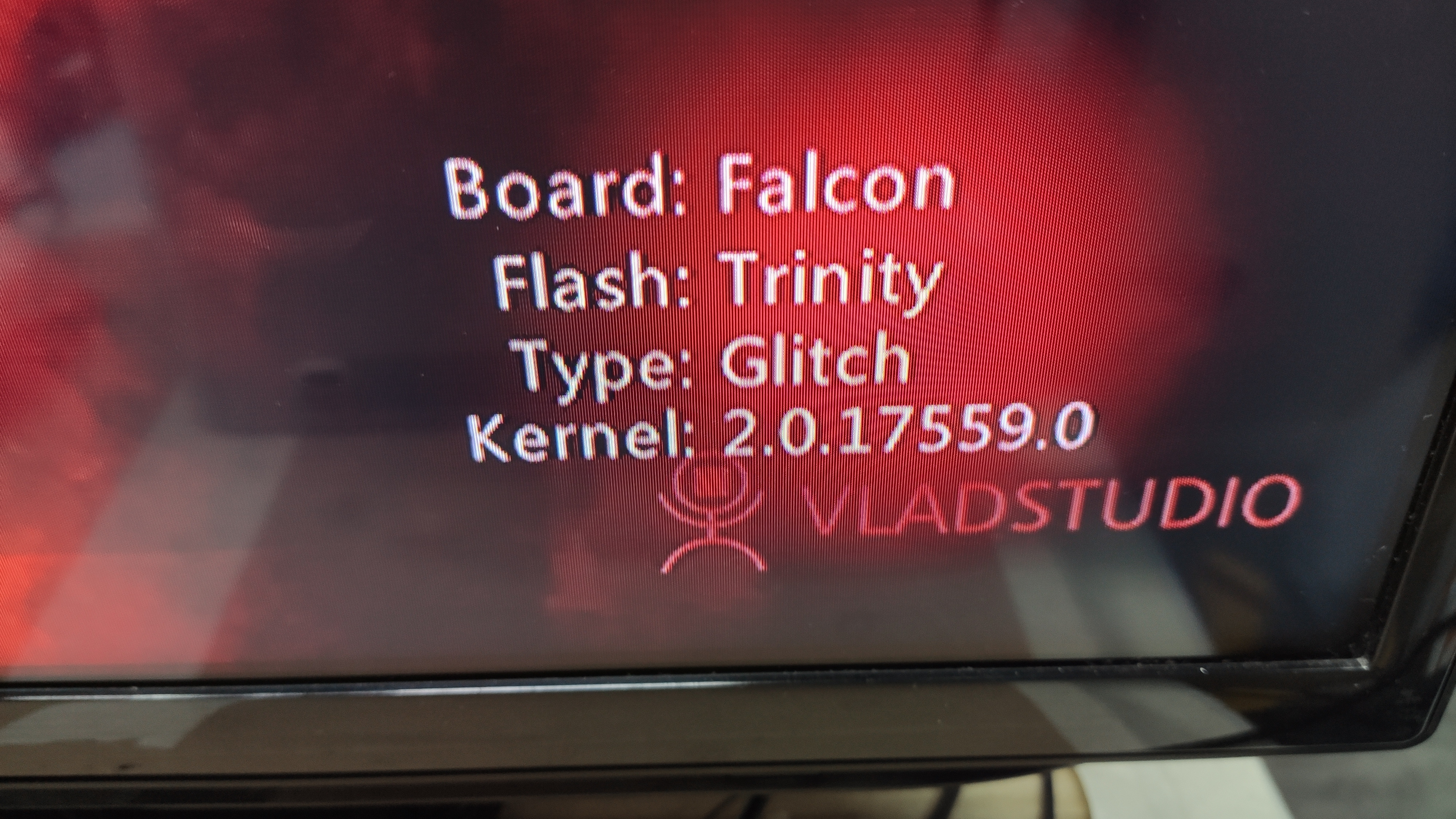

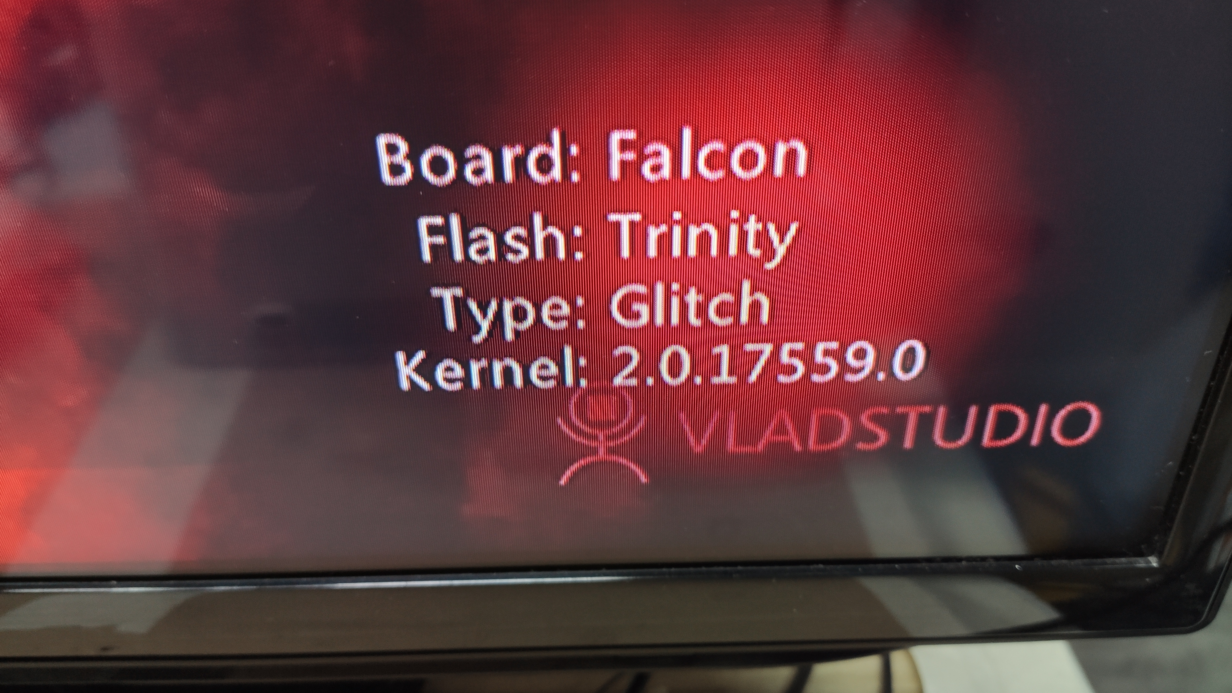

Hi! I have this problem a dashlaunch 3.21 when it shows me information at the bottom of the screen, I don´t know if this has happened to someone else too, but the board and the flash aren´t the same.
I did RGH 3.0 and the motherboard is a Falcon, I´m afraid something was done wrong and one day the console doesn´t boot.
Does anyone know what it could be?
Does anyone know what it could be?View attachment 290282
dump the flash, it will tell you what it reads as.
Ok here it is, it says it is a Falcon, but dashlaunch says Trinty in flash info
