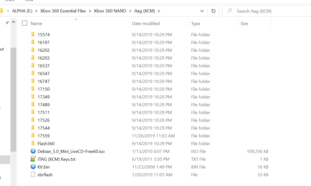

you're on late enough dash kernel to where playing games shouldn't be any issue. that kernel may only be a tos as with the kernel above it. looks like there's only a few dash kernels in between that and the latest:
not a big deal. the last good dash kernel was 16xxx, since it unlocked 2TB external hdd. mostly good for dlc, which I think can't be done with an rgh otherwise afaik. xbla can be and possibly xblig, but not dlc. if you want to install the hacked compatibility files, you need to unlock hddx first. that's the xbox partition. they won't transfer otherwise even if it says it's okay.
there's an option for that in fsd and aurora, to unlock access to hddx. then, all you do is copy and paste the compatibility files. that's all there is to it. the newest allow the guide to work in xbox mode as well, so if that works, you know it's working.

I don't remember the instructions as it's been 10 years or so, but I once had a bad flash somehow, and I was able to fix it with the debian disc. I think it makes a wireless link between the system and the pc. all you need is to be able to boot into xell. can't say it will work, and I can't find a tutorial for it, but I have the live cd on my computer.
