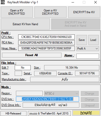

Try dumping the kv from the nand dump. Then use kv modder to check DVD key. It can be encrypted or decrypted, just need cpu key.
Well, it shows this:
The DVD drive info, serial number and manufacturing date is weird, but definitely the DVD key is not the one XeBuild is displaying.
