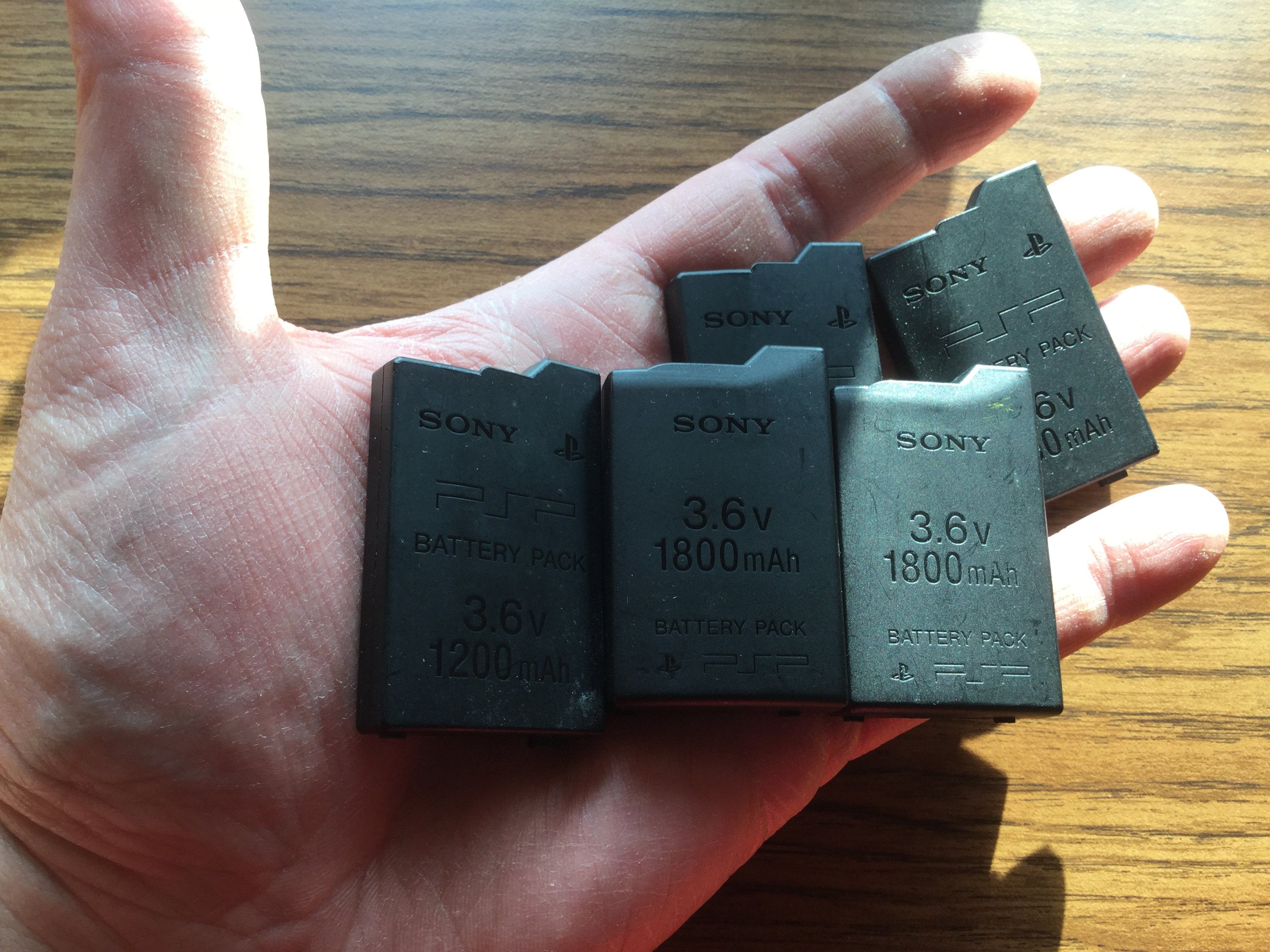

Always good to keep a spare handy....

Yeah, I've been accumulating stuff for decades. Comes in handy. You know the 'merchant' in RE4? That's real life. ;)

I've got all sorts of stuff, including units in need of repair. I'll go through a box or two and get back with you...

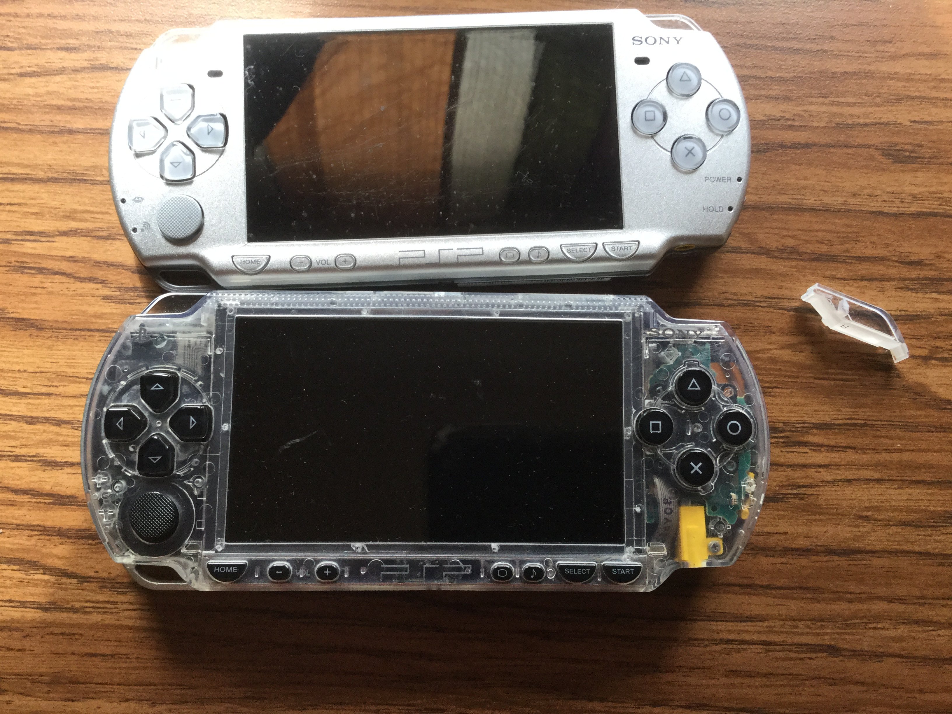

@Old where did you get that clear shell
I got it from a very well known online store in China. (Not gonna name the place just in case, might be a violation of house rules.)
A friend had convinced me that "Yes, the shell swap process is so easy that even I could do it with my limited tech skills".....well, guess what? Didn't work out so well, sigh.
This is why I'm a drummer and not a guitarist. HULK SMASH!!
