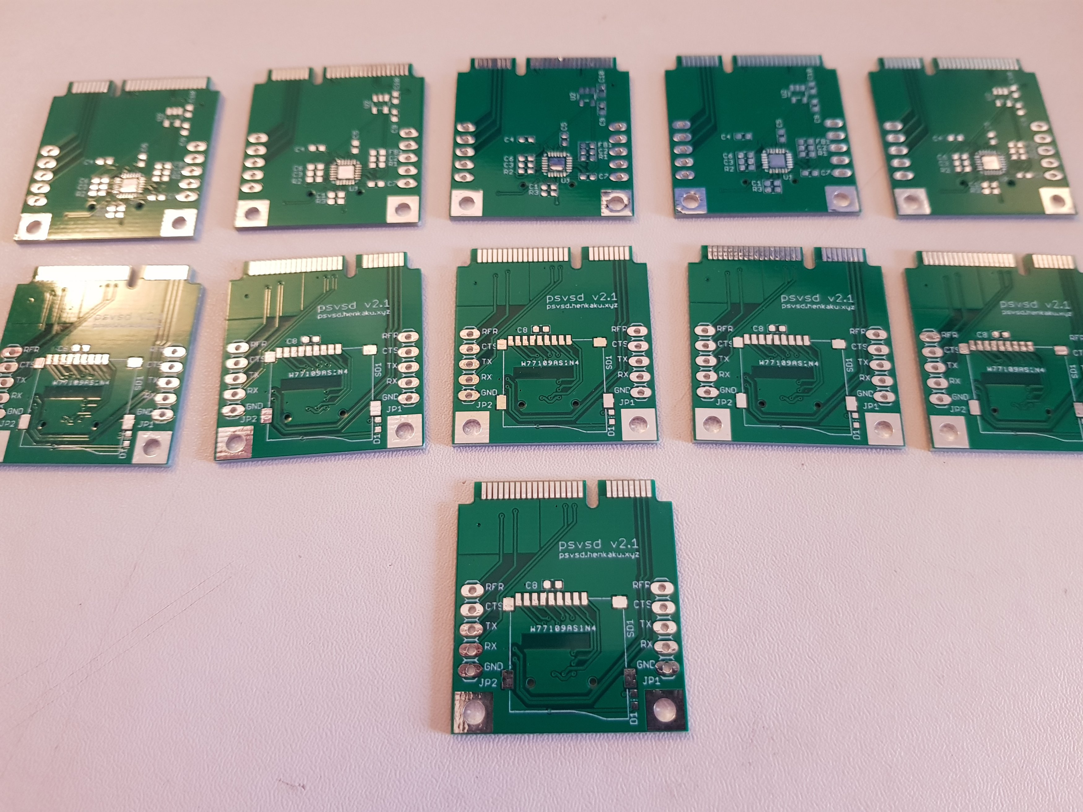

Figured it would be more fun to build my own PSVSD rather than buy and ship one from the US (I'm in the UK).
As the minimum order for PCBs is 5, and you can get 10 for the same price I now have 10 boards.
Assuming they work one all soldered up I guess I will stick the remaining 9 (or maybe 8... best to keep a spare?) on eBay for anyone wanting to avoid US shipping.

Ok, the last of the parts has finally arrived! Now just need to find some time to put them all together! 20200903_095931.jpg
