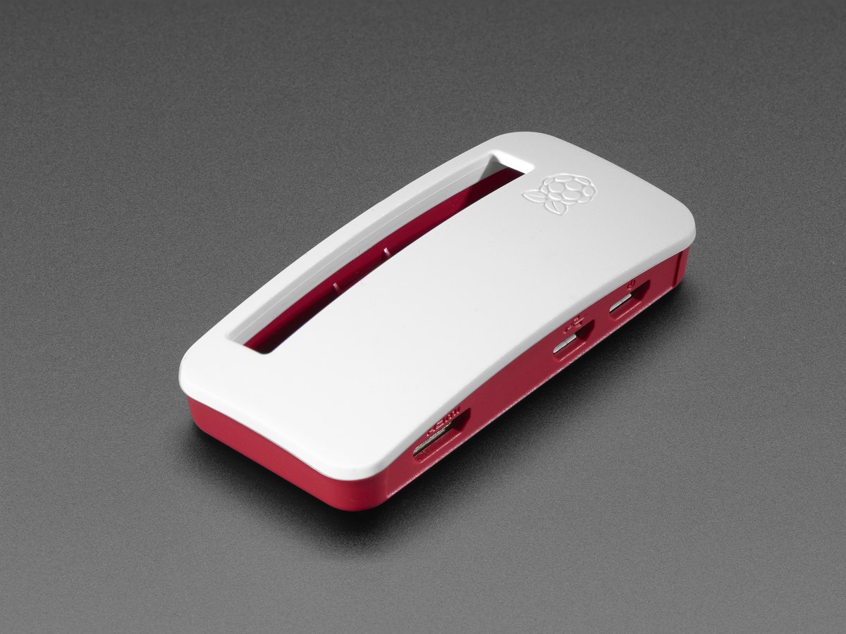

https://www.adafruit.com/product/3446
Maybe Pi Foundation Raspberry Pi Zero Case is more beautiful. but the price......
