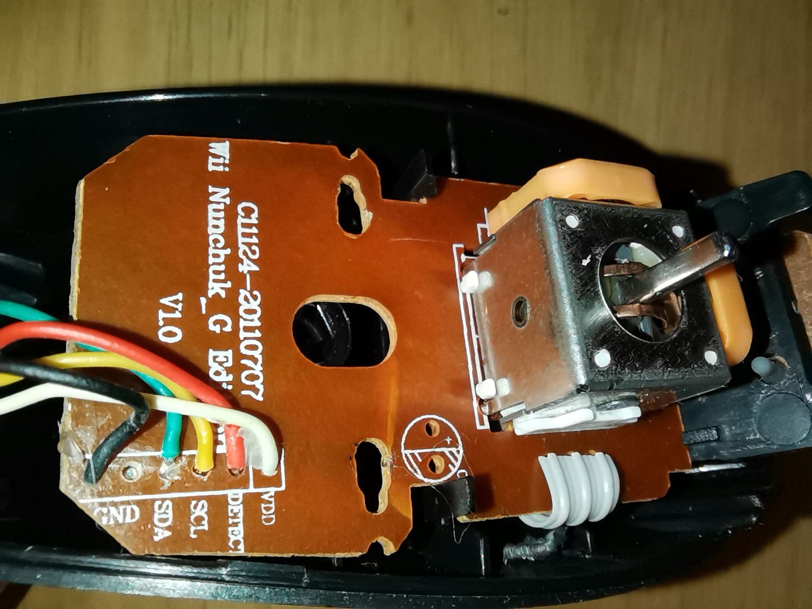

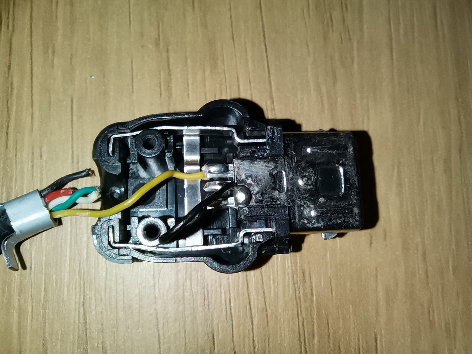

I found an unofficial nunchuck that was not working. I disassembly it and found that the wires in the connector was broken.
The wires on the board are soldered like this
I found a schematic of the nunchuck connector:
So my question is where the red cable indicated on the board as "detect" is soldered.

You have a bad pinout.
Thank you very much, I solder the wires in this order and now the nunchuck is detected but with the error:
This extensión controller is not supported. Please remove the extension controller.
Does anyone know if there is any solution?
