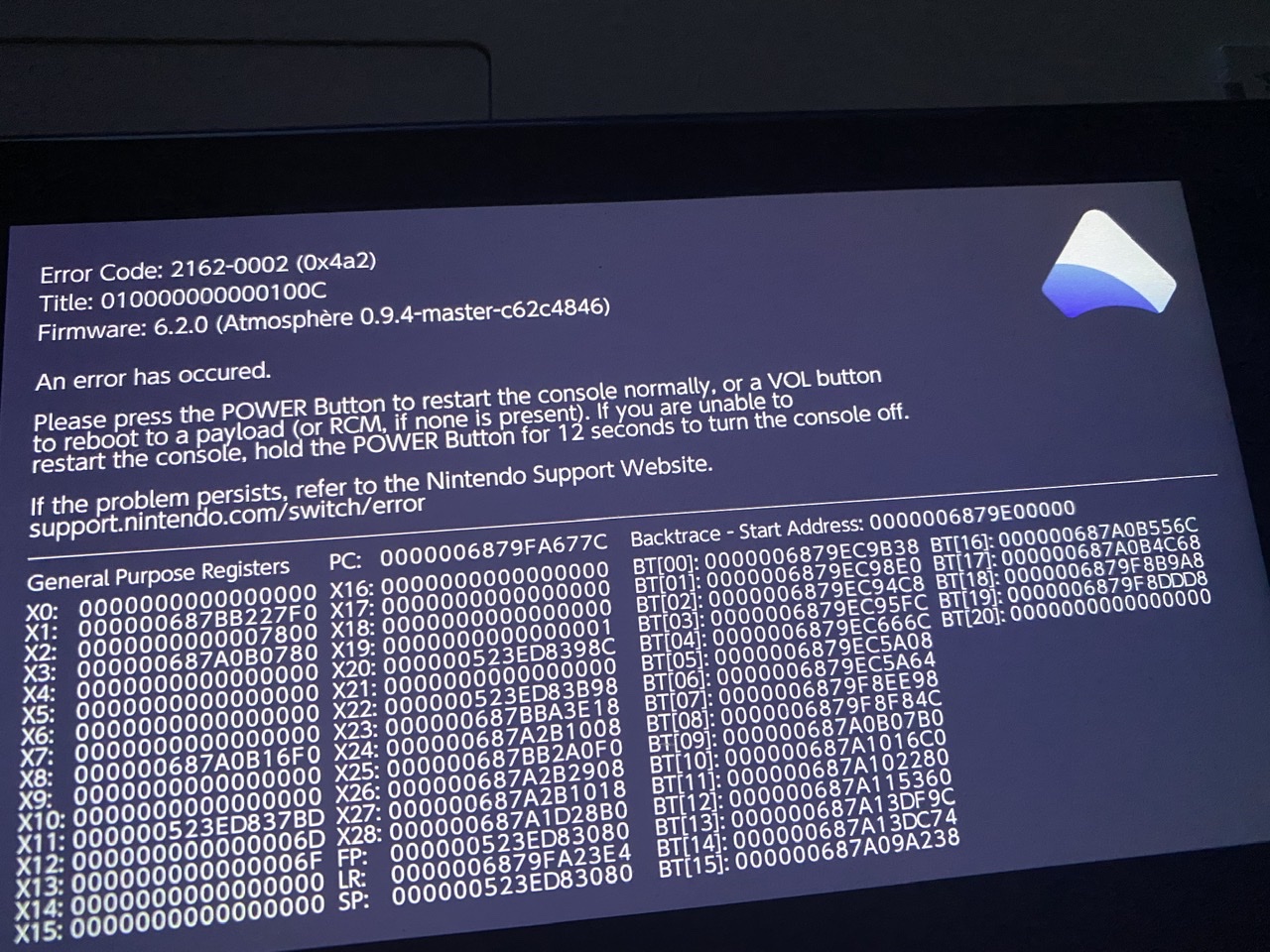

Well I followed it completely , deleted all folders, files in System and USER .
Seems I was using a corrupt Nand .
So double checked everything at every step .
All seemed to be perfect until I got to step 13 ...
Ran the UNBRICK part , screen did it’s thing .
Then I got the error in the picture .
And gives same error in normal mode .
If im honest I’ve no idea what to do next .
I’ve double and triple checked everything

Delete everything off your SD card and then put everything from the "put onto SD" folder onto your SD. Try those steps again.
Reactions: ethanhawk
Done all that , used different card , completely clean .
Deleted folders etc
same outcome .
It’s just plain weird.
I wonder if I should let battery drain completely out and try again .
Or maybe the machine is just faulty ?

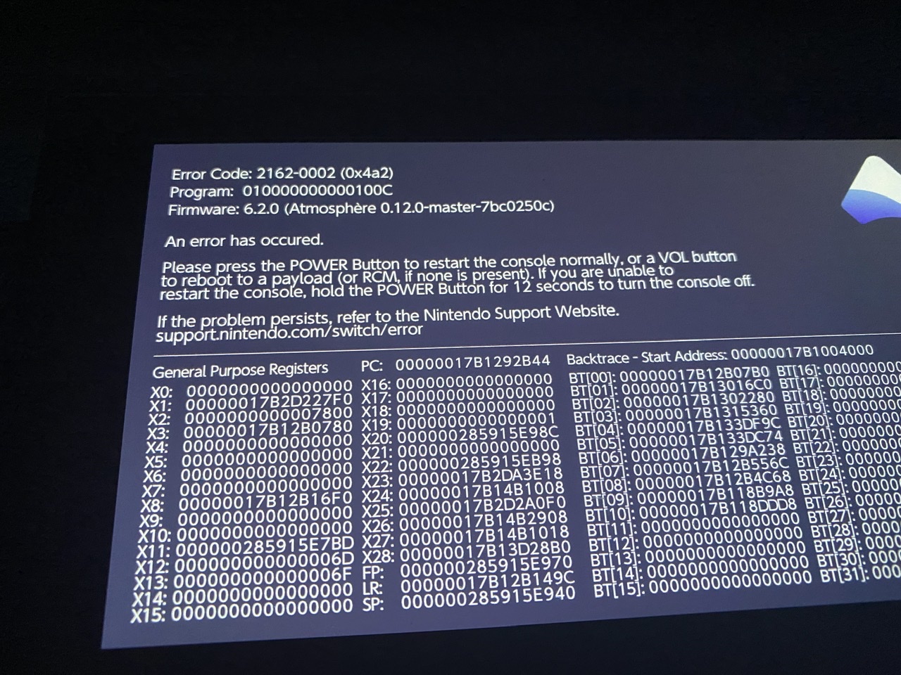

  1. Remove everything from your SD card
  2. Download the latest version of Atmosphere and extract it to your SD card
  3. Download the latest fusee-primary (next to Atmosphere)
  4. Boot the system with fusee-primary
What happens?
I downloaded latest versions and ..... does the same thing
At this point, my guess is it is a hardware issue. A quick Google search shows that some people have gotten this error when the hardware was at fault.
