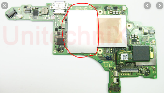

Hi,
Just want to give you an update. After messing around with everything inside I just decided to press on components after RCM was dected. I pressed my thumb firmly on this component here, I assume something important is under the shield
and it lets me inject any payload I want. I was able to inject hekate and lockpick RCM. It told me I burnt 11/64 fuses. But the only problem is my SD card isn't being detected. It's saying it's not mounted. But this is progress I guess as now I know how to inject any payload with this. But my question is how comes I don't have to press anything firmly to get biskeydump.bin to inject successfully. Like I said, I will continue with this till I hopefully find a fix. Maybe it needs like a reflow or something?

Hi,
The two 2gb LPDDR4 DRAM chips, and Tegra X1 are under that shield, the side you circled has the DRAM.
The DRAM could be messed up, would explain pkg2 and hekate not being able to run.
Here's what I also found out, I get into RCM right. Hold my thumb down on the shield. It lets me inject hekate. Now, if I want hekate to display my fuse information, etc, I have to hold my thumb on the shield. If not, it will show nothing. But when I hold it down, all the fuse information is displayed eg this one burnt 11/64
