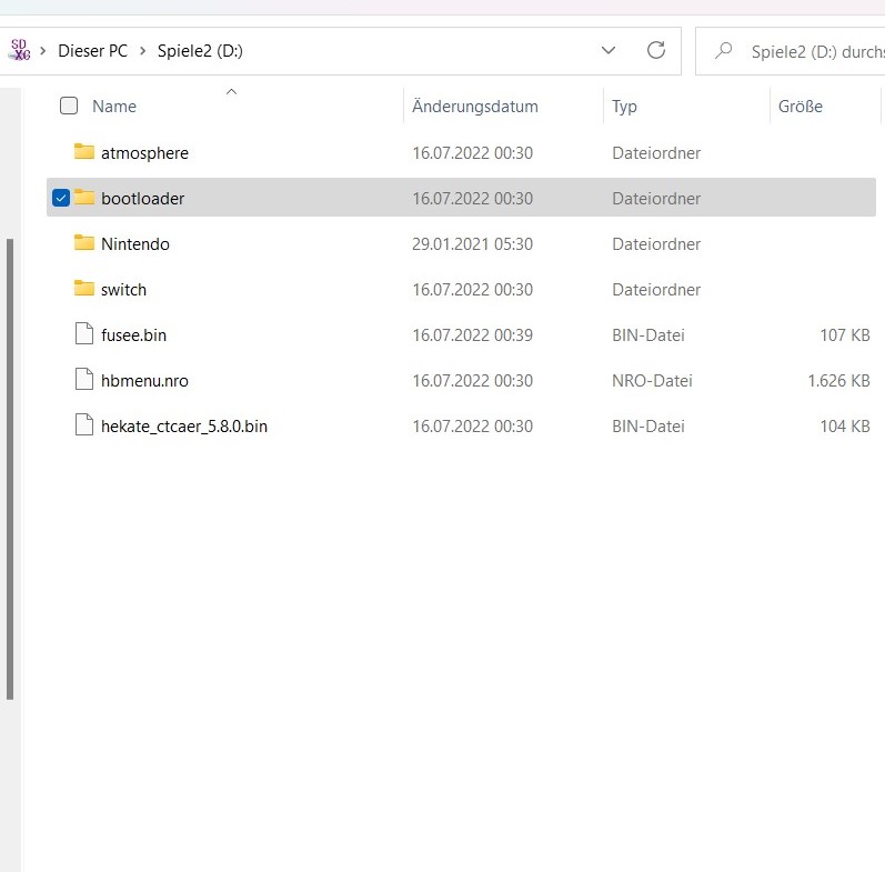

I reformatted it to exFat format after copying the data incorrectly to the new SD card was on NTFS format. Maybe my system version helps which is currently 10.1.0. Normally the RCMLoader glowed blue when I entered the menu. Now it only glows white and when I press the plus it glows red.

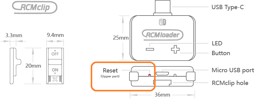

I have pressed the button under the LED with a needle unfortunately after reset it brought nothing. Normally when I press the power button and volume + button the LED is blue. Now the switch remains black.

Looks like you're not pushing the right payload.
led-png.151338
from https://gbatemp.net/threads/xkits-new-rcmloader-dongle-and-jig.525374/ (you can switch payload with + on the injector)

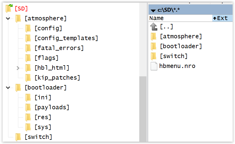

  • Copy "hekate_ctcaer_5.8.0.bin" from the Hekate zip file to d:\ATMOSPHERE_HEKATE\payload.bin NOTE THE NAME ON THE RCM SHOULD BE payload.bin (assuming your RCM Loader is presented as d:\ drive)
  • remove the RCM Loader from your computer and press the RESET button on the RCM
  • Then short press the "+" button and verify the led glows blue.
  • Press the power button of the Switch Console for 20 seconds.
  • put the RCM Loader on the USB-C port of the console, and the jig (the little red plastic) on the right joy-con rail.
  • Pres the VOL + of switch console and without release it short press the power button.
  • immediately keep pressed the VOL - of the console
  • Let us to know if the console boot Hekate.
