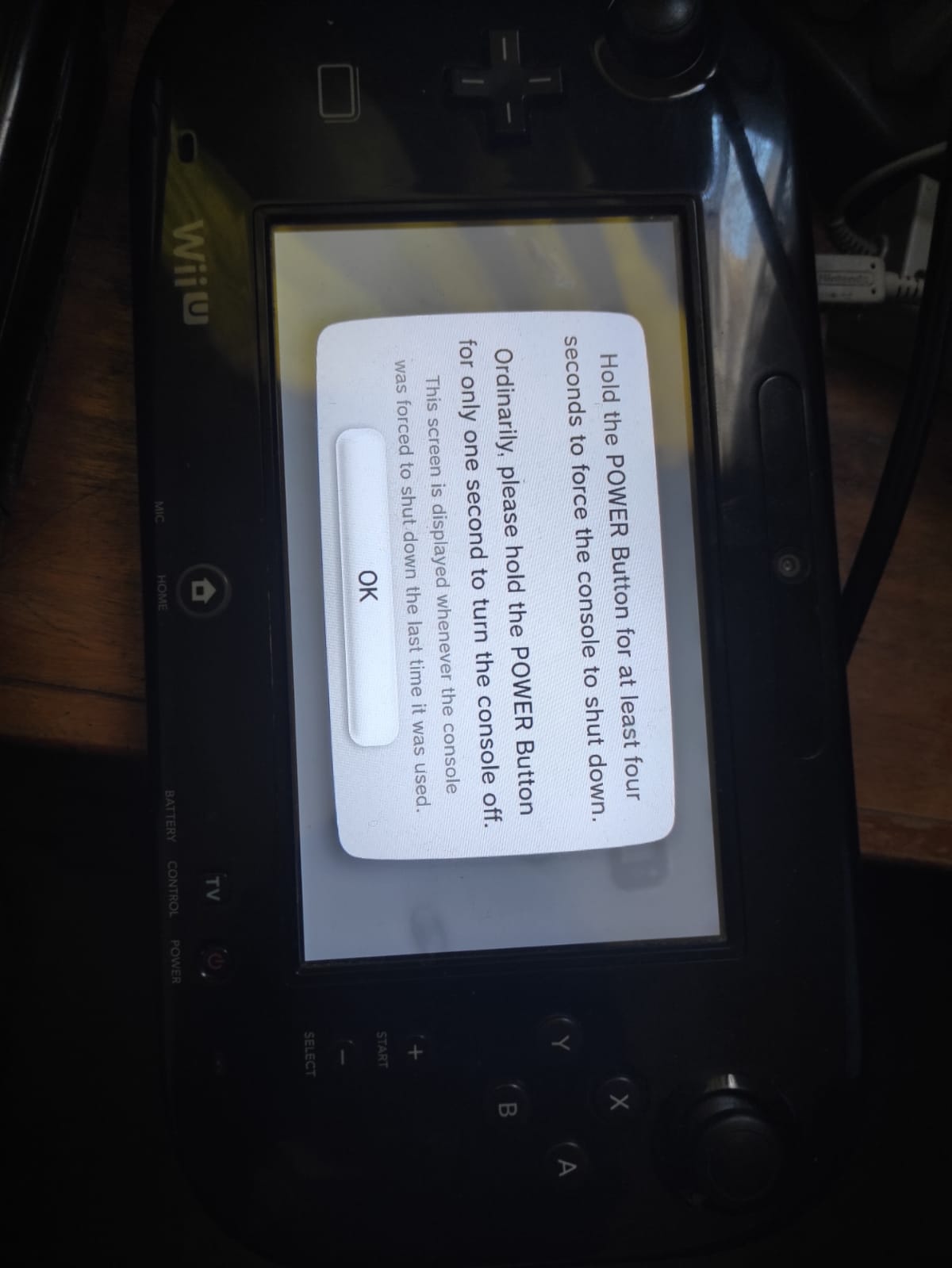

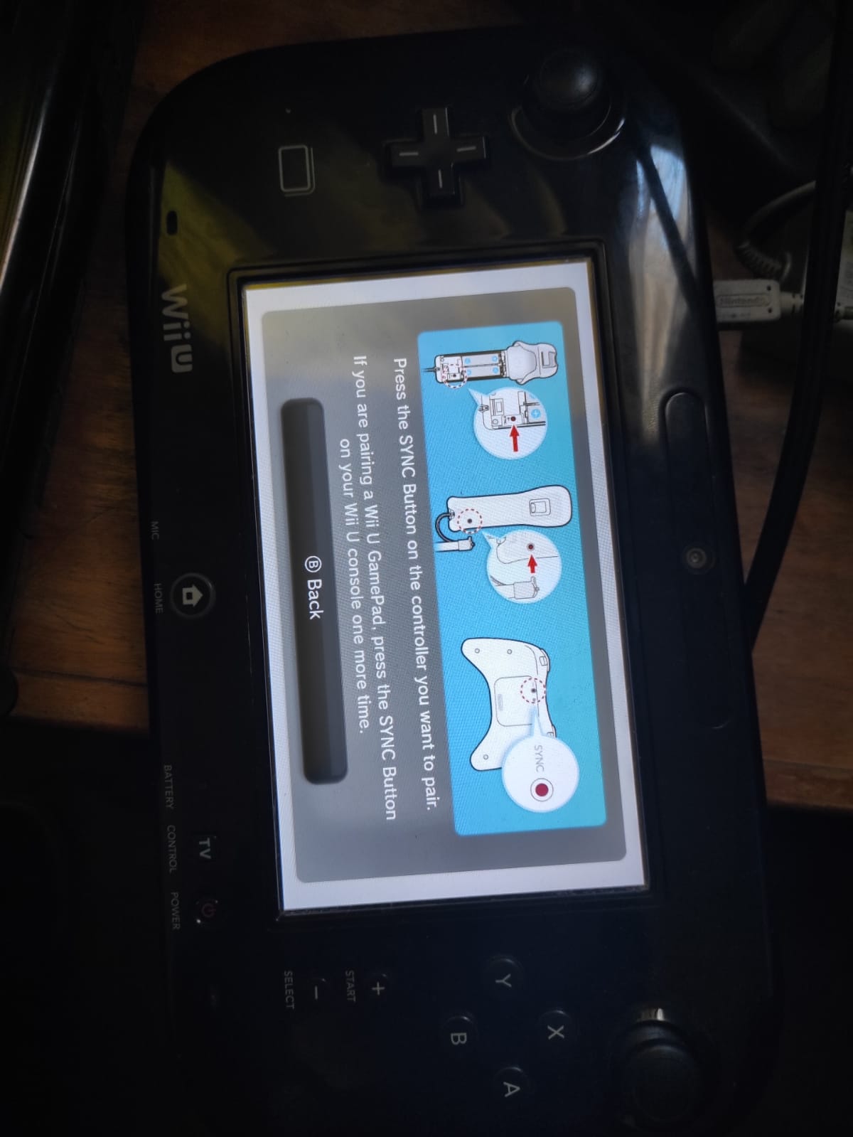

  • Don't set SSP mode if it's already disabled to avoid a warning (thanks @linkmauve).
Refer to the README for updated instructions.
@testing_this Can you try to fix your SSL brick with the wupserver binary? If you don't have an internet connection set up, I'll come up with something else.
Thank you so much for helping me out. @GaryOderNichts
Sadly the console isn't connected to WiFi. Maybe I can look for a USB ethernet adapter?
Terminal output:
