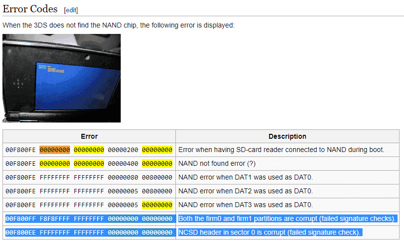

Bootrom 8046
errcode: 00F800FF
DEDEFFFF FFFFFFFF
00000000 0000000

Try restoring your NAND (upload your nonedited NAND back)
I think your NAND is corrupted. try restoring again.
Make sure also you have correctly soldered the pins on your 3DS Motherboard.
