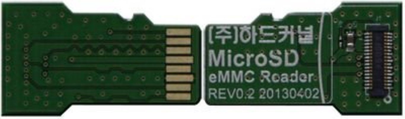

All you need is one of these adapters, and you can dump the eMMC chip from whatever imaging app you want, Linux on a PC would be my go-to choice.
Sure ;-) I know how to dump eMMC NAND's. I just want to dump it with the Linux I've got already running on my switch using dd without having to use any other external parts.
Ah, okay. I wasn't sure what your end-game was. I think you'll need a 64GB microSD card as a minimum then, just like the Wii U.
