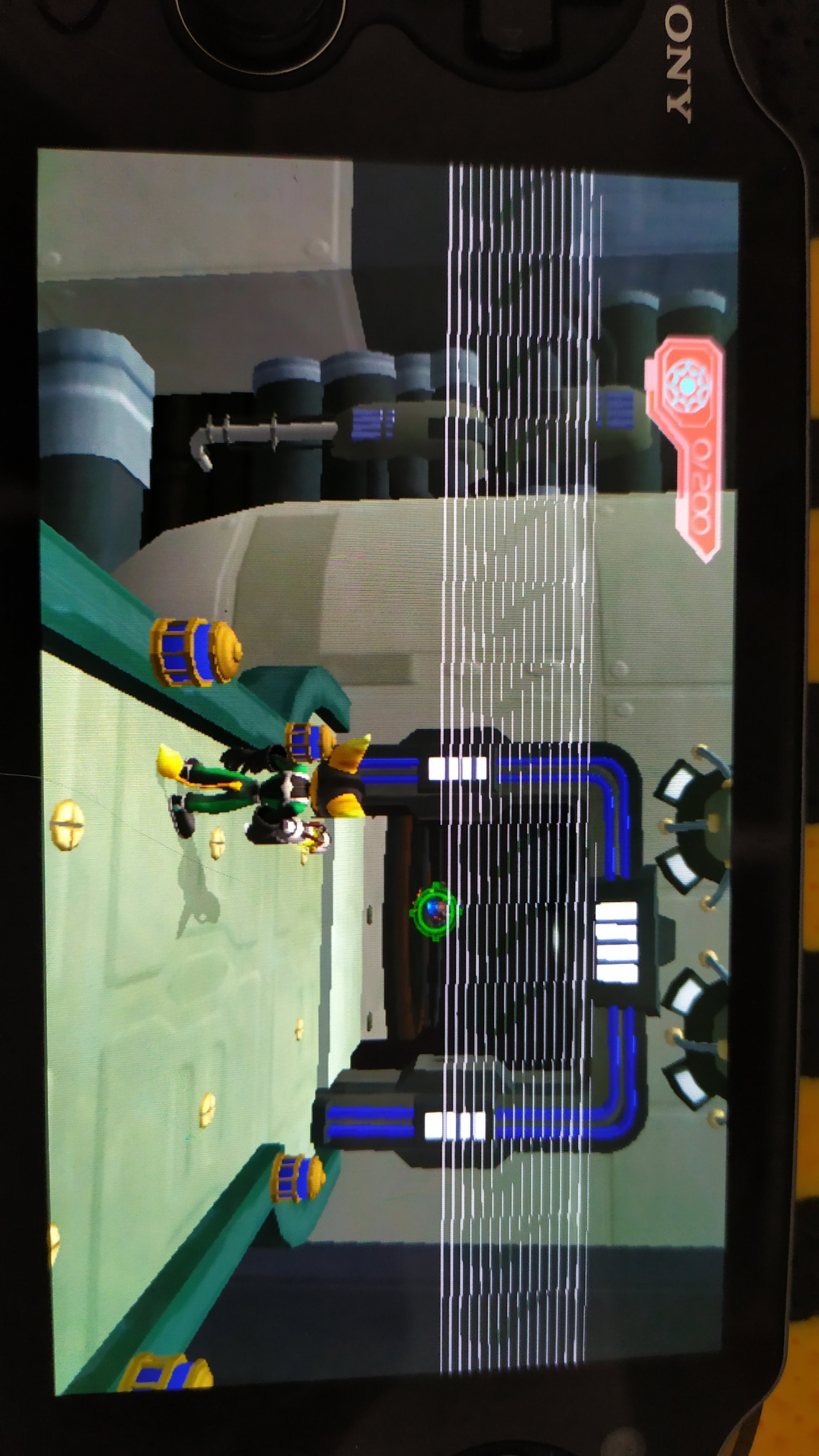

Something might be fishy with this console, every time I pick it up something else fails... I tried Ratchet Collection, and these white lines come and go.

It's not the game that's causing that

For the moment the Vita Ratchet games are the only ones where the lines appear. I tried installing the 1, 2 and 3 games from the collection separately, but the lines are still there.
I tried the PSP Ratchet games and they seem to be ok, no lines.

i think the motherboard is loose >>>> or something inside <<<<<
oh just read this .............. that is strange >?

At launch the Vita Ratchet games display a small message in the top left corner saying the graphics were rescaled, maybe that's something to look into.
I could open the console up again but the number of connectors scared me, maybe I'll do that eventually.
Is there an app to test the screen? I did a search but could only find hardware test for buttons...
