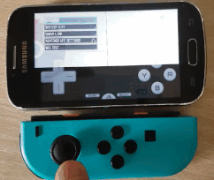

Tested on an older device with Android 4.4.4 and there is no lag. Sorry for the poor gif quality but hopefully you can see that there isn't any lag :)
So this is most likely a software issue and not a hardware one. I hope someone can bring Android 4.X Bluetooth drivers to Android 5.X and above :D

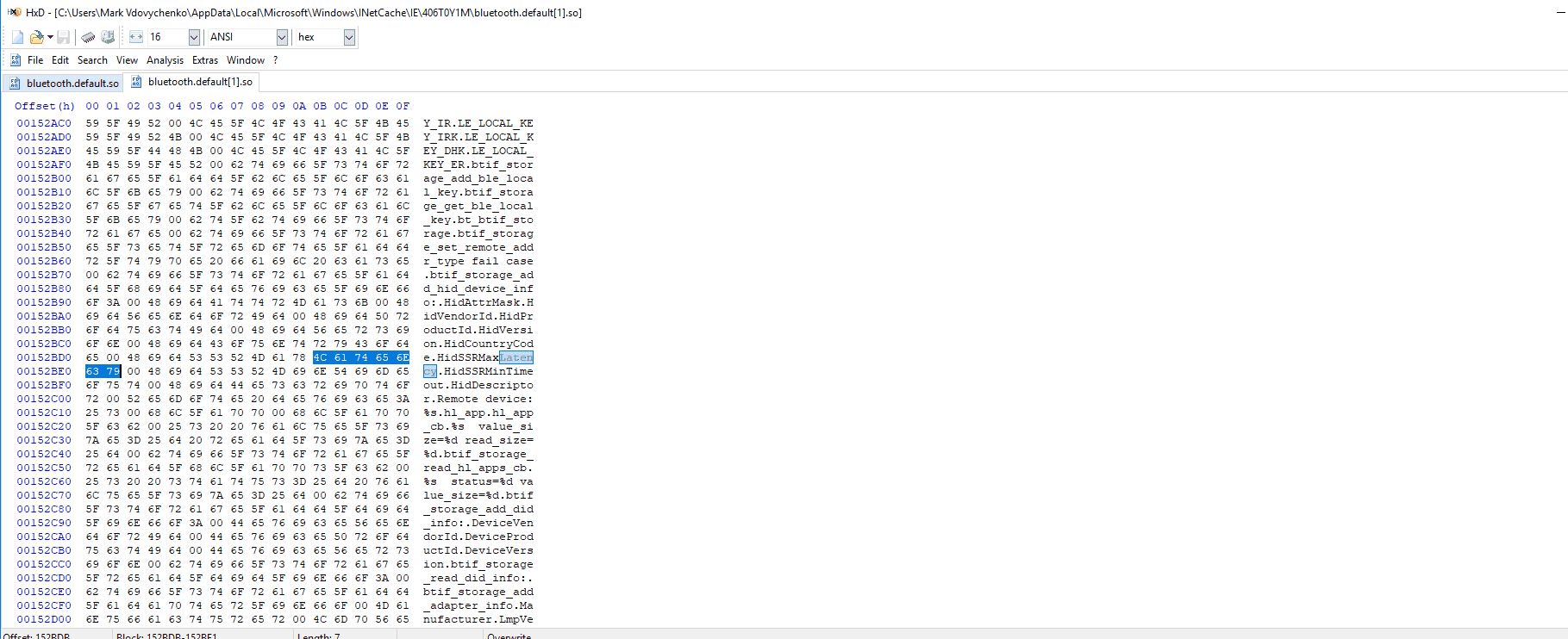

Is there a way to hack /system/lib/hw/bluetooth.default.so and rewrite the value of HIDSSRHostMaxLatency ?
Or can an app bypass, or overwrite, this attribute ?
*.so files in Android are compiled binaries. It may be easier to perform a memory edit instead.
