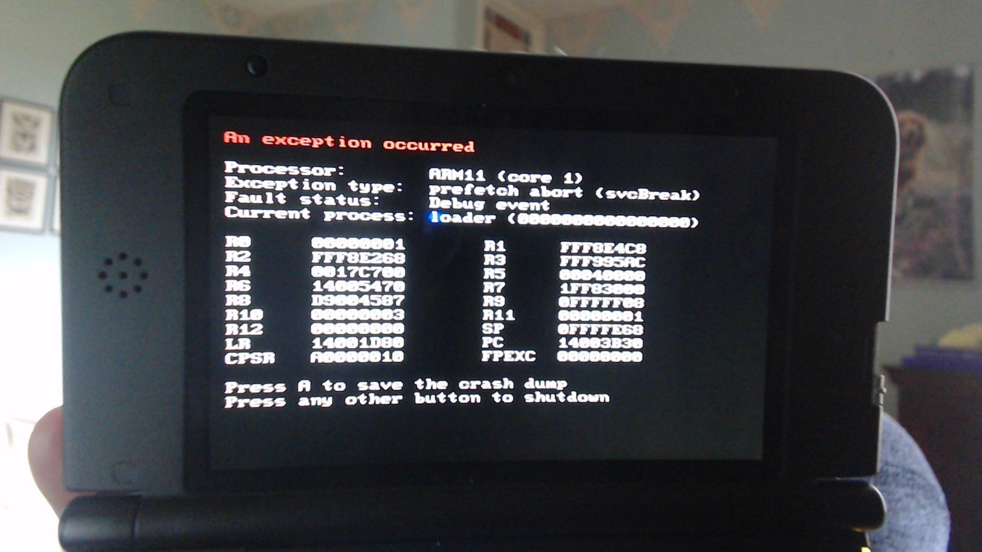

I have seen that program before I know my 256gb sandisk sd card is not a fake shitty 8gb thing.
i am not suggesting its fake (the program can help you find out if thats the case but i digress) but the 3ds consoles are notoriously rough with sd cards you should run the test program to see if there are any errors (corrupted sectors ect)
I have seen that program before I know my 256gb sandisk sd card is not a fake shitty 8gb thing. PS I have seen them sd cards before on wish complete HORSE SHIT and I fell for a few!
thank you any way @wormdood
Did you ever use H2testw on that 256GB sandisk sd card of yours? You can never be certain it's not a fake unless you test it.
Do not fall for the pitfall of assuming things. This is coming from someone who has been burned a fair share of convincing fakes that at times, I wonder whether companies like Samsung and Sandisk are in on it, off the books.
I have just check it with windows error checking.
I just did not want to use this tool because I would have to wipe the sd card hmm
if there is another I can use let me know...
Ps @wormdood I am talking to a few people who are good with the 3ds and should be able to help. mate I probably will try that tool if it comes to it and do you know any other tools for checking if the sd card is a bad one.
Copy everything off the card onto your desktop or external hard drive. Reformat it and run it trhough the program. IF it passes, wonderful. You get to have peace of mind of perfectly working hardware. If not, well... You know the rest.
Yes, this whole checking process is cumbersome. There's no way around it.
that app is the best for looking for errors . . . but yeah you would need it empty (there is no way around this if you want to test the validity of your sd card sector by sector)

we can try another way though (if you cant/dont the ability to backup your sd card)
. . . you could look at the files (and within folders) yourself and look for corruption within the files/folders (garbled filenames and/or impossible sized files)
Reactions: ratmandom
it does boot up lots of 3ds games it is only like half that dont work, and a load of homebrew will not work , my next card wormdood I should test out the box.
I will sort this one out soon I hope thank you

I have just formatted the card and tested out a game that did not work before.
It is fixed! I think because this game just worked. it was a bad format tool I used before, that caused the 3ds to not boot up a lot of stuff of the sd card.

I know about fake cards I have had a few, I know what to look for I can even tell by the packaging. I have seen the fakes and yes the look very similar but I can tell (this card is a sandisk by the way with a nice shiny reflective gold label).
I dont get fooled by them next time I get a card I will use H2testw, if it is fake its going straight back.

The other two reported their h2testw came back clean, yet they've been experiencing data corruption just like you. Giving heads up that the issue may not be the card, but the 3DS itself. Did Nintendo drop the ball somehow as their parts dwindle in assembling those last units? Take precautions in case something fishy's going on.
could have been as simple as having had the incorrect cluster size :unsure: . . . but i am glad to hear your all good now :yay3ds:
