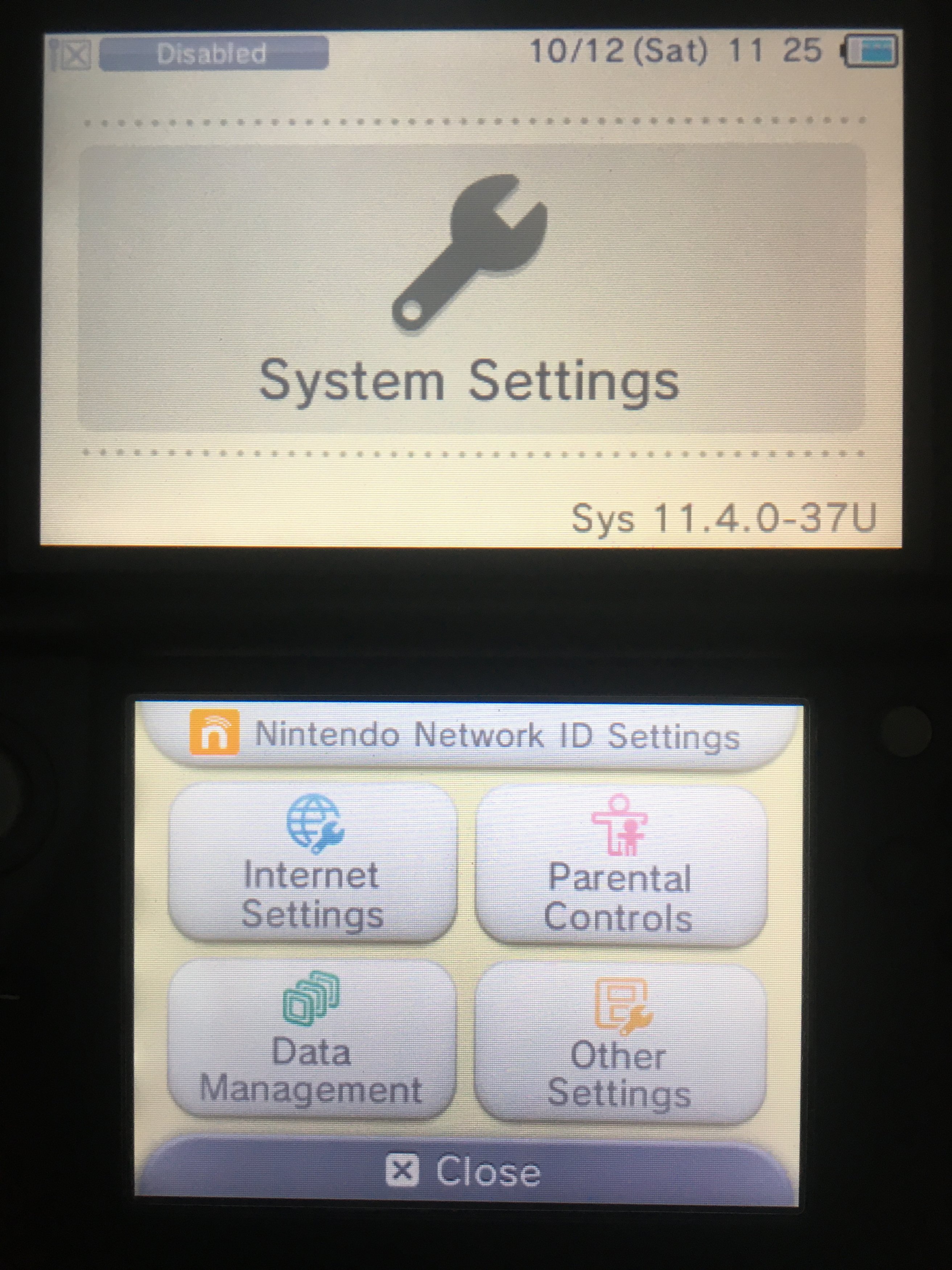

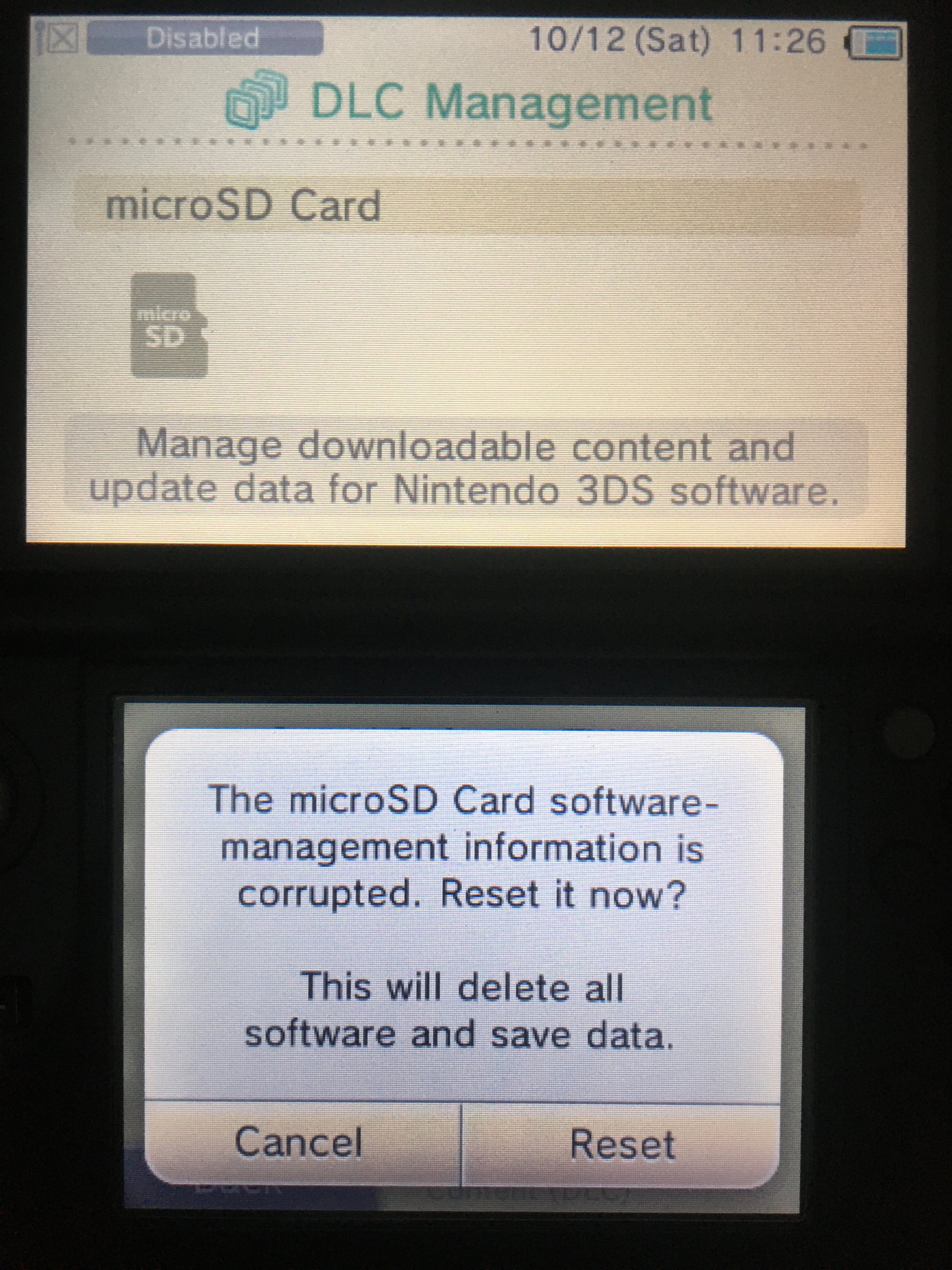

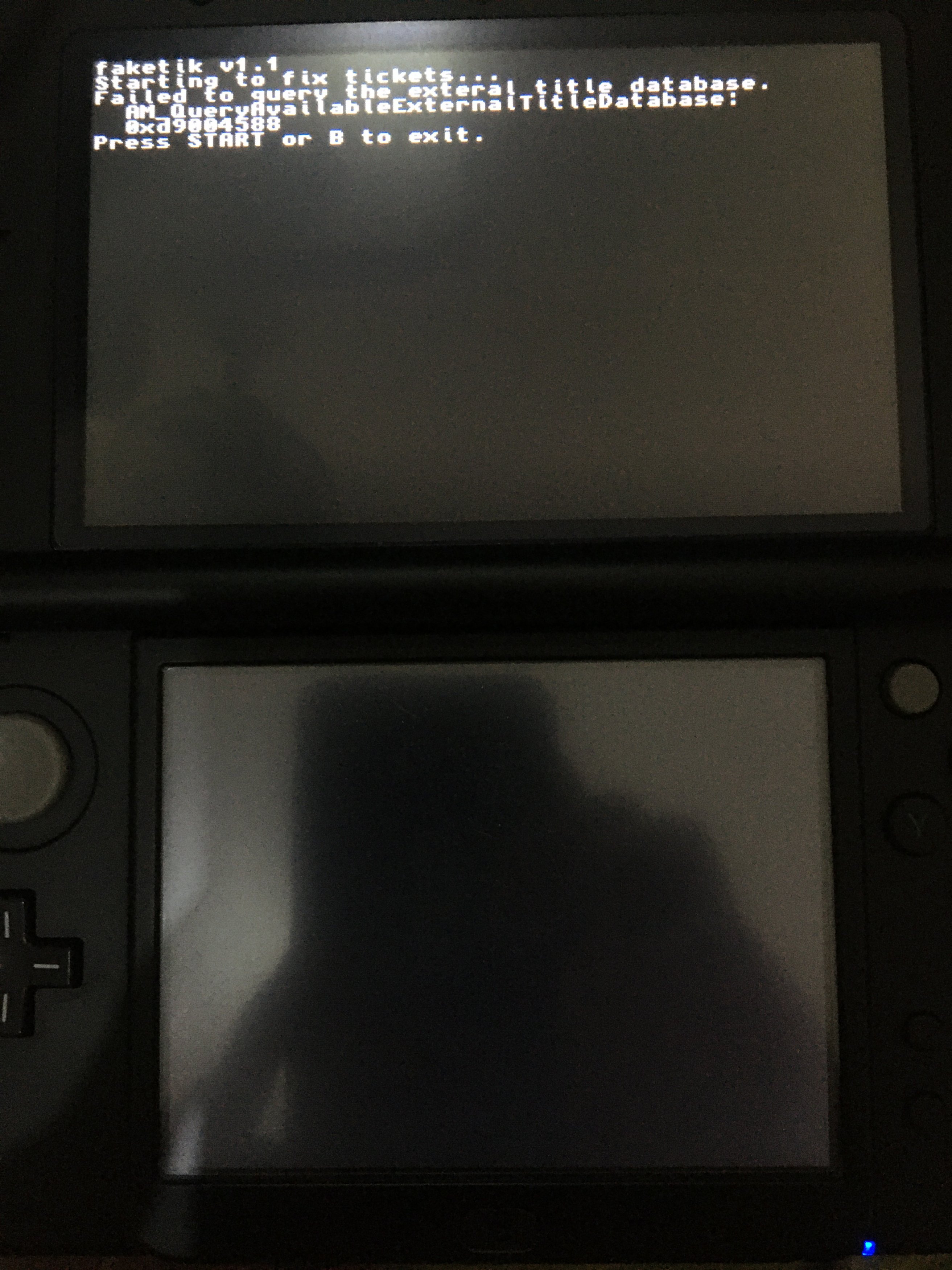

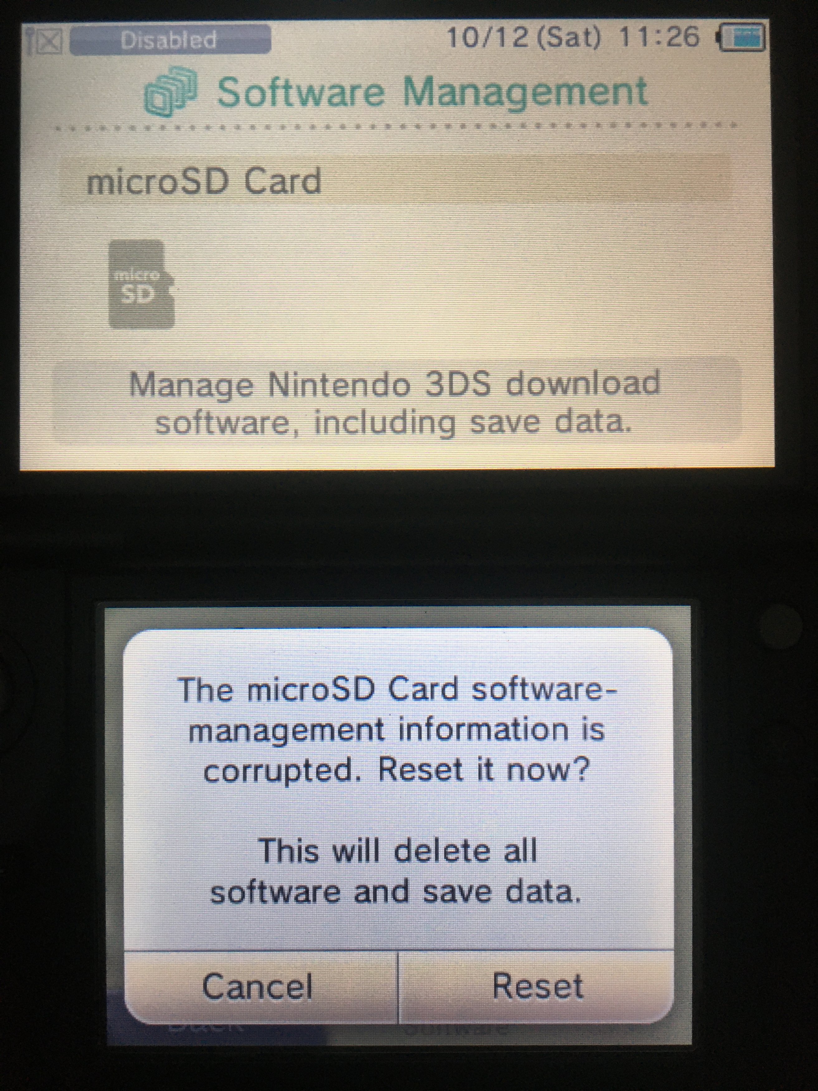

Hi, thank you for replying, I've successfully fixed my missing tickets with TIKDevil.3dsx last time.
But right now... I'm facing a much difficult situation, please take a look at these photos...
IMG_6439.JPG IMG_6440.JPG IMG_6441.JPG IMG_6442.JPG IMG_6443.JPG IMG_6444.JPG IMG_6445.JPG IMG_6446.JPG IMG_6447.JPG IMG_6448.JPG Screenshot (17).png
All my games and homebrew apps are gone after I deleted Corpse Party using FBI (I deleted it coz the game told me that it can't load the save data, so I though reinstalling should fix it), then I pressed the home button just to see my empty homescreen, so I open FBI again, it shows some error codes in red, crashes & turn off my N3DS LL with USA region installed.
Before this, my drawing in COLORS!3D are all corrupted too, and I can't fix it by importing my previous extra data backup with JKSM.
But my 64gb VGen Micro SD doesn't seem to have any problem...
Is my problem can be fixed? I'm planning to Relisting or rebuilding the 3DS database files with CTRTransfer (Type D9) from your tutorial, but I find it very complicated and not exactly the same problem based on ur screenshots. Thank you.
@SSKRider, that's definitely corrupted database. The reason why Extra Data Management lists those titles is because those aren't your installed CIAs but their extdata (think of them as their secondary or extended save data).
Reinstalling a game title's CIA in FBI will overwrite and delete its save. Your Corpse Party save progress is gone..
I recommend that you make a backup of the Nintendo 3DS folder on your computer and use that script's Option (B) - Full when rebuilding the SD card's title.db and import.db.

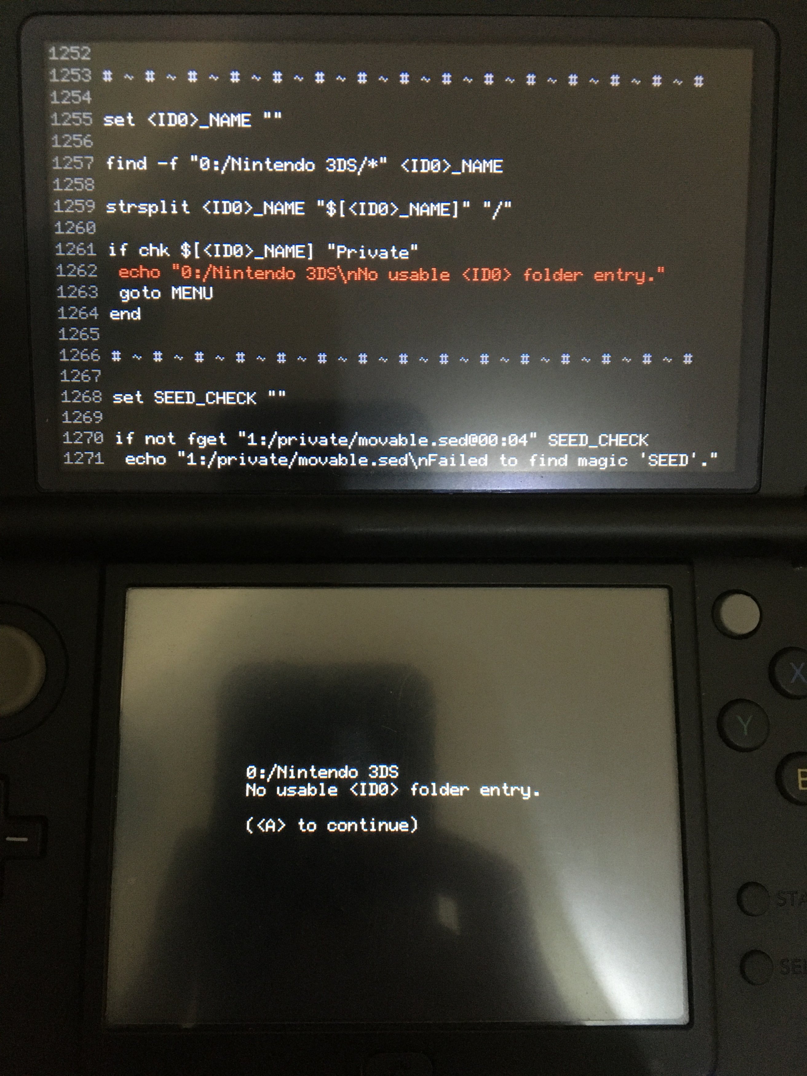

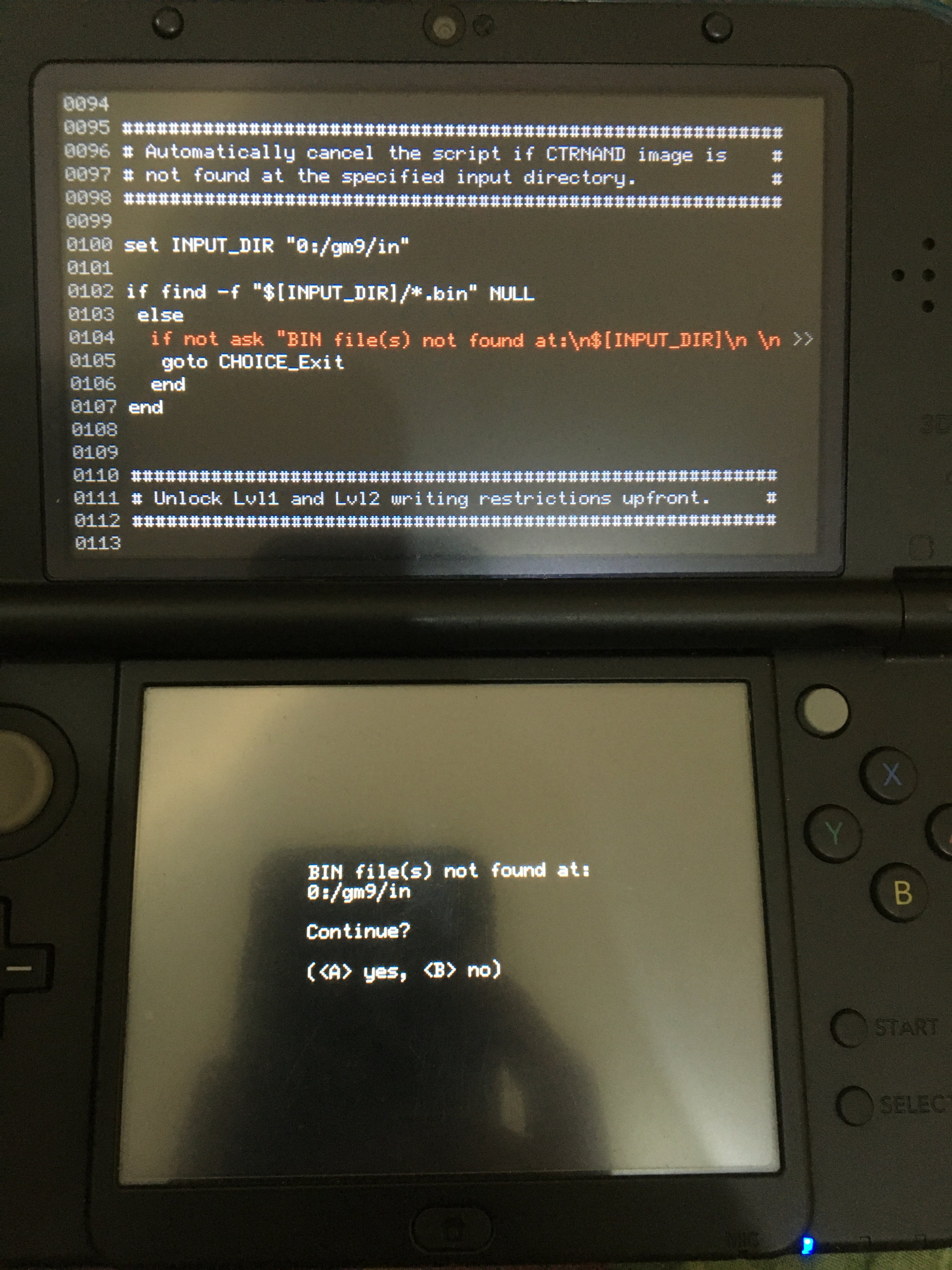

So... I followed your 12 step and got stuck at step 7... What's wrong here?
And what do you mean by "...build a reference SD setup." at step 5?
For the message:
BIN file(s) not found at:
0:/gm9/in
, just ignore it. This script was originally created specifically for CTRTransfer or sole purpose of 3DS firmware repair but Iater versions kept adding features that has nothing to do with it. The warning was to remind whoever intended to do CTRTransfer that "Hey, you forgot to add the ctrnand *.bin image."
For the Fix movable.sed KeyY, there's a bug where it's trying to find the 32-char <ID0> subfolder. Even though the first folder list in Nintendo 3DS is <ID0>, the script for whatever odd reason defaults to finding the Private subfolder.
Relocate the Private subfolder out of the Nintendo 3DS parent folder, run Fix movable.sed KeyY, and then put it back in afterwards.
The long overdued v1.4 of the (Type D9) script corrects both of the above issues for better user friendliness.

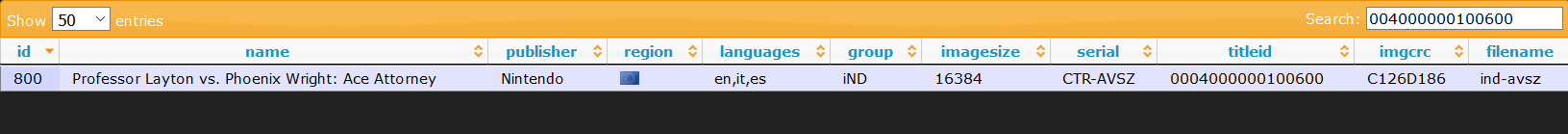

The process is still running, but I got this one error, at least for now, what does it mean and what should I do?
A failure to dump or rebuild your title into a CIA means that there was a mismatch in SHA-256 hash between one of *.app contents and what's listed in the *.tmd (title meta data).
You'll have to replace Professor Layton vs. Phoenix Wright (EUR) with an intact CIA from somewhere or from previous download / backup collection. Check the missing_titles.txt once the script finishes its run to see which titles weren't dumped.

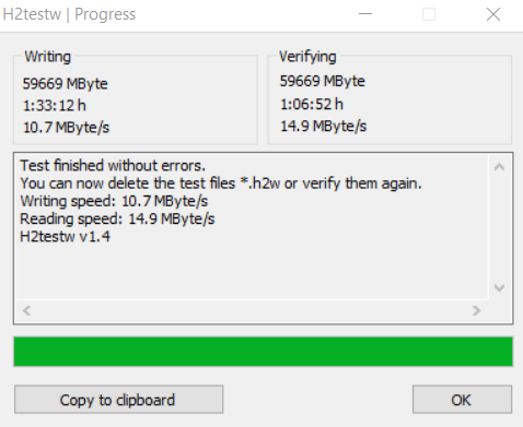

I have suspicion your micro SD card is no good. Even though it passed H2testw (it's a real 64 GB card with fully intact capacity), V-GeN might have made it with a shitty controller.
If you read that thread's later posts and this one:
Another user, NoSnake221, was in a similar situation where his Kingston sd card checked out fine in H2testw, but his n3DS got stuck in a loop in Fix movable.sed KeyY. He replaced his card with ADATA brand, which was what was locally available to him.
Another cause of concern was his crappy T-FLASH microSD-to-USB adapter, the ones that come with DS flashcart. That reader was corrupting his files.
