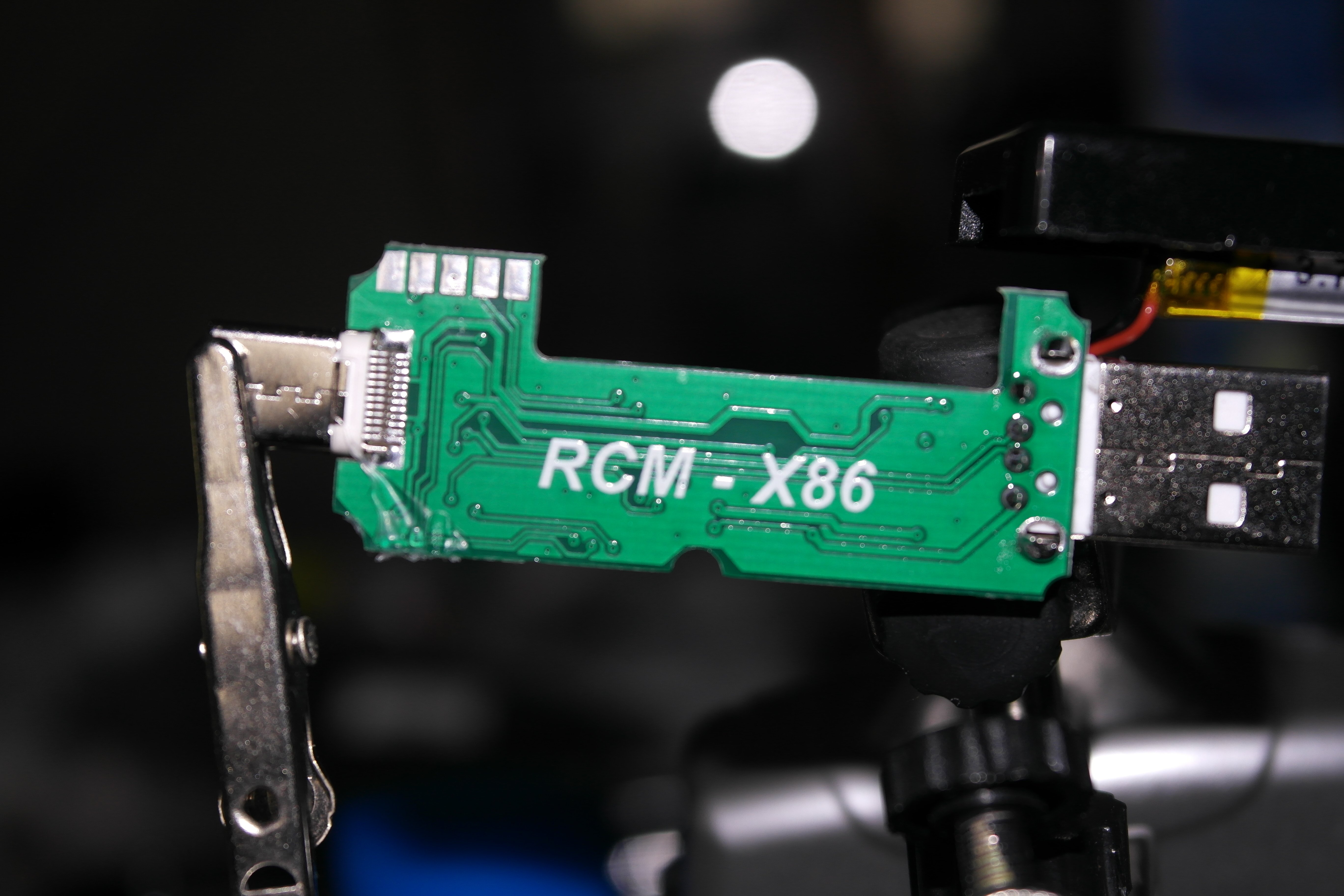

I think they have pads for debugging on the back under the gob of hotglue. rcm-x86.JPG

Yeah that's what OP is talking about. No-name rcm dongles based on SAMD21 chip. They're basically a trinket broken out to a usb c port on one side, and a usb-a male on the other to charge it and update fw/payloads. For some reason they seem to be stuck in a bootloop, mine never worked at all, other people used the update instructions that came with it and found theirs in a similar state. I'm hoping to find a way to get it rolling again without having to solder for the peeps in this thread that aren't able or don't want to mess with the tiny smd resistor that the seller has pointed as the solution.

This is the same device I was able to install internally after removing the USBA and USBC from each side.
I was in a similar situation, but after flashing it eventually popped up as a storage device on my PC (The original expected behavior), and I was able to copy a uf2 to it without issue.
This device is a little too big for internal installation... And the firmware is not made to allow for updating of payloads over the Switch's USB C, just that USBA. @mattytrog are the pins leading to the USBs from the controller the same for every Trinket clone? Would flashing a payload such as the one created by you for the original Trinket M0s conflict in any way? I assume its flashed with a bootloader that tells the device which pins go to what, uncertain how these things work.
The soldering on the fine pitch USB-C end of mine is pretty janky, I was considering that may be the issue before I logged on here and saw other ppl saying theirs was okay before they tried to update the payload.
