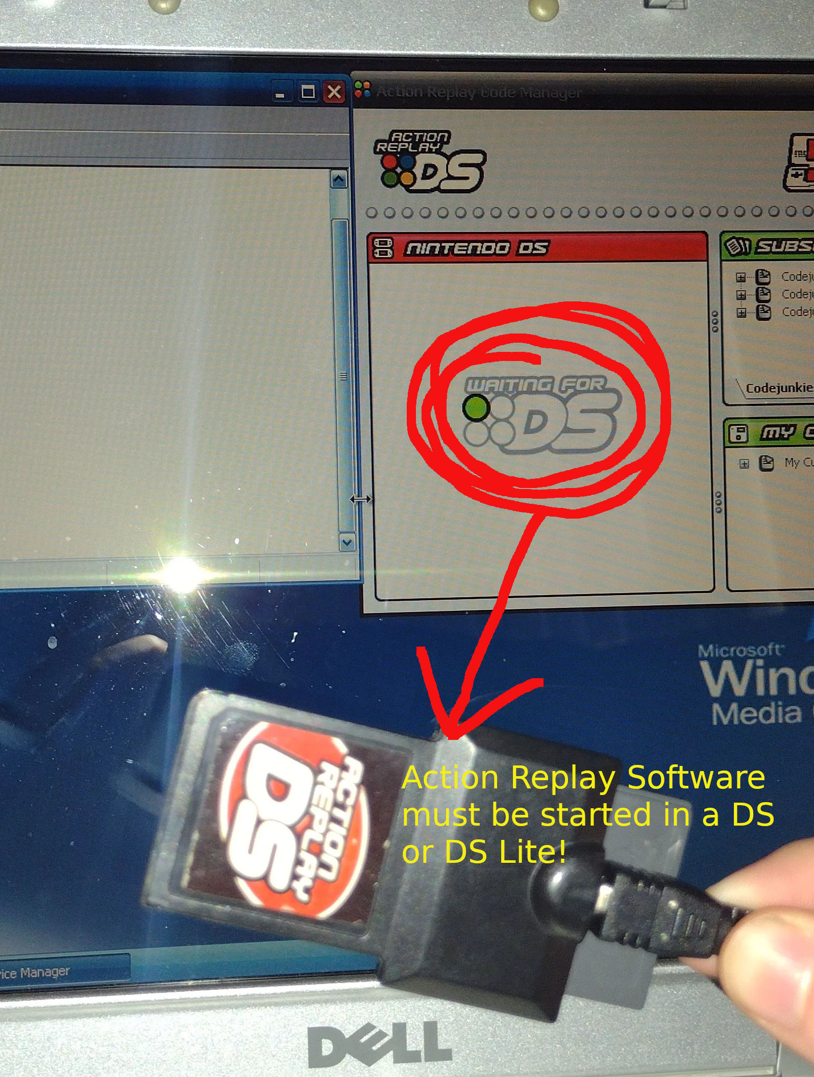

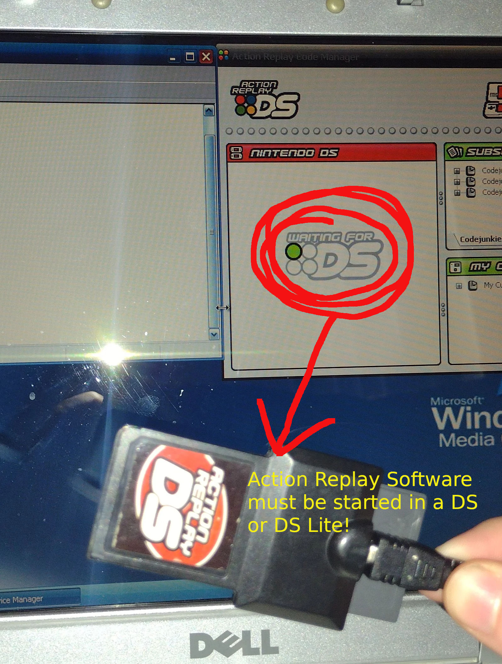

Here are the images.

@NDCADD87 Thanks for bumping the topic! I missed the last message and the photos above.
I hope you have the exact same problem… maybe it can be solved now easily:
AR Code Manager will not be able to access Action Replay DS content by simply connecting the device to the PC. This works only while the DS (Lite) has started the AR software. On the DS there will be a note about the PC connection as well.
It says "Waiting for DS" not only "Waiting for the naked AR"
You are welcome. So everything was working one day before I commented on this post. I updated my AR to 1.71 and then the yellow mouse disappeared from my AR. it used to be where I marked the photo. It was there until i updated it to 1.71.
  • Wow
Reactions: KleinesSinchen
This red [START] should appear only after inserting a game instead of the AR itself.
