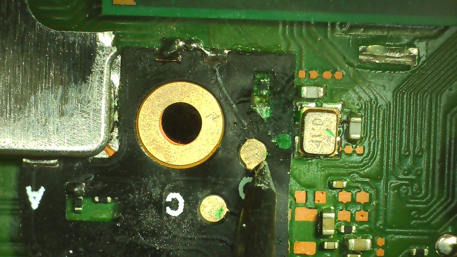

I accidentally removed a solder pad from my RP2040 Oled ribbon. I don't have another ribbon to use and don't have the skills to repair that solder pad. What else can I wire that resistor to instead?
nop is an anchor point of the OLED ribbon
but, I also am worried about the SOC component on which the ribbon will be anchored, seems from the first picture something is missing or damaged.

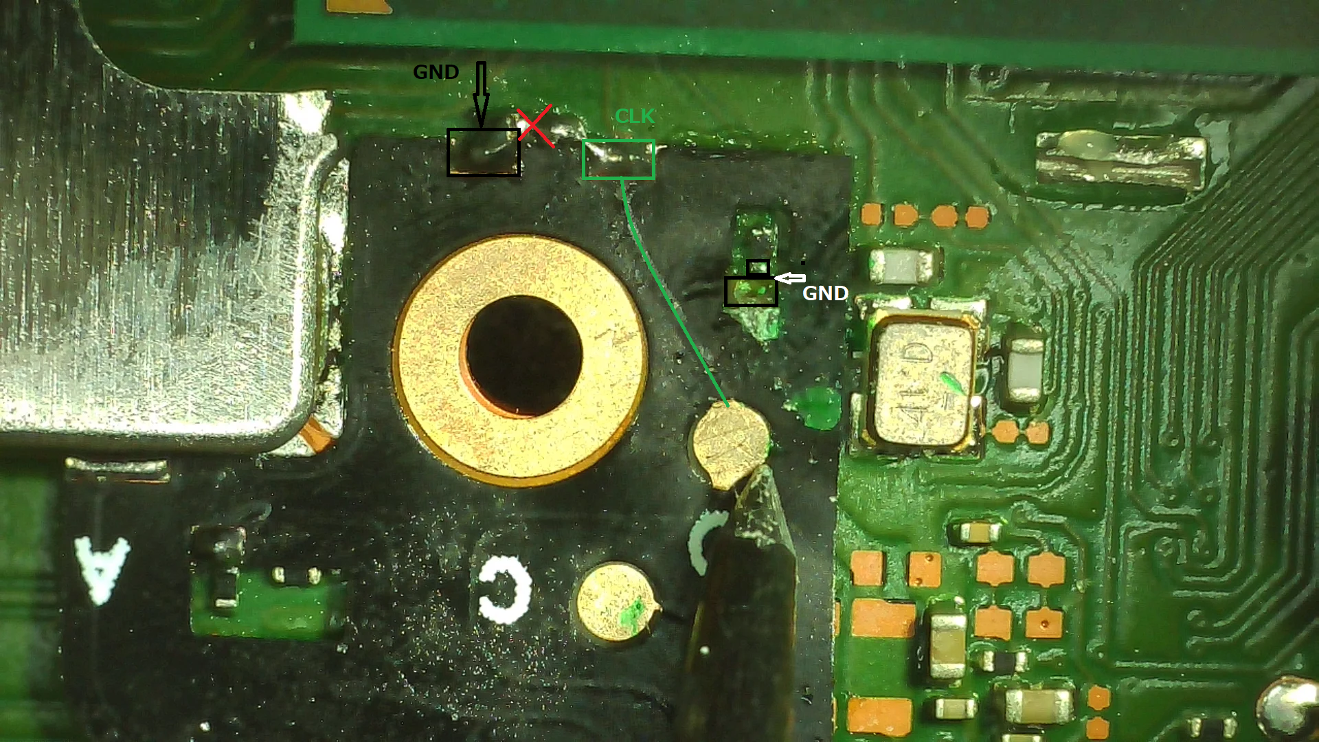

Im not sure but I think you bridged D-point to ground!!! I recommend to measure before powering your OLED.
  • Wow
Reactions: impeeza
thats just ground pad on that resistor pad far from cpu, and yea I think op bridged GROUND and CLK together .

Im also not sure if I see it right on the picture but I think that the D-point (clk) is not grinded and soldered?
