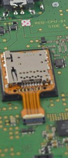

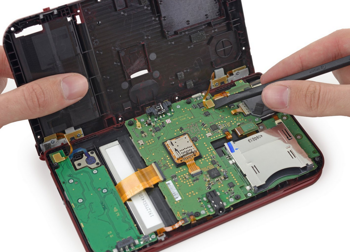

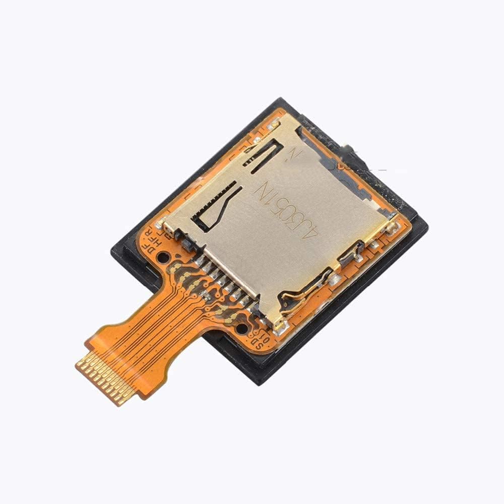

New 3ds XL is designed in a modular way. The SD card reader happens to be it's own module.
You could build a board with a ribbon cable and a ribbon connector, plug the reader into it, and then plug it into the console. You could then put the SD card control logic on that board.
You could also develop it with the sd card reader disconnected from the 3ds to make sure you can get usb writing working before putting it in your 3DS.
