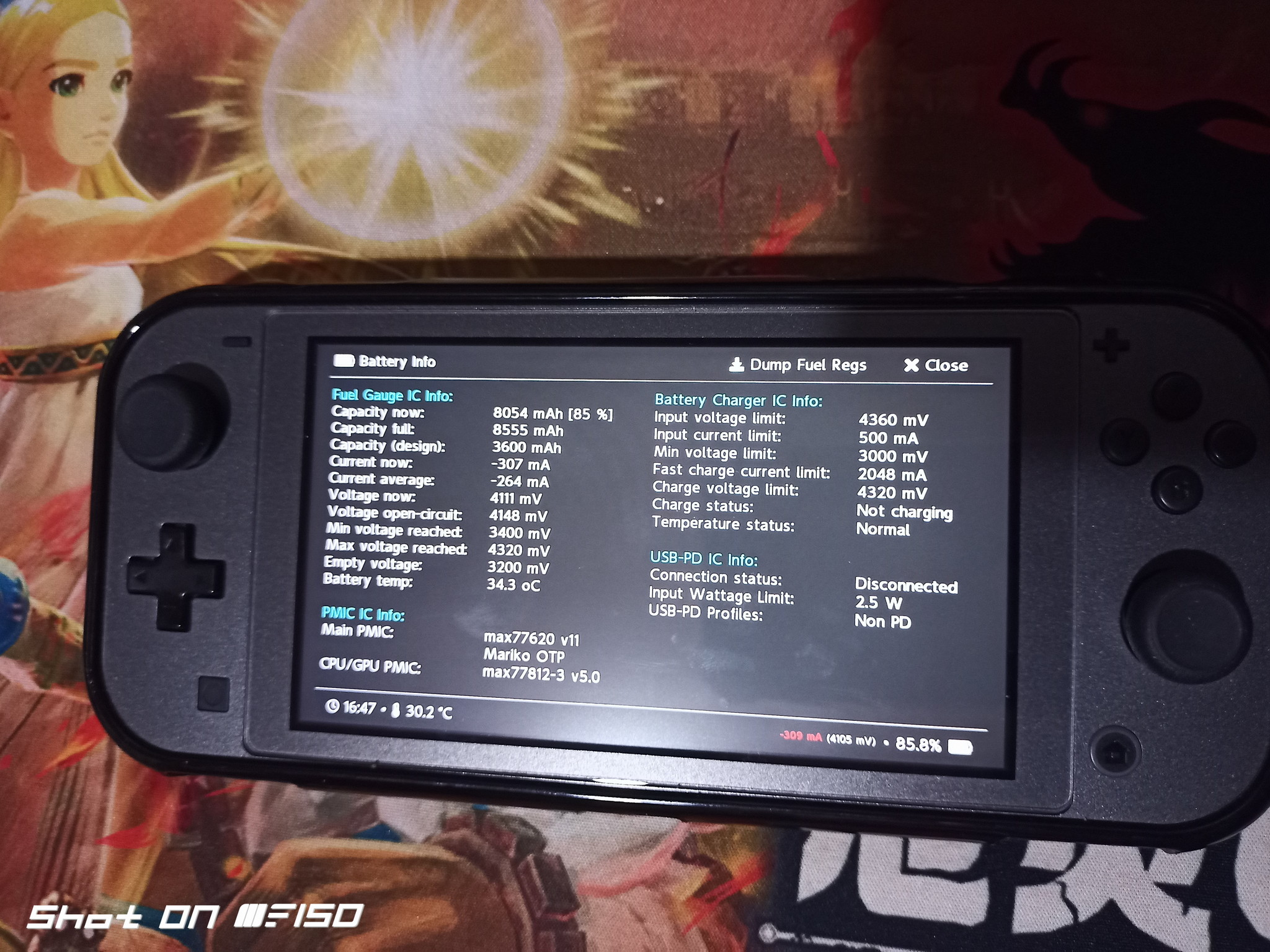

Nice.. mine I modded my switch lite with 8000mah.i parallel 2 4000mah battery
Just interested, have you tested the capacity of your battery or checked the reported capacity in Hekate? My mod is also technically 8000mah, but 6400mah in reality. I imagine the lite will get more usable capacity as it charges up to 4.35v
Actually not just 8000mah its 8555mah of total here is my hekate

Actually not just 8000mah its 8555mah of total here is my hekateView attachment 391642
Did you simply stack two batteries on top of each other and wire them to the same BMS?
