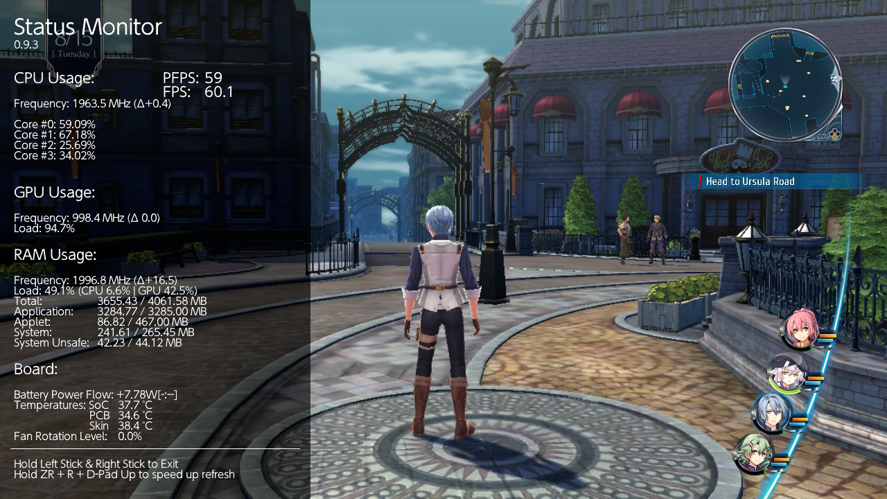

No, i don't mix it. The information is placed correctly. You're right, there is no problem with the CPU undervolt (because it just wasn't there) in the old versions, it exists in the new versions (1.7, 1.8) and has not been fixed for a long time. This is a typical situation for 4IFIR, it happens all the time.
I attach a video, no problem.

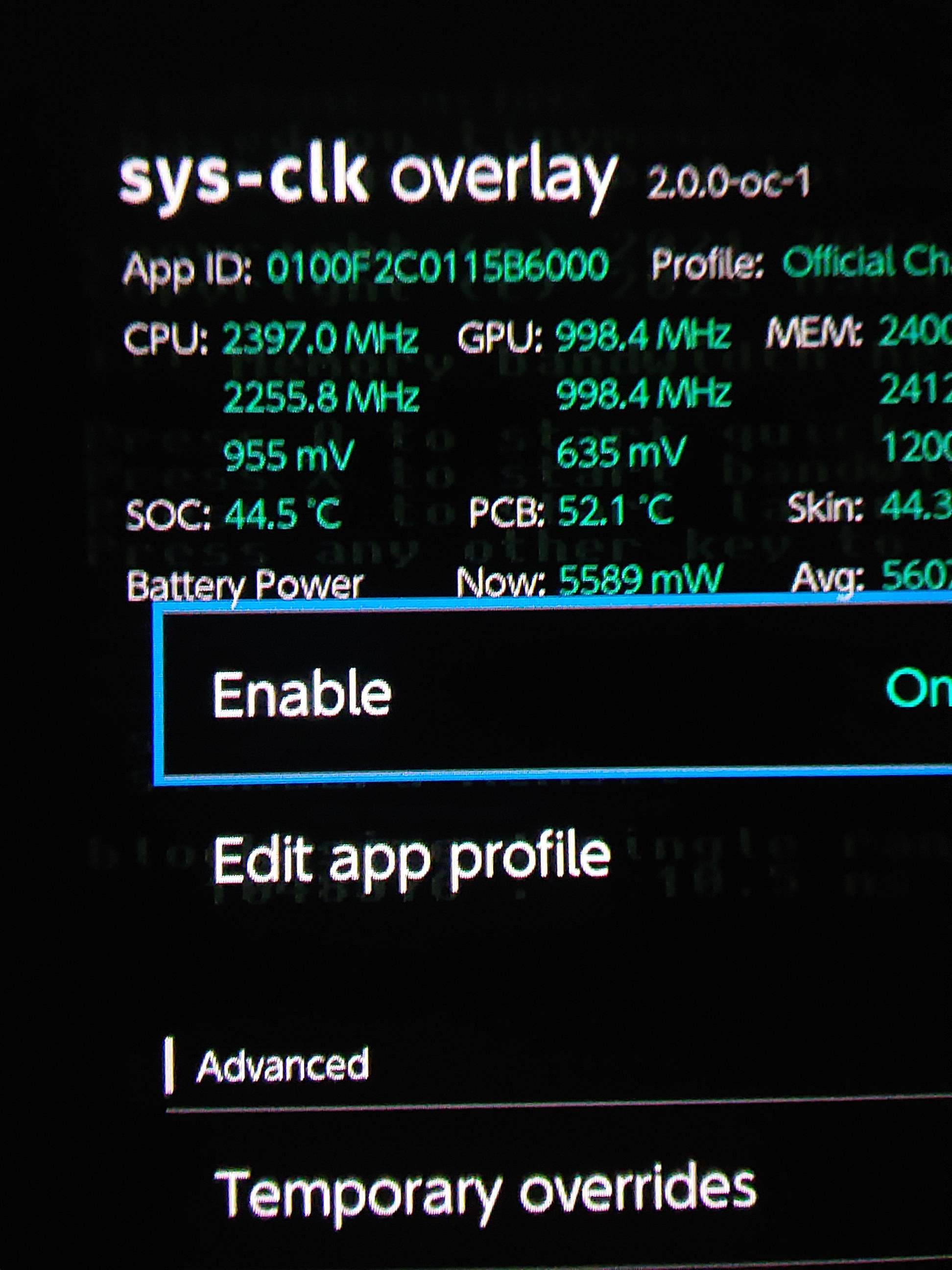

sys-clk exposes real frequencies with version 2.0.0. It is just a matter of using 4IFiR loader.kip with original sysmodule (it doesn't affect any voltages and timings) and overlay to see if any of those clocks are faked. Using closed source sys-clk sysmodule (like in 4IFiR) can result in tampered results.
Example what can happen if you don't set correct voltages for CPU (this is not from 4IFiR)
1. Target frequency
2. Real frequency
Though the best way is to check them while playing, and this is why I'm working on getting those info from sys-clk sysmodule to status monitor + few other things for 1.0.0 release.

Yeah, sure. This problem is more than a month old, it's not new. A lot of people have done tests in different games, the result is clearly visible on my videos, the problem exists.

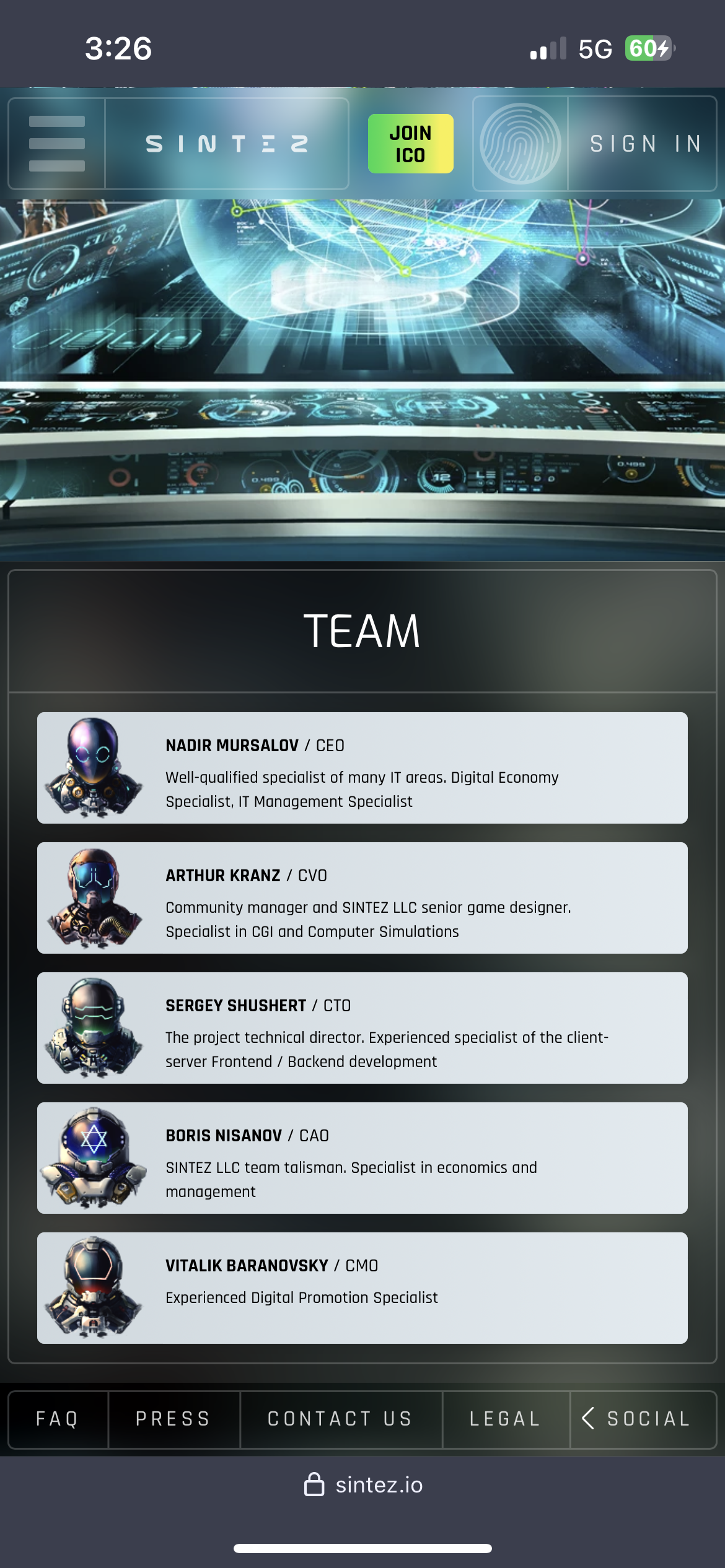

I did some deep investigation on Cooler3D and he's a special case. He's actually the one that started an old "Portable Gaming" console Kickstarter that ended up being a massive scam, and even now he's hosting an NFT(!!!) project. Take that information as you will.
Regarding performance across both, I do A LOT of benchmarking, and my own results have determined that 4IFIR is far less stable and has never exceeded performance compared to using the official Switch-OC-Suite setup. In fact, I actually get better performance sticking with the latter (shoutouts to every *actual* dev who's contributed, y'all are fantastic).
Screenshots for proof. Also, look up the PGS Kickstarter project.
