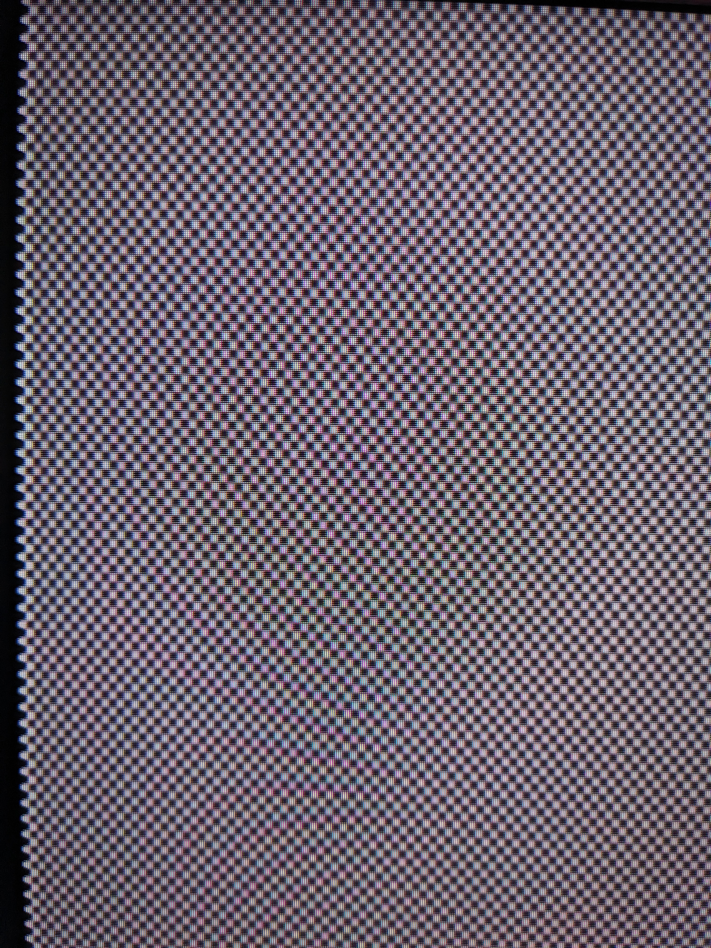

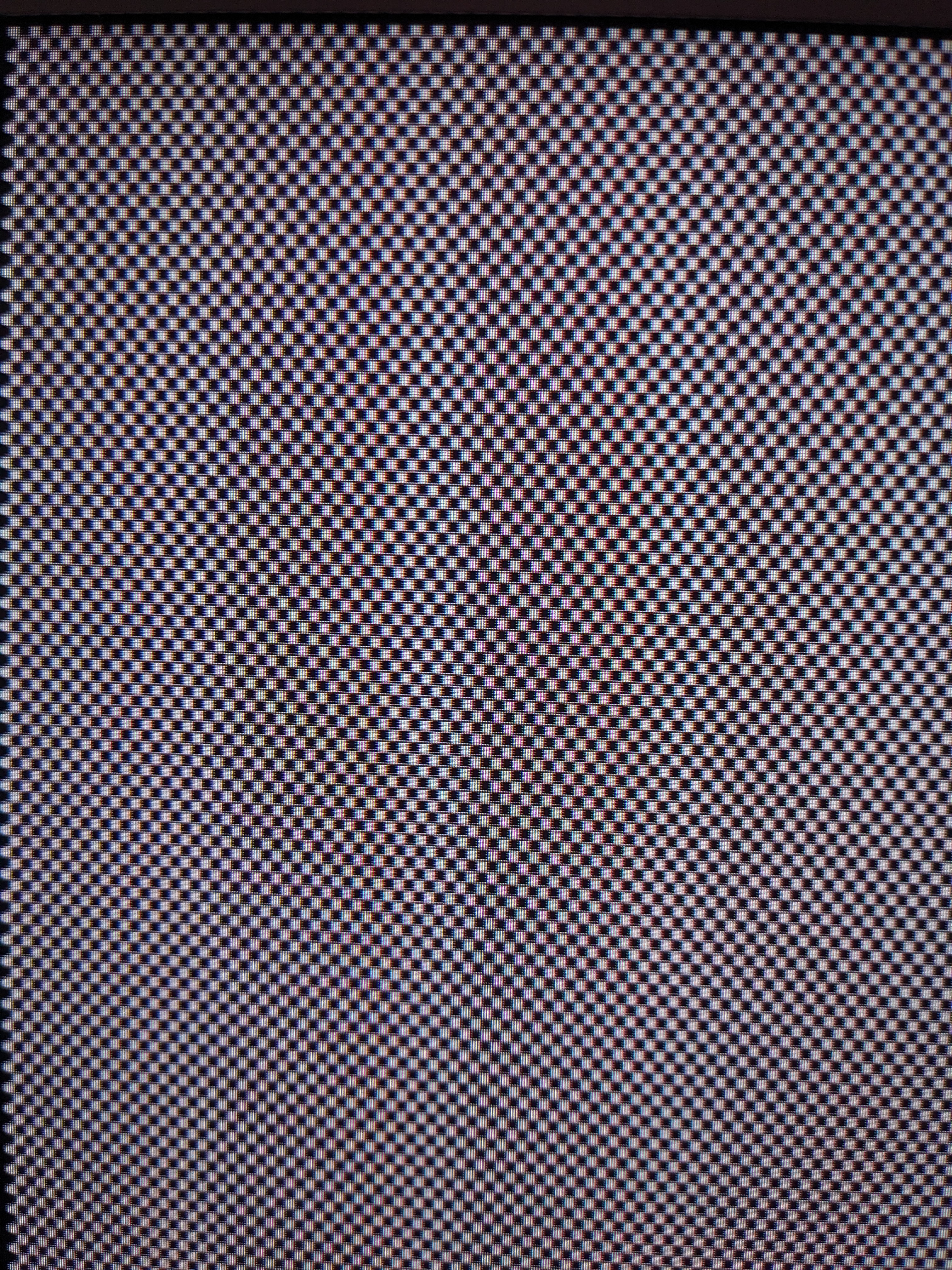

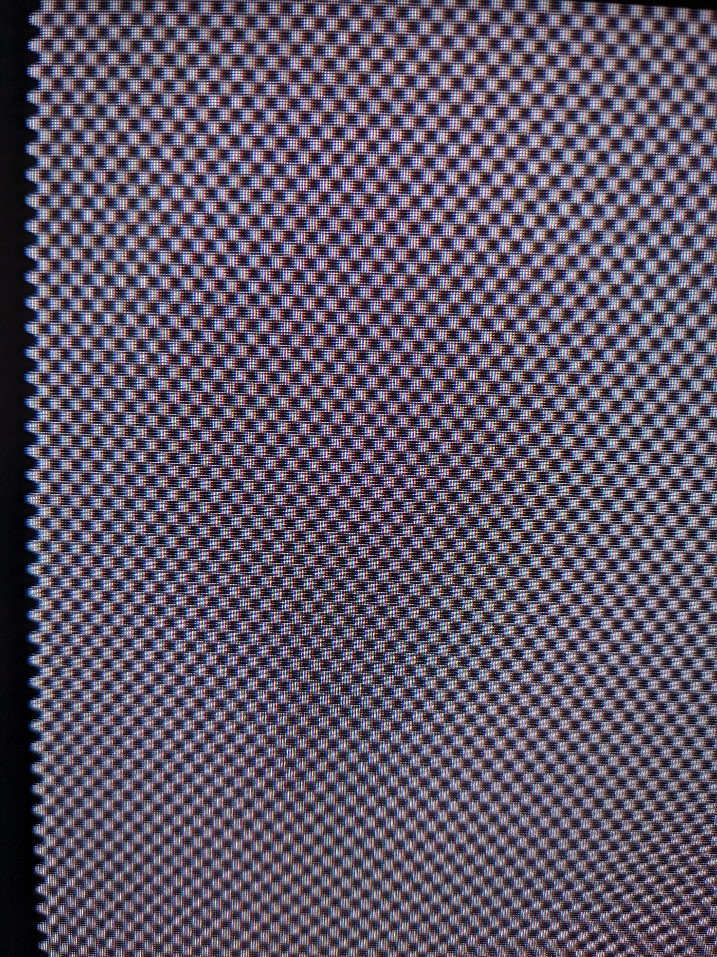

Is there any way to check if the fix is working on a specific Wii? I thought the 240p suite checkerboard test was the way to go but I have the exactly same (correct) display on a RVL-CPU-01 revision (which is very likely to be fixed) and on a RVL-CPU-50 revision (which should not be fixed).
Make sure you picked "480p mixed 480p/240p assets (1:1)" and not "480p scaled 240p assets & scanlines".

Thanks, I was indeed using scaled assets (to have the menu full screen and not in the top left quarter). So I changed to mixed assets but I still don't see any difference :
  • CPU-01
  • CPU-20
  • CPU-50
I am confused because I saw this post where the difference was very clear : when not fixed the black in the checkerboard was grey
