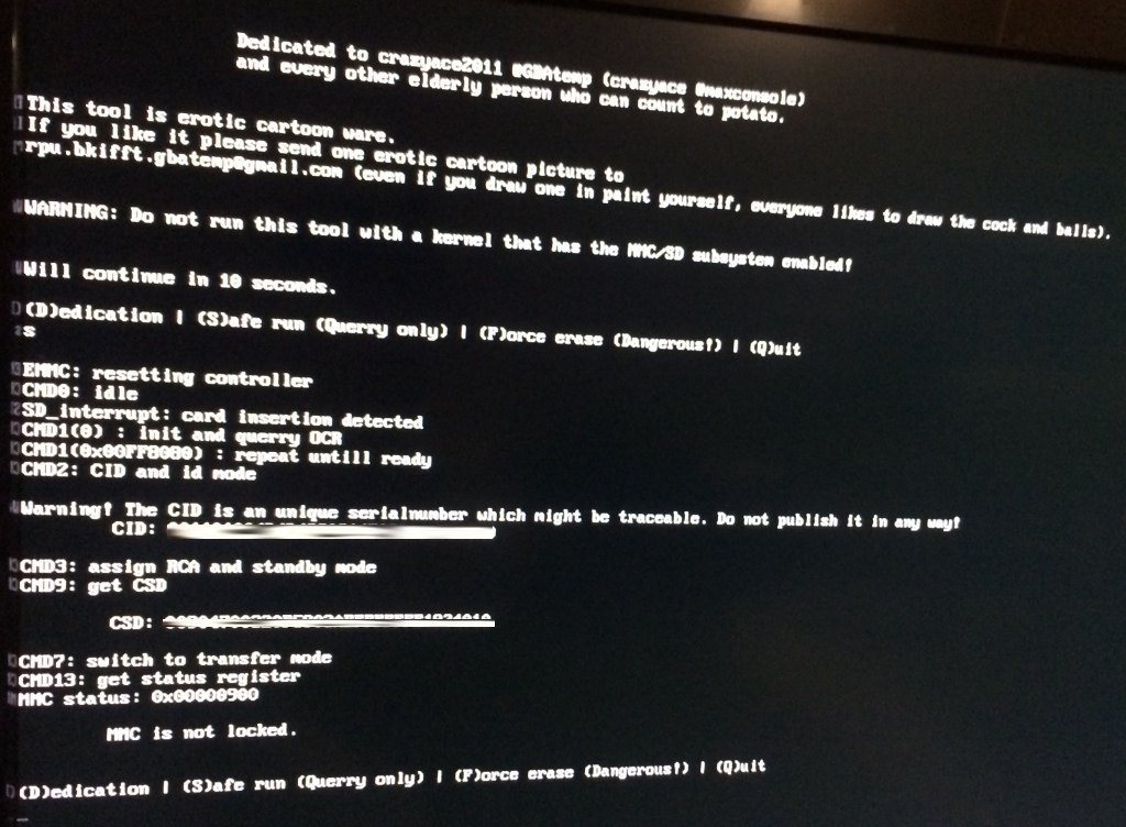

Guys,
I'm trying the Rasp method since my Arduino still didn't arrive. I still don't have any bricked 3DS but I decided to give a shot with my own. It's not bricked so I'll only run the s (status) command.
I flashed the SD and my USB with the kernel image and put the RPU.zip (formally master.zip) into the USB.
Plugged the HDMI, the USB and the keyboard. Turned the Rasp on and after some time I looged in and ran the 3dsunbrick command. Some seconds later I was presented with the options.
Then I removed the SD, plugged my cable (4 wires) into my not bricked 3DS and turned it on. Blue screen came in, so I plugged the SD cable into Rasp and typed s (lowercase) and hit ENTER.
Then I got this screen and I, honestly, don't know it it's ok or not.
https://www.dropbox.com/s/6h267pmwacb37lu/IMG_20140201_143918.jpg
Can anyone tell me if this is the expected output for a not bricked 3DS status?
Thanks in advance!
For some reasons it failed to get the CSD (did you unplug the card or hit it accidentally ?), but everything else is fine.
Edit: Whoops, didnt saw that two errors are set to 1... look like CCRC error bit is set, bkifft can tell you why that happened, but I have no idea about it

That's strange indeed... I'll have to lookup what exactly the CRCerror was(believe command crc, will know for sure soon).
But i'd also advise you to blurr out your CID, as even though Ninty is not sure to have them on record one never knows.

mvmiranda . ok, that error shouldn't happen, especially as it did transfer the (seemingly) correct CSD (the content of the four response registers at the bottom of your picture).
CCRC_ERROR (command crc error) should (as in "thanks broadcom for telling me to look it up in a non public datasheet") mean that the pi didn't get a correct crc reply while running the command.
has it only happened once or does it happen constantly? also have you already been able to dump your nand successfully? edit: scratch that question, was typing while you posted your last reply

Shouldn't be the reason as the raspberry pi ignores the write protect switch.
And on closer examination that "seemingly correct CSD" isn't that correct any more. somehow the communication got garbled up at that point: vibration, power fluctuation, solar flare, ghosts, etc.
edit: in case the problem persists: could you please send me the RPU_log.txt file from the usb stick?

My SD cable has around 27cm long.
Now I'm not receiving my CID again.
SND_send_init: error occured whilst waiting for command complete interrupt
Everything is 0, except CTO_ERR and ERR
RESP3, 2 and 1 are 0
RESP0 is 0x03FE040F
SD_init: no CMD1 (0) response
What the heck!
CTO is the command timeout...
could be your cable is to long for the preset clock frequency. give me a few timeunits (need to get everything set up again) to lower it

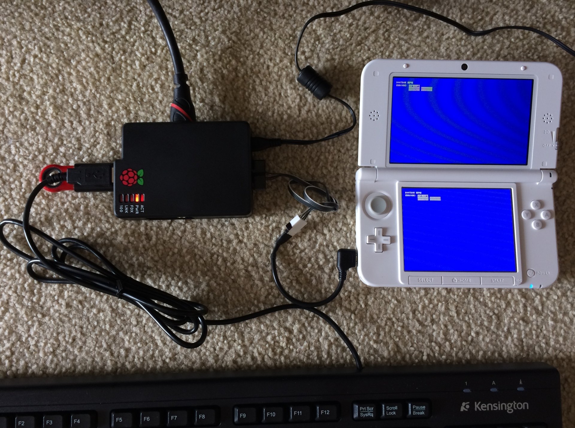

how about turn on your 3ds after you plug the sdmod in raspi.
in rpu_guide txt:
"13) Plug in the SDmod card connected to your 3DS and turn the 3DS on."
here's mine:
testing the RasPi based 3DS unbricker in "Querry only" on my 3ds LL.
thanks, bkifft.
in rpu_guide txt:
here's mine:
thanks, bkifft.

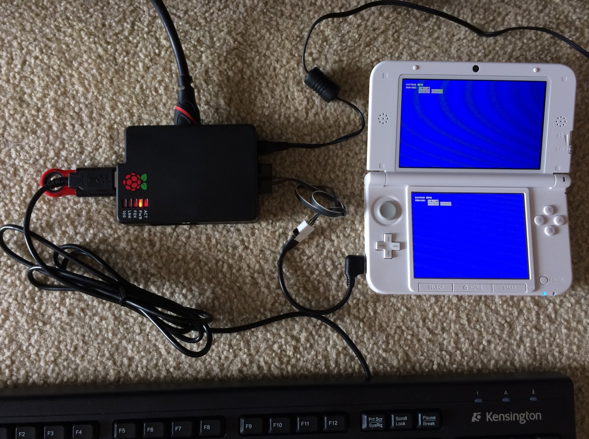

Didn't work!
I switched back to USB cable plugged to my notebook and did like this:
Switched off 3DS (pulled be battery), pluggled the SD cable, plugged the 3DS to Rasp then turned the 3DS on. The blue screen came and then I run the "s" option.
Now I see my CID again but still the first error...
