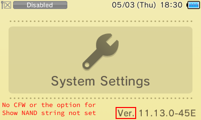

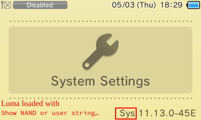

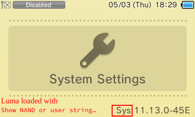

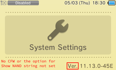

The NAND string option is quite helpful. Open System Settings to verify:
Just to make sure: You have had access to GodMode9, Rosalina Menu and everything before, right?
This is puzzling. How can B9S disappear spontaneously? Are there any more pieces of information you can give?
View attachment 198612 View attachment 198613
Yes they both worked before. Nand string said sys before copying files, now says ver on both SD cards. The only thing i can thing of is i have an old 3ds, (uses full size SD card) but i used a micro SD card inside an adapter for an SD card, not a real full size SD card but that shouldnt matter.
