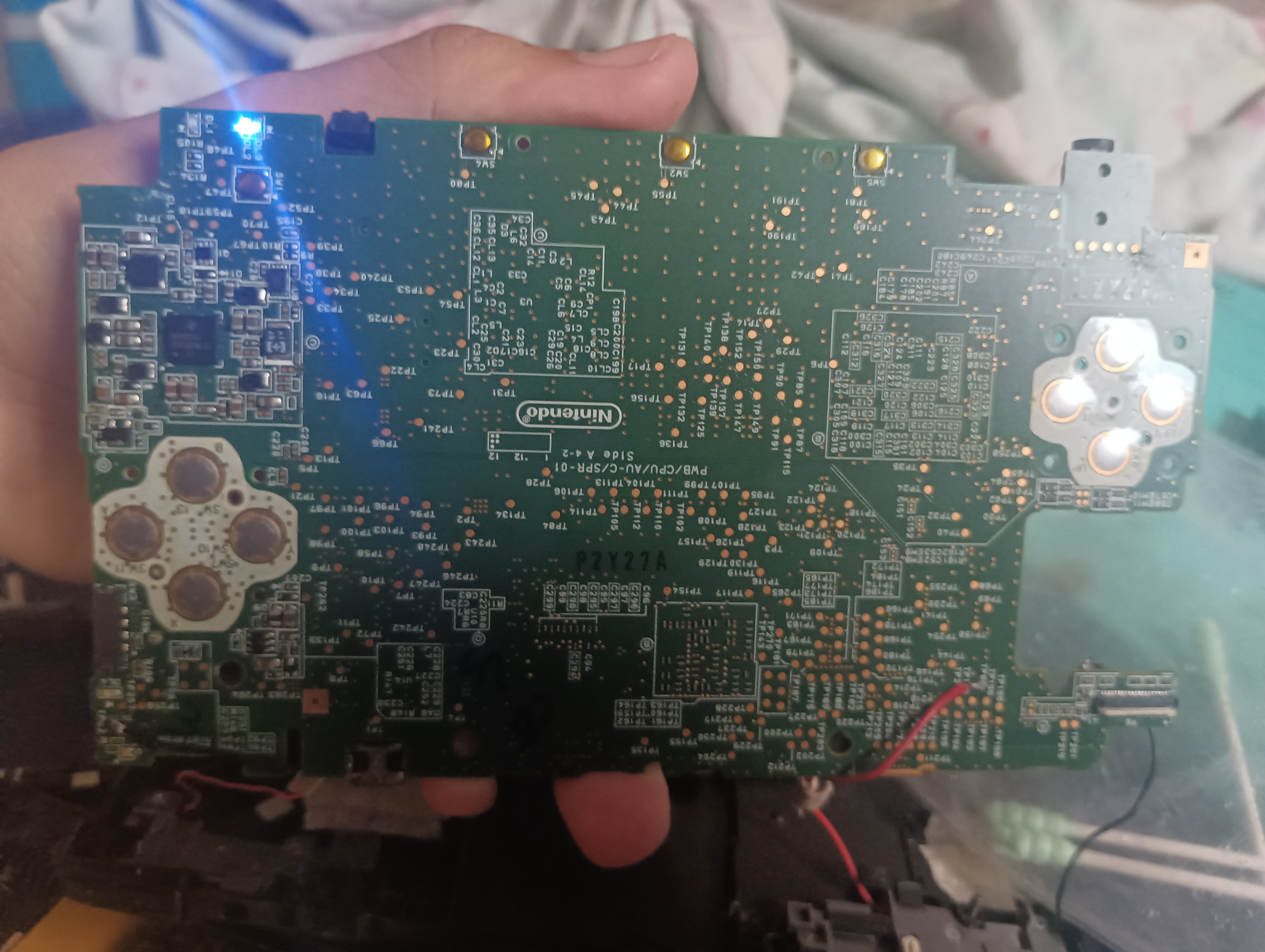

sorry for necroing but I have been going through the same issue except the power stays on but no display even without the ribbon cables and the IR and wifi card detached.
Edit: I found the issue and it's when the socket of any ribbon cable has the solder pins corroded that it causes a short circuit or any of the pins that is biting the ribbon cables are bent and misaligned that it touches other pins, in my case the second image is where i removed the faulty speaker cable socket and now when i power the motherboard on it instantly shuts off, which is normal when the screens and the speaker ribbon cable is not connected.
