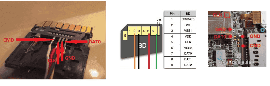

not necessary that CLK still doesn't stick, it popping out and I think that's the main reason, is there a alternative bigger pin for CLK, or a way to boot Gatewey menu with TubeHax, or something, just to fix the Web Browser? I'll go to a friend whose a Pro Solder, if he can do it then no one can.

not necessary that CLK still doesn't stick, it popping out and a think that's the main reason, is there a alternative bigger pin for CLK, or a way to boot Gatewey menu with TubeHax, or something, just to fix the Web Browser? I'll go to a friend whose a Pro Solder, if he can do it then no one can.

with GND is better, and should I solder it to PIN 3, or PIN 6?
Thanks to all of you guys especially you @Xenon Hacks for your help, thanks to this post:
Attached some photos of how I did my hardware mod. Used a four-pin Deans connector, keyed to prevent connecting it in reverse. Blends in almost perfectly with my red 3DS.

I've successfully restored my sysNAND (Web Browser is working:grog:).
