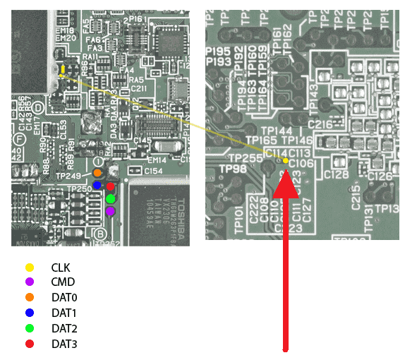

But my win32diskimager doesn't see the partition on my win7.

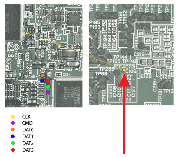

Or the CLK pin is not solder how to DO that properly that pin is so F... small, and the Solder won't stick to it, I spend hours to do that, and still its not right?
Or do I need a USB SD CARD READER, like in the video because I'm using my build in SD reader in my Laptop?
Or do I need to install some drivers?
Will a usb 2.0 work to?Use this it will work http://www.amazon.com/Anker®-Reader-RS-MMC-Support-Warranty/dp/B006T9B6R2? your reader does not have MMC support.
So yes, I'll try get a 3.0 if a can. Thanks I will reply if it worked.
