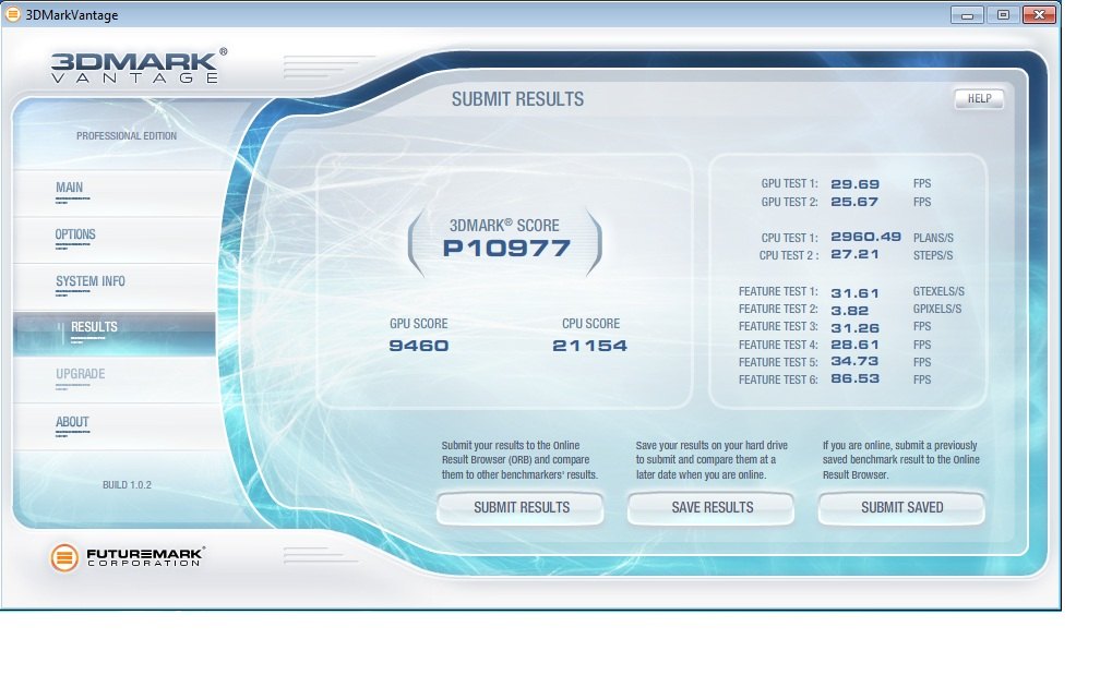

Hi,
So I ran 3DMark Vantage on my new system.
i7 920 overclocked to 3.2GHz, and XFX 5770 GPU
So, I got the score in the attachement. The problem is I dont know whats good and whats bad.
So I guess my question is, is this good?

Those guys have probably pumped their i7's to 4.0ghz and clocked their 5770's. from what i understand, 5770's actually o/c quite well. i see quite a few people asking for programs that clock further than ati overdrive.

What seems is that your graphics card is not that fast the cpu score is on par with the 920.
Check what drivers you have for your card. If you do a driver install make sure you remove the drivers from the control panel option. before installing new drivers.
Btw 3dmartk vantage can give pretty weird scores in some cases. Some people stick a Nvidia card in their system just to ramp up their score for this benchmark (next to the ATI card).

An overclock that gets you from 9460 to 15815 would be neat , post link please

Thanks for the reply guys,
errr.. but what does that mean? any settings I can adjust on my end? is it defective in any way?

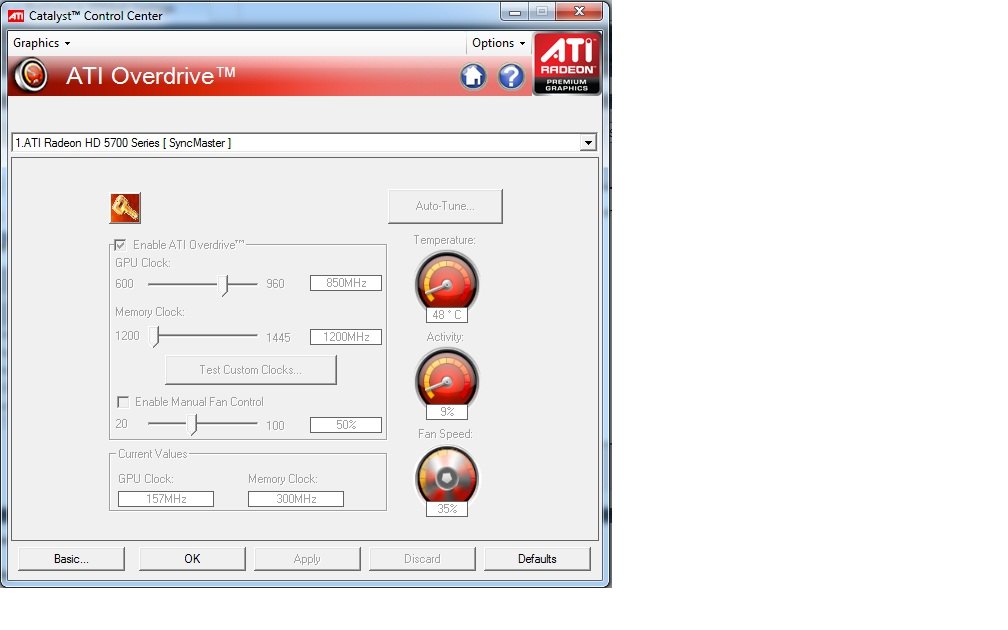

Currently I see this in catalyst control center, all settings are auto (attachment)

Since you are in s creen shot posting mood , download gpu-Z from techpowerup.com and check if there is anything weird regarding your mainboard/pci-e settings used.
Did you by any change have had a Nvidia card in your system before you got the 5770 ?

its possible ati's powerplay is on, goes into 2d mode and lowers core and mem clocks of your card to save power. try a reboot and running it again. happens to me from time to time when i switch games.

Maybe change some settings in catalyst control center, make everything run on performance and disable catalyst AI. If there is a powersaving mode disable it.
And check some reviews of your card. If you have nearly identical scores on certain games which are gfx based that would be a good indication that everything is fine it is just 3dmarks vantage that is wrong.

I just tried to adjust some settings and I got bsod lol..
I think I'll just keep it as it is, I'm planning on getting a fermi anyways this card is just temporary.
I checked a few reviews and I *think* the average is around 95xx for GPU, so I guess I'm where I'm supposed to be..
