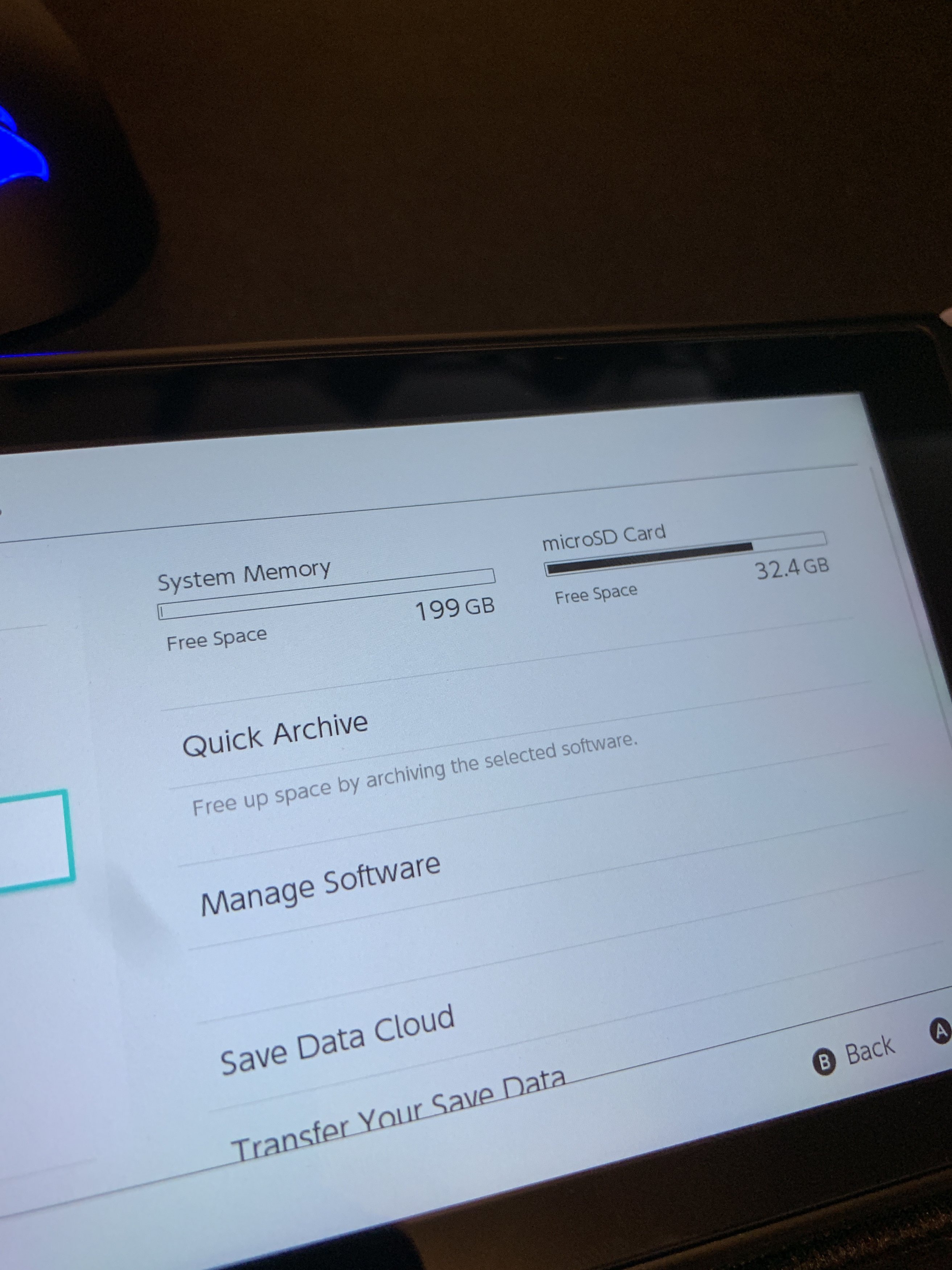

To give everyone an update:
Right now I'm still working on getting my nand backup restored to the new chip itself. Having tons of trouble at the moment. I've found that you'll have to use gdisk to back up the switch's partition lay out and restore it on the new emmc before the hekate can restore things to it... and I can't restore my boot0/1 backups for some reason. I'll play around with somethings prior to getting the initial setup done. I'll see if the switch and hekate can see a Fat32 partition that's made on the EMMC itself. If it works you would still need to boot into RCM, but you'd have everything running from the EMMC itself.
Lots of trial and error, but its doable. I wish I had an emmc writer. My switch is currently taken apart. I've been switching emmc modules back and forth lol.
Edit:
So far so good! Going to use the 30gb that is remaining for either android or linux.
