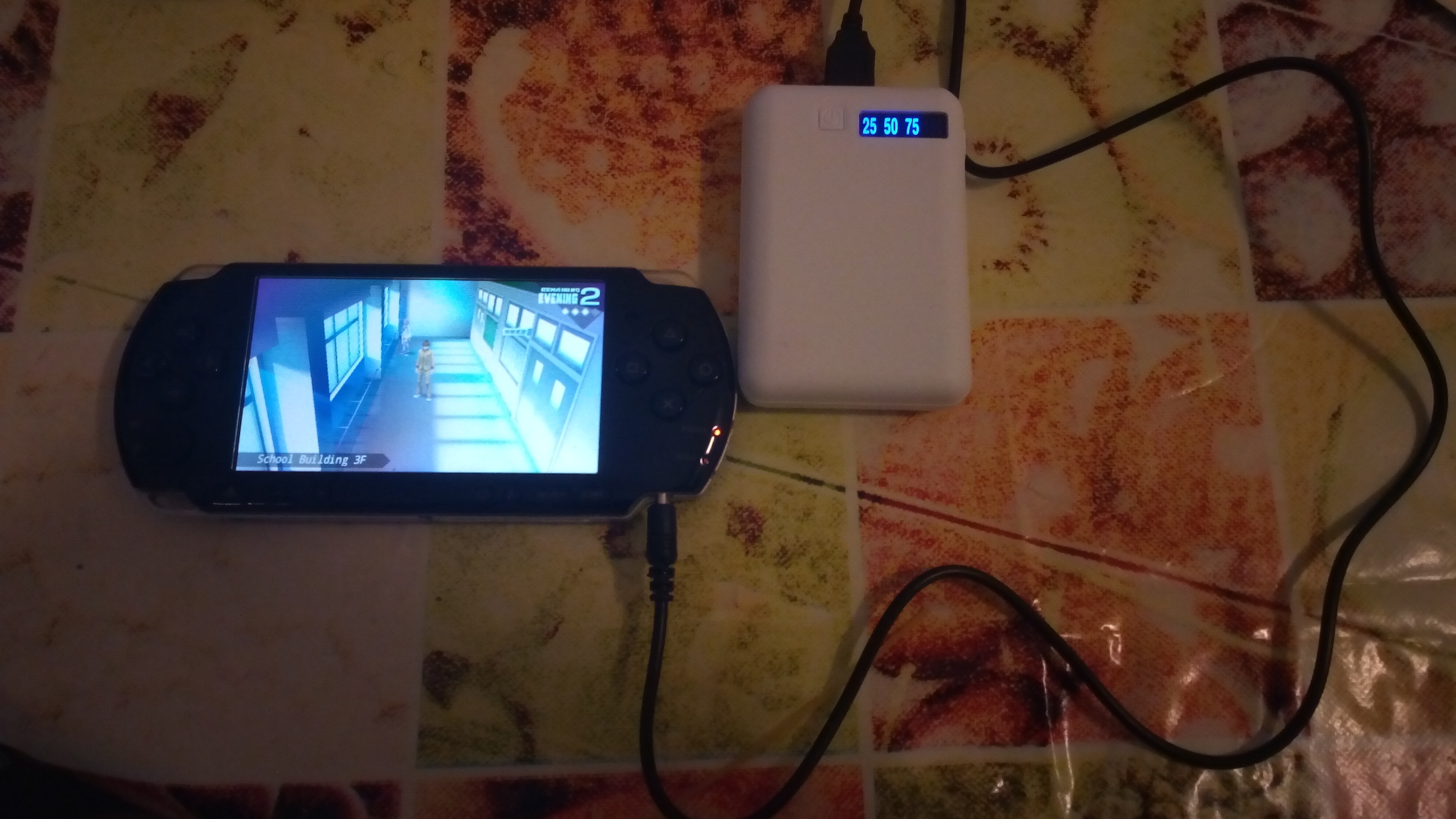

Okay lad, as a New Year's greeting, I'll tell you my secret: but don't tell anyone, mind you! 🤫

What are that device and cable?
It is a simple Power Bank of 20000 mah with 3 usb outputs, to which I can connect my PSP/DS Lite/DSi at the same time. The cable is the USB to PSP type.
