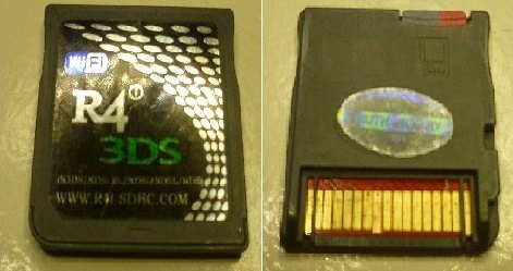

Hello guys i was wondering if anyone have the back up for this card,
i know that in the first page there a similar photo of this card but is RTS
mines says Wifi R4i V 5.0 3ds and i am afraid to use that back up.
you can try other backups they will not brick the card,
so try ones to ssee if it will work
@Hunter
Hahahahaha i think i just found my WIFI R4i V5.0 Backup.bin
i totally thought i lost it i look in the ntrboot folder and i was
like wait a minute is this the one......please tell me this is the backup.bin
for my WIFI R4i v5.0 3DS card..
