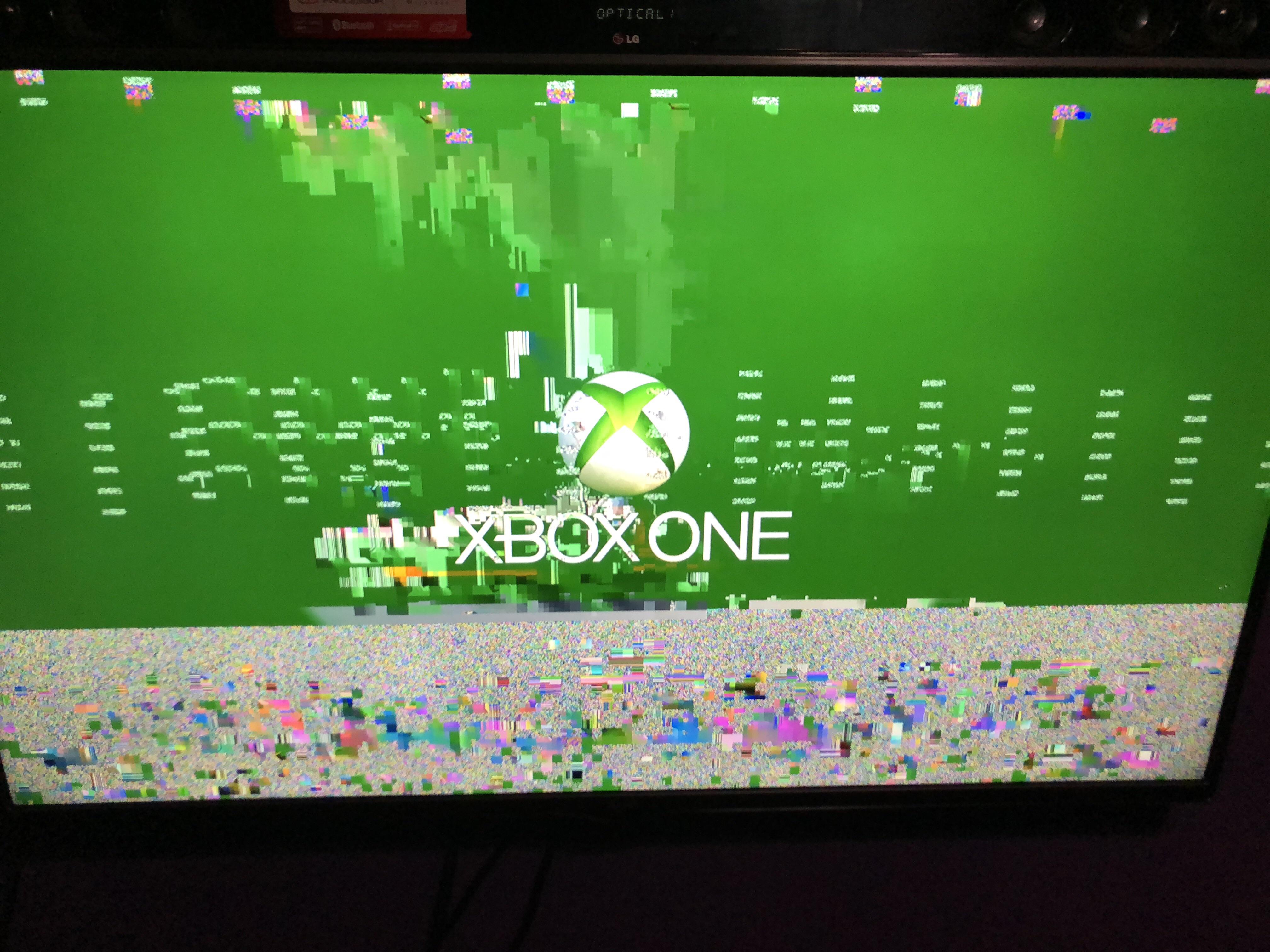

One other thing, that I should mention here, is that the green Xbox splash image, at the startup, is corrupted.
Even if I replace the animation file on the HDD, it is still corrupted. Like bad graphics chip corrupted.
