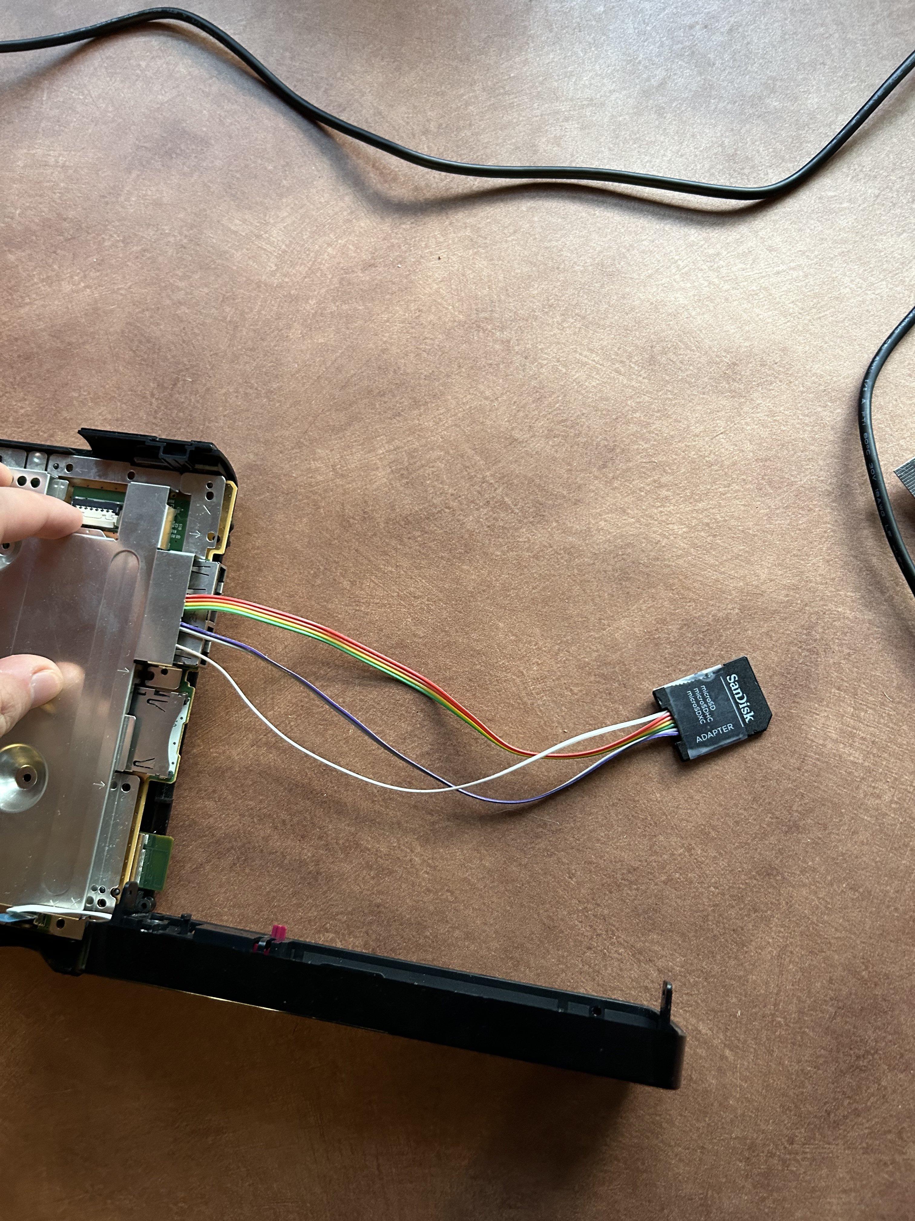

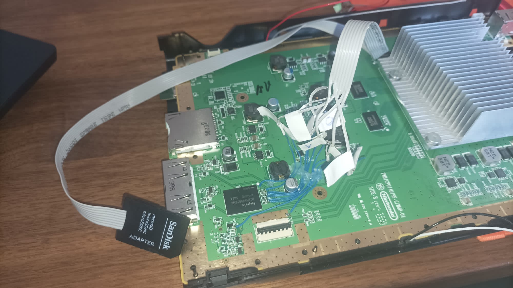

Mine is definitely shorter than that. I'll send a picture later as well as a measurement. Is there an estimate as to how long they can be? Obviously the shorter the better, and it would be great if my issue was just that the wires are too long.
I measured the length and it’s about 24 cm long. Continuity also indicates there are no shorts and the connections are solid.

I would make the cables shorter and also keep them closer together. Also you don't need that metal shield for now. I usally just turn the fan around, so it blow over the heatsink, when I have a disassebled wii U

I would try shorter wires and Linux first and see if something comes up in lsblk or at least dmesg.
Also keep the signal and GND wires close together. Also you could try to improve the GND connection by adding a second GND wire and get it somewhere from the Wii u Mainboard directly close to the emmc.
Also try using the laptop on battery without charger
Also I used a very thin wire (just for the solder to flow on) where the NAND-AID is connected to the emmc clk pad to make sure the NAND-AID really connects to the pad, because I had a little of a gap there.
Can you measure ~something~ (resistance, capacitance, diodes) between the clk and the GND?

I don't see anything that would indicate your eMMC was detected. You can run dmesg -w and see if something comes up, when you plug in the adapter.
You can also have a look at lsblk.
But at this point I would suggest defusing it. Then we can see the system messages at boot and see where it fails. Then we know if it is a hardware problem or if the Image on the SD is bad.
I'm working on the CLK connection right now just to be absolutely sure that isn't the issue. You mentioned using a a very thin wire to make the connection. I have some thin magnet wire. Do you leave the wire behind (as in the wire is the connection), or do you just use it to make solder flow? Your description was a little unclear to me.
Also, de_fuse is still in development correct?
I went back and redid the CLK connection. It looks fine with no wire, yet I still cannot read anything using my computer. I never did add an additional ground, but it's looking like I might just have to wait for de_fuse to be ready.
Does anyone have a Wii U on hand that they could measure something between clk and ground just so I can check that connection?
I measure 4,6MOhm or in diode mode 0,8V
Also defuse is ready. At least to the point that you can install it and see what's going on and if the sdcard is detected correctly. The plugin for the mlc rebuild will be released in the next days. I can also send you the pre release if you have installed defuse first.
