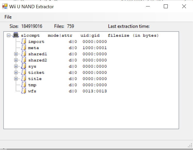

the mlc is internal storage for the wii u. saves are probably in the slcmpt for the vwii. if you have saves from savemanager gx or normal wii save transfers using usb (data.bin files), then you can recover them.
what, there may be a way to get them, but I don't know for sure or how exactly. I think you can load the slcmpt with the otp.bin on the pc with nand extractor.

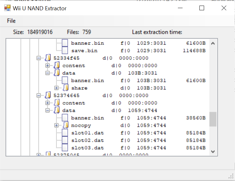

here's mine (I don't know where saves are located in here though):
this may be them:
I think they're decompressed, so you could theoretically inject them with savemanager gx. I'd test with one game.
