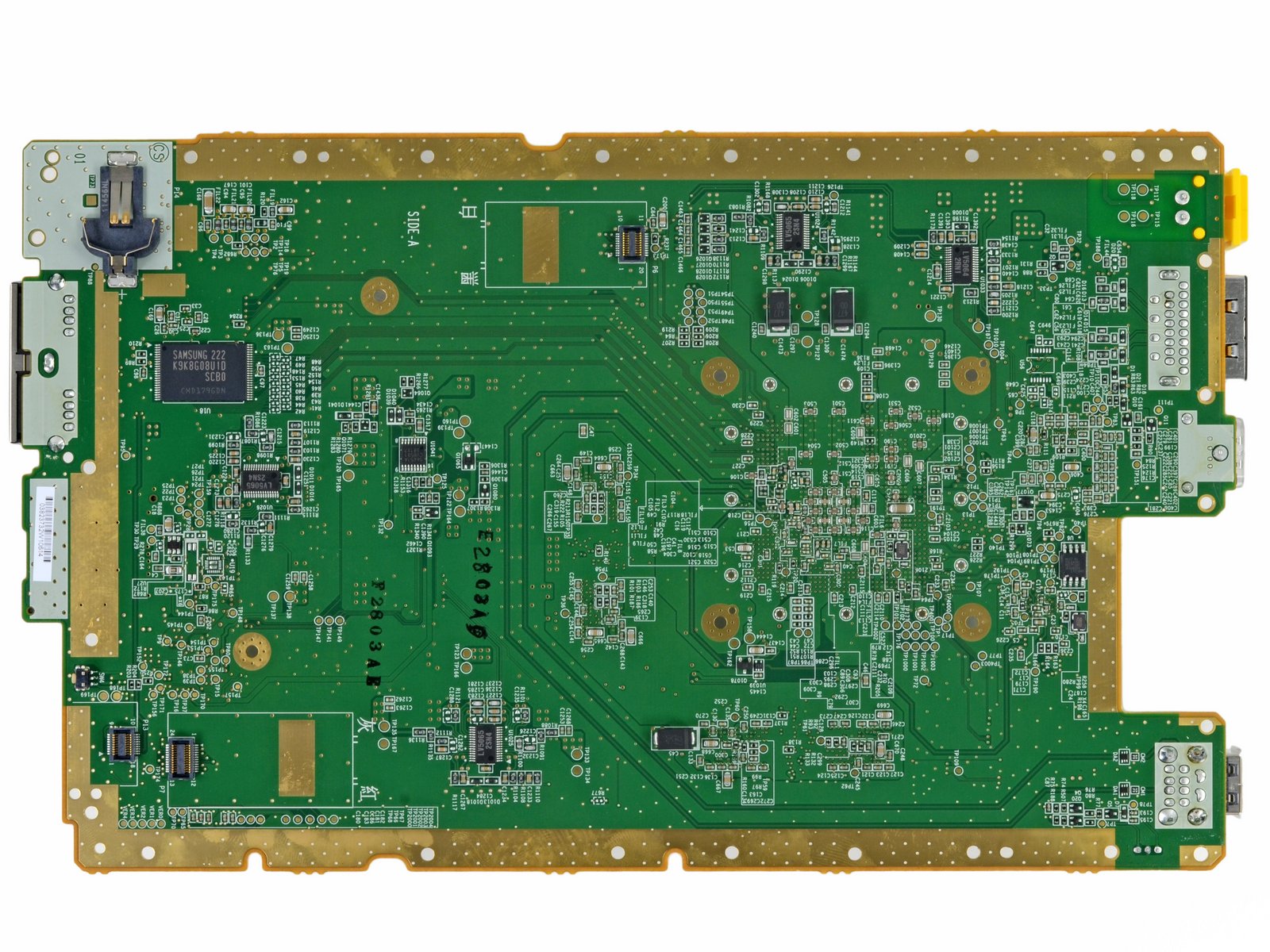

Just because there's only 1GB total there doesn't mean it's not part of a larger chip.
No, I meant the numbers on the chips themselves indicated they were 1GB nand flash. One of the other storage chips is an emmc(either 8GB or 32GB) but there are still other memory chip(s) like the serial eeprom for the DRH firmware etc.

The Wii U has an 8GiB or 32GiB eMMC chip used for applications and user data. It also has dual NAND banks, 512MiB each, which are used for vWii mode and the Wii U OS, respectively.
Gotcha. So you'd need something like an infectus to dump it since it's just a plain old NAND chip.

Yeah, I believe it's the same type of NAND chip used on the Wii. Obviously, any NAND dumps you make would be encrypted but it may be possible to downgrade a Wii U by only reflashing the OS NAND chip and not the eMMC.

I mean, based on Samsung's info, the white wii u has a 8GB (64Gb) chip. What's the misinformation you guys are talking about?
Step 12 Samsung K9K8G08U1D 4 Gb (512 MB) NAND Flash from
https://www.ifixit.com/Teardown/Nintendo+Wii+U+Teardown/11796
this is incorrectly reported
(back of wiiu motherboard) https://d3nevzfk7ii3be.cloudfront.net/igi/DBOR5ukVFarbvSq6.huge
Just notice Marionumber1 cleaned up wiiubrew back in April.
source http://wiiubrew.org/w/index.php?title=Wii_U/console&diff=prev&oldid=923
