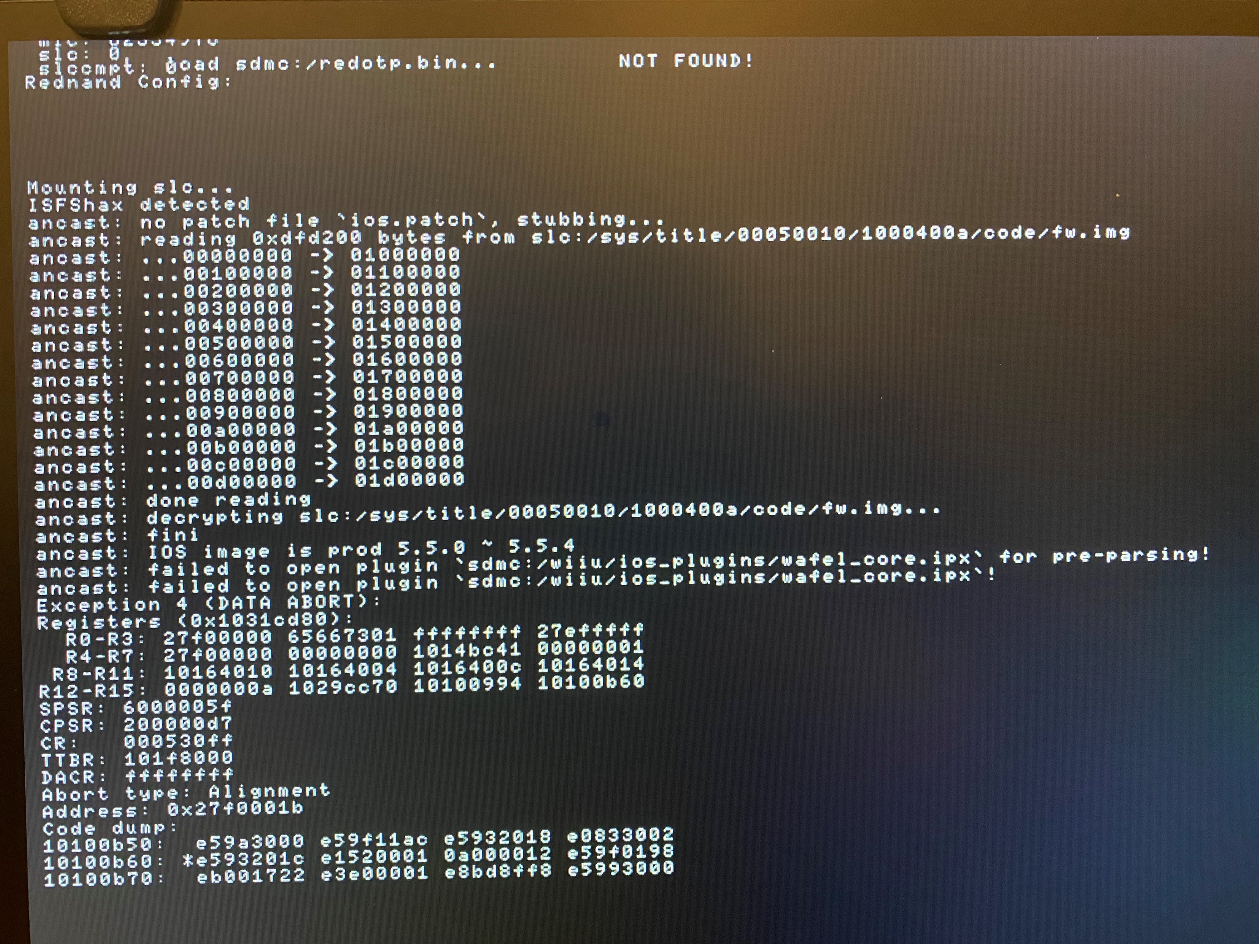

Hi, I wanted some advice on how to repair this console.
It hasn't turned on recently and I don't think I've made any backups.
From what I've read here on the forum I think eMMC is done.
Right now I'm trying to create a backup with UDPIH the problem is that the screen is completely white and I can't see the menu.
I was able to download some system logs.
Is there anything I can do to be able to see the menu?

Yes, that's bad eMMC.
First of all install ISFShax. From there you can descide if you want to go the redNAND or MLC2SD route.
You don't need a mlc backup
No redNAND is without soldering anything.
NAND-AID is an interposer like MLC2SD, that you would need to solder. If you want to get that route, just ask @V10lator for one
Oh ok thanks then I'll try the """quick way""" via rednand and see if I can recover this old console.
