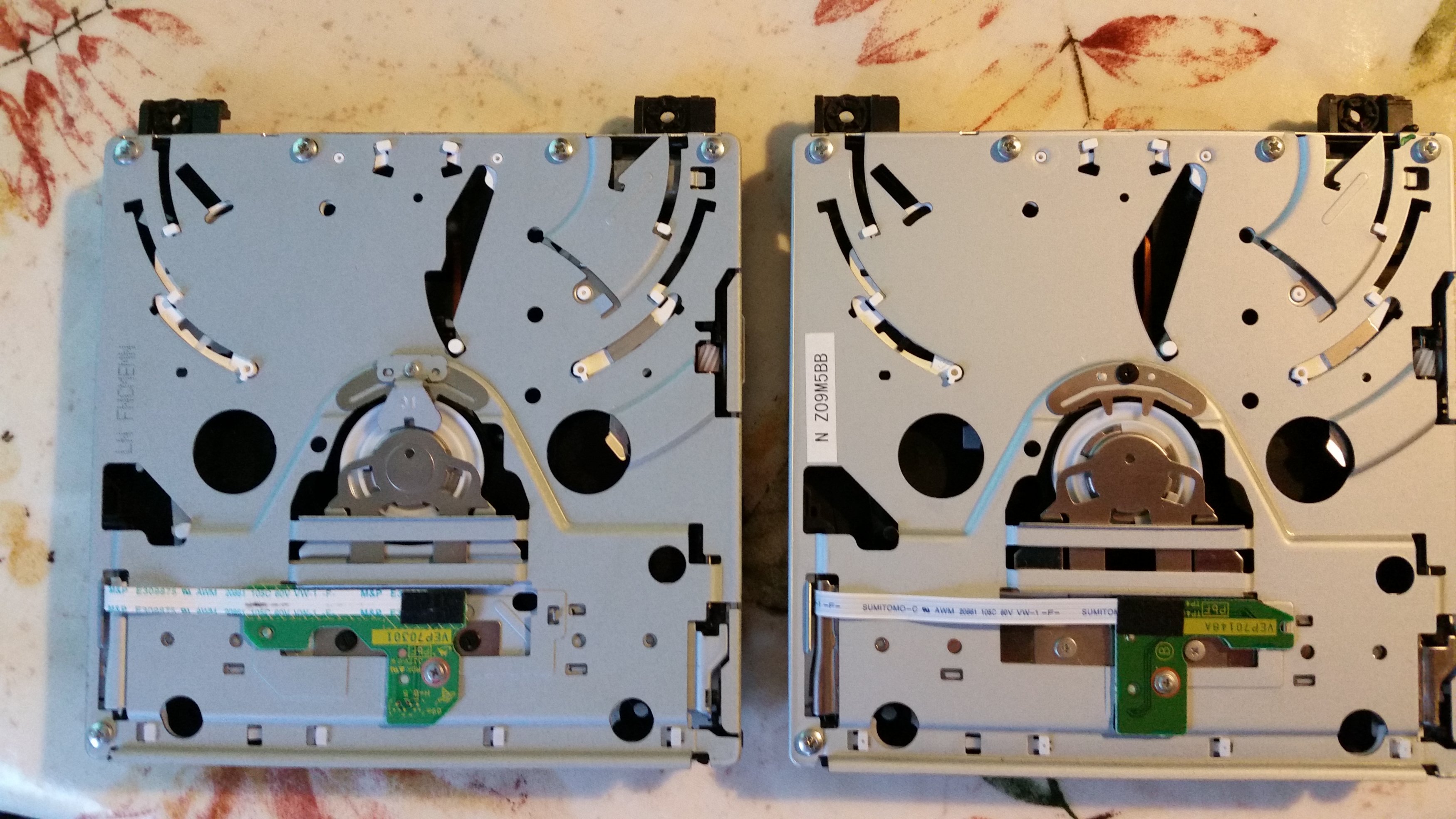

I've changed the Wii drive on my Wii a few years ago on my launch Wii after the laser started to fail (initially dual layer discs stopped, then read errors became frequent on other discs) and it's not difficult to replace the drive. But as Leseratte said watch out for drives that don't support GC discs. I learned that the hard way and sent it back and replaced the laser instead; a bit more involved but successful and still works with GC discs. The drive is quite easy to get at.
The one on the left does not read GC discs, the one on the right does (and swapping the lids of the drives over doesn't work, I tried that) the metal tab on the long top hole of the left drive makes the drive reject 8cm discs, and even without the tab the discs physically mount into the drive but still won't read, as if there's hardware missing or different drive firmware to read them
